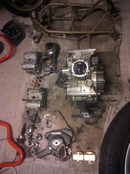

  6. Feeling a bit more inspired after Motorcycle Live yesterday - Day off today and the girls are at work / nursery so I may have a chance to have a poke around the engines :upyeah:

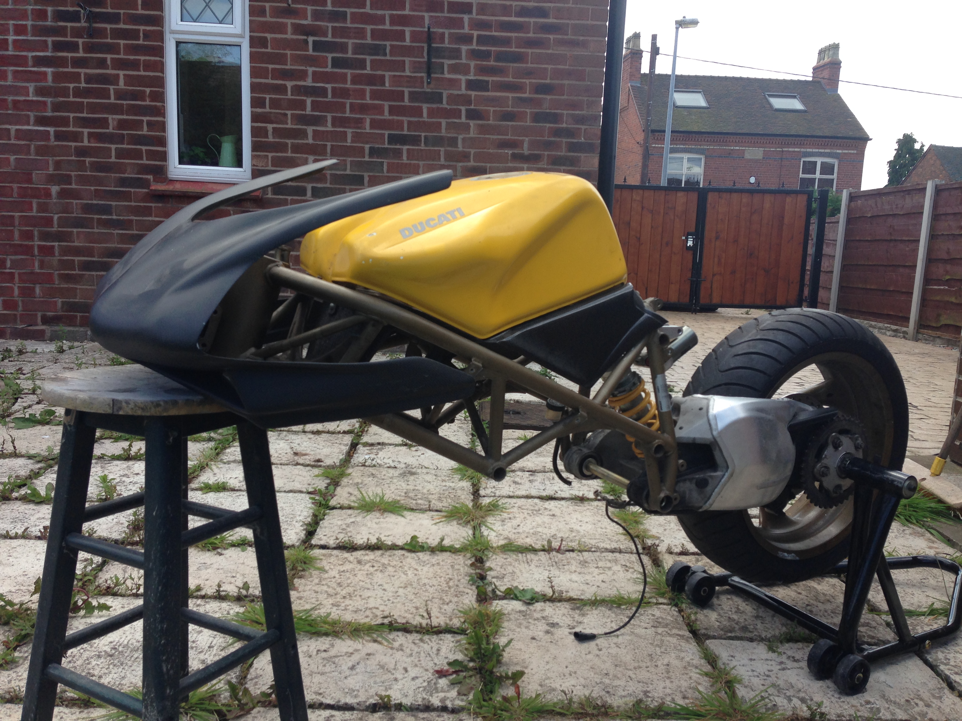

  12. Not really had much chance to do anything over winter, but this is how she sits at the moment...
    Updates to follow soon - I plan on being a bit more pro-active over the next few months!! I just hope I remember how to piece it all together :upyeah:

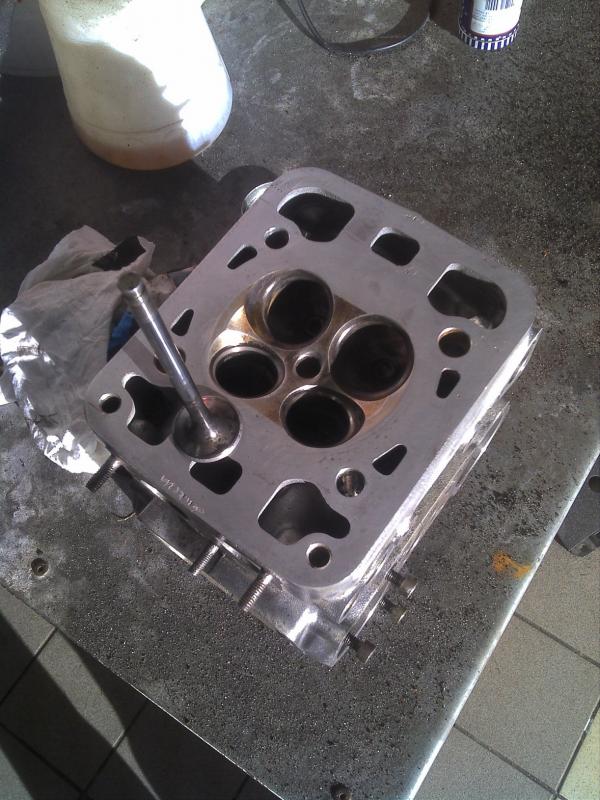

  13. Heads and Valves being cleaned up and re-cut...
    Finally some progress - may actually see her running this year!

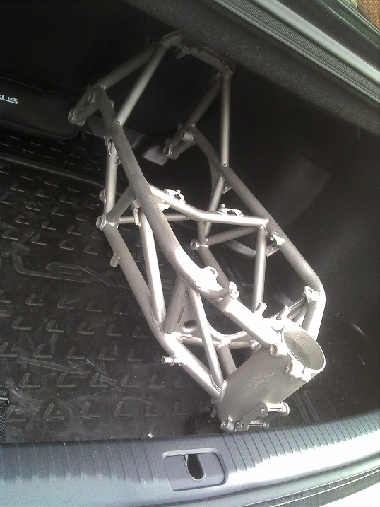

  15. Progress is very slow - Been a very busy half year so far so she has sat in bits! Although I did get half an hour free not so long ago to mock her up with the swingarm... (Check out my custom bench front suspension ;))
    And then picked up the frame today after blasting so this is now ready for paint!

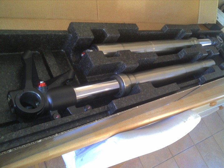

  16. Some more bits have landed...

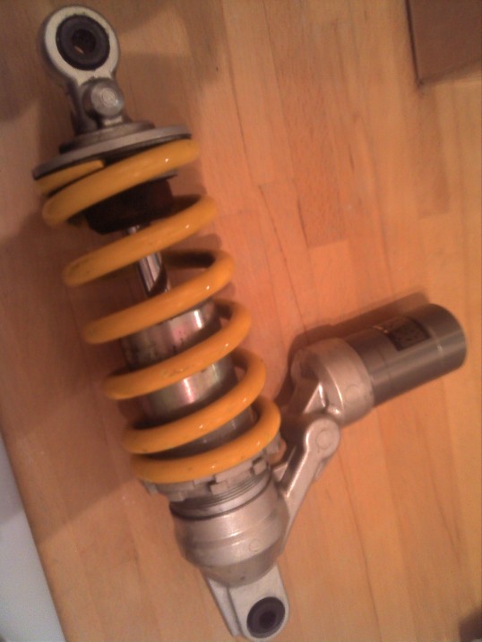

    Budget wont stretch to Ohlins but these should be an improvement over the original Showa's and will allow me to fit some better brakes!! Also got some lightweight cam pulleys - I might book a few days off work to start getting her put back together :)

  19. How's the alignment for the shock and ride height adj?
  20. I hadn't mocked it up with the ride height adjuster to be fair - A block of wood wedged between the shock and rocker kept it up :upyeah:

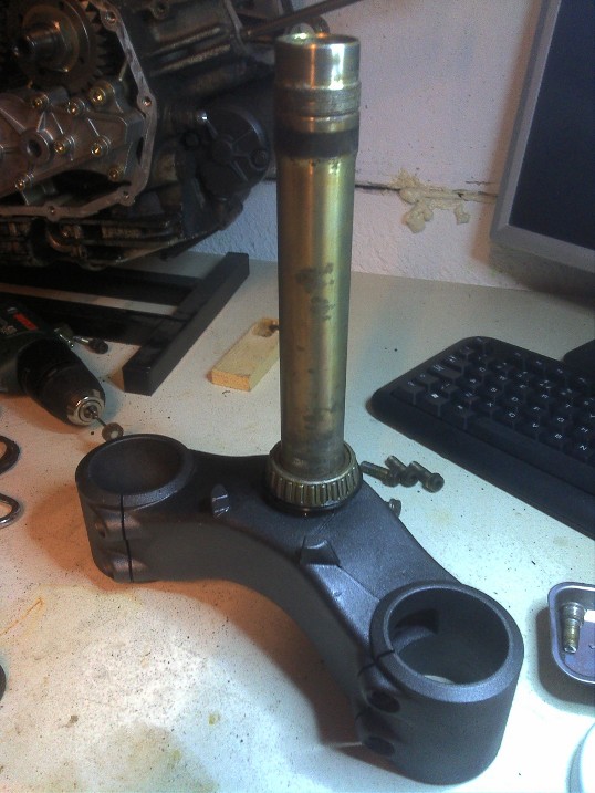

    In readiness of the frame being back from paint I have painted the bottom yoke and fitted some new tapered steering bearings - not as difficult to do as I was expecting after having read some horror stories!

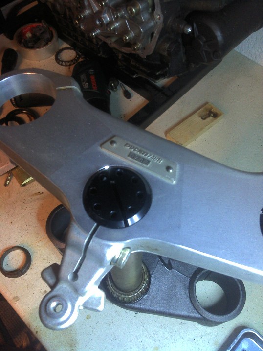

    Also wanted to try on the Top yoke :upyeah:
