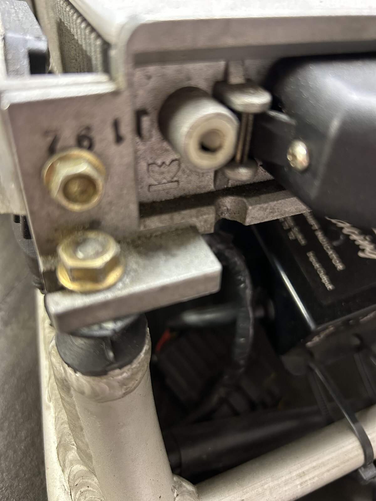

  1. Is this good or bad?
  2. it's fine, just carefully remove "dust" plug. it's what you do after that that could result in bad - use a wooden or (preferably) plastic trimmer straight-bladed screwdriver and make sure you are very sensitive/careful in determining when you've come to a stop/full adjustment in either clockwise or ant-clock direction.

  4. Sorry for the dumb Question but What does adjusting this actually do.
  5. Must be one of you guys has an idea of what it does ?
  6. Try the tech help section mate or it might get missed here.
  7. @Davyd
    What is your question exactly, what do you mean by « adjusting this »? Can’t really see on that pic of your (P8?) ecu.
  8. In the video Rich points to the little white plug on ecu and remarks about it. So I wondered what does he do with it. And in relation to what,, if you get me drift.

  10. It's a trim setting. In layman's speak if you twist it you move the whole fueling map; up, or down. It's definitely not something to mess with unless you know what you're doing. Most running issues are sorted elsewhere
  11. Ok thanks for the answers guys. And the link guillaume I will have a read if only to help me understand.But it’s probably best left to the experts not me.
