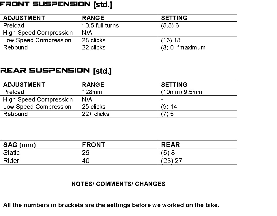

  9. I've not had anything changed on mine but I did have the suspension setup a month after I got mine (1199 Standard).. (I fluctuate between 12.5 - 13 stone) and the handling has been transformed from bucking bronco on our shitty streets to a much smoother rocketship... was done by Paul Adams at racelab, top bloke and knows his onions, in his opinion the rear shocks are decent and don't need to be replaced (unless you want to or are properly racing and the front could ideally do with a little more range and if you were just using it as a trackbike or racing you'd probably look at doing the springs but for most (note, not all) road riders they should be ok when setup.
    Happy to post up the settings if anyone is interested.
  10. Yep, please do. Interested to know if you're in the flat or progressive linkage option too.
    It's funny how different companies give out such different advice.
  11. its as personal as our opinions Matt! Remember when 'progressive' was best for road? Until you tried it!
  12. Well kinda, although you'd think people in the same line of work would apply some science and therefore you'd maybe get (some) consistent answers? It doesn't really matter, I've found an excuse and justified to myself to spend some money on some shiny new bits :upyeah:
    My bike has always been in progressive btw, I've not changed it. I'll be switching it to flat though if that's what Nitron recommend but I've not asked them that yet.
  13. I'm in no position to comment on other companies as this is the first bike I've ever had it setup on (crazy I know) but the jap bikes I've had never seemed as hard as this, my old 999s was pretty compliant too... all I know is that what Paul did transformed it for me.. best £100 I've ever spend on a bike. Here's the data.... incidentally I'm not sure on F or P, we didn't touch what it was set on originally.will check and come back to you tomorrow on that
  14. Well that confirms something is wrong with my forks! You're getting 40mm of rider sag with 6 turns of preload whereas I can barely get mine to budge with preload wound fully out. Thanks a lot for posting this sheet, I'm going to actually print it off and go out to the garage now and compare mine to yours :upyeah:
    Edit - I forgot we live in 2015 and I can just take my phone out to the garage. The trees are safe for another day...
