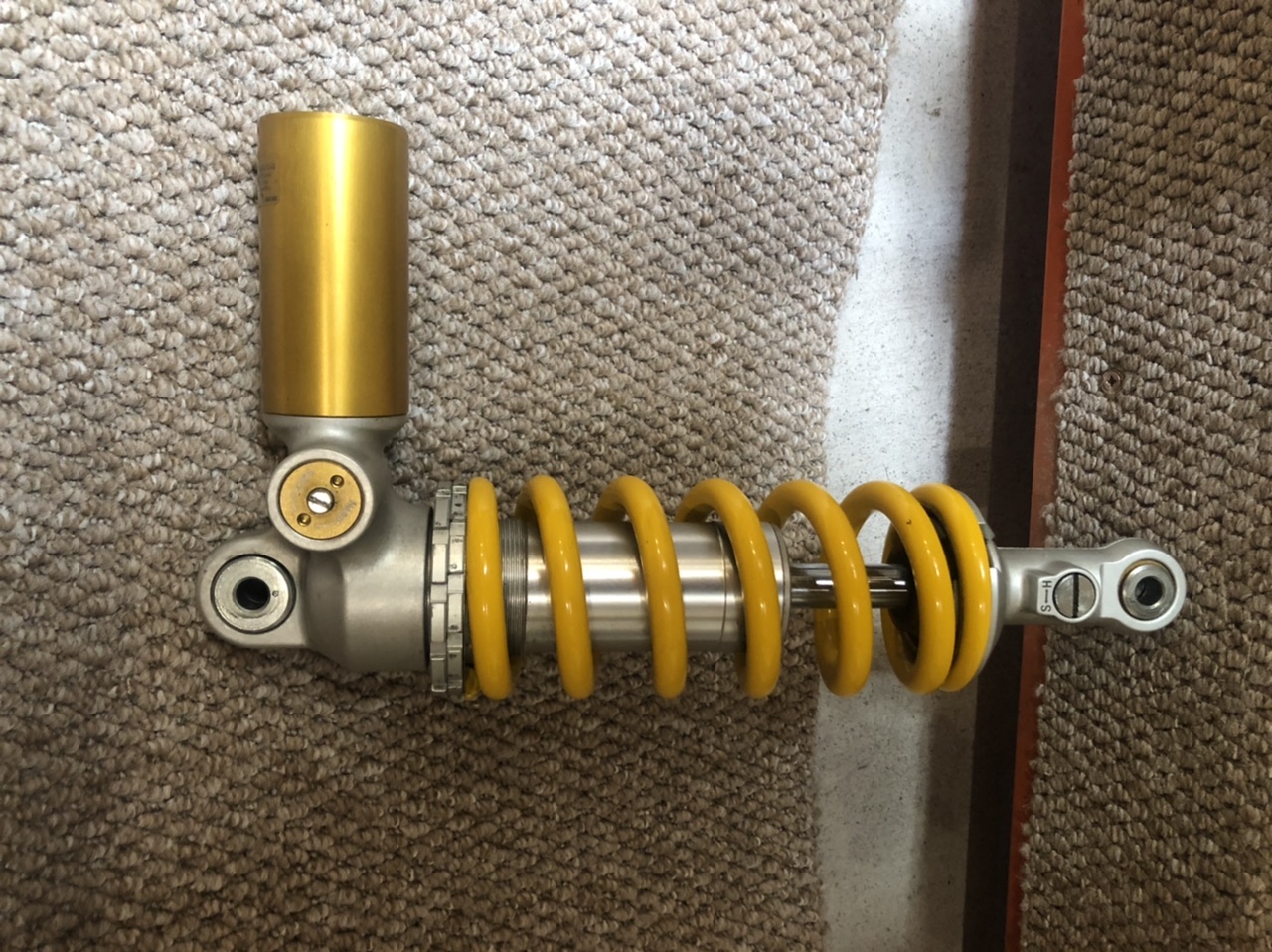

  14. Ok, so the shock arrived, seems to have a 10.5 spring fitted.
    21141 - 36/105 L5118
    Going by the Ducati Omaha chart posted here if i put that in my base it'll be like having a welded shock!! lol
    Really need to find this Sachs spring rate now before fitting the Ohlins

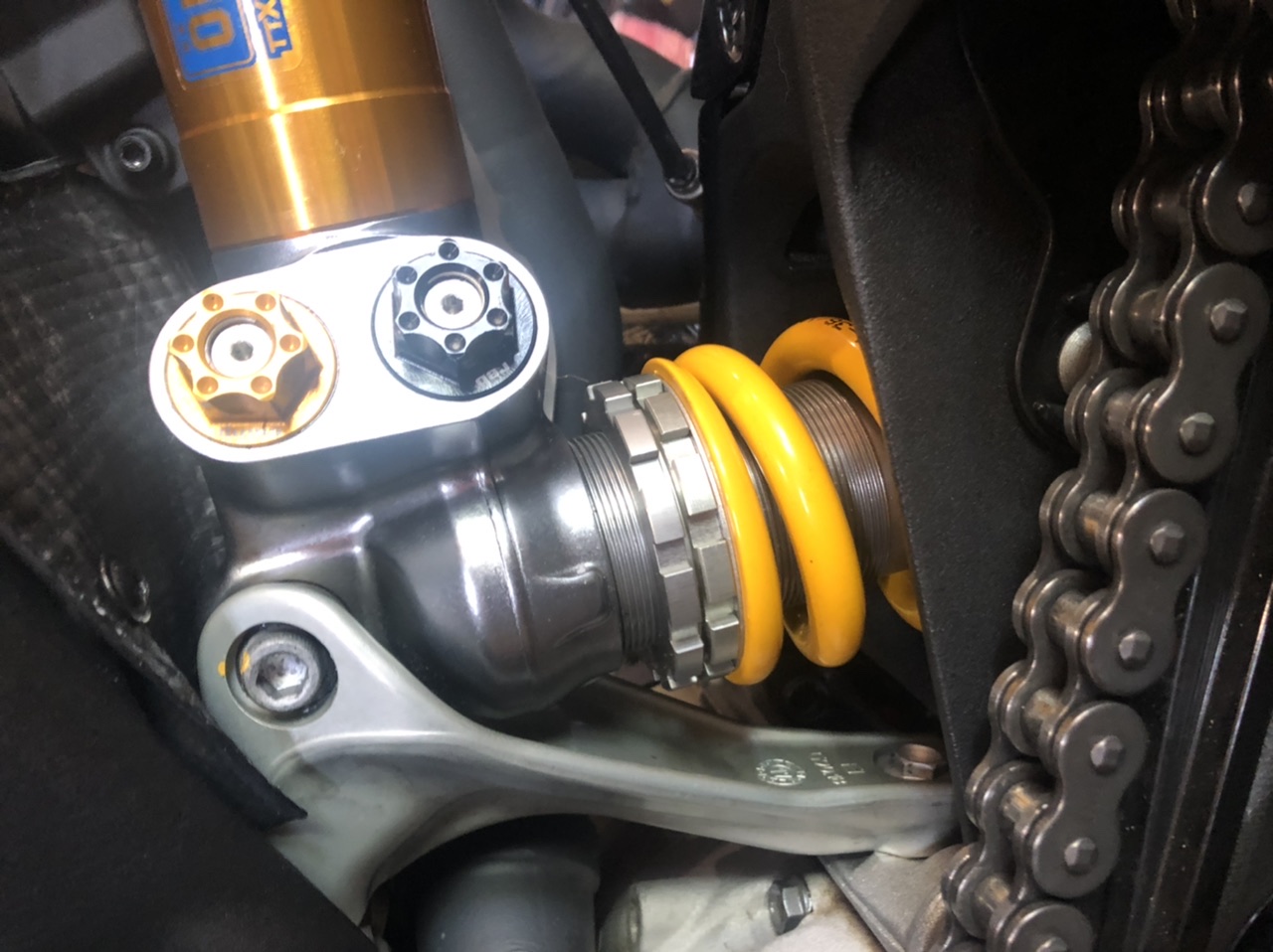

  20. Quick update for anyone that’s interested.
    Mist be the damping in the Sachs shock making most of the difference, note the preload rings in the pic;
    Sachs with OE 95 spring - 13mm static sag
    Öhlins with 105 spring - 15mm static sag
    (Sorry no idea why the pics are rotated, posting from my phone)
