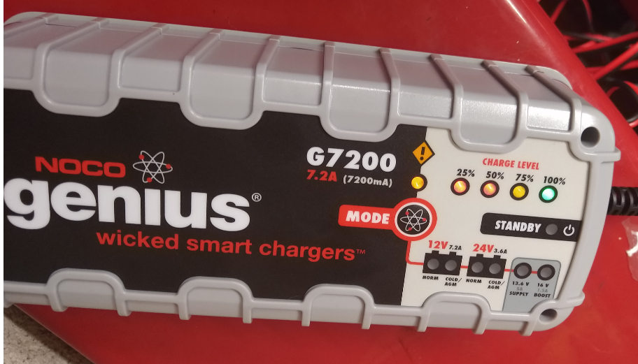

  5. So, I bought a Noco genius smart charger. It appears to be useless. I emailed customer support but they are yet to reply. When I connect it to my battery, it goes to 12v for a minute and then all of the lights start flashing - telling me nothing. It looks as though I've wasted my money. But some of you have used them successfully?
    The battery is still in my ST2. Should I take it out?

  10. No. I am more inclined to believe that the device is useless. When I connect it, he 12v light comes on for about 5 secs and then I get all the lights flashing, as in the pic.
    I think that I should of just bought a new battery. That would of been cheaper and would of worked!

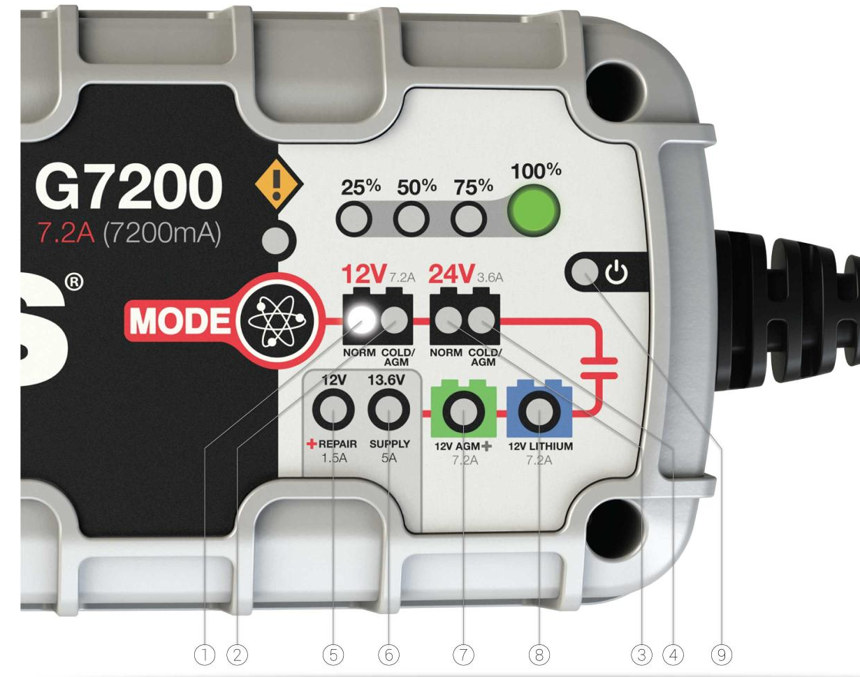

  15. Not sure which version you have, but that one doesn't seem to have the repair mode, or it might be a knock/off, or older version. The one I have has a dedicated repair mode. Screenshot 2020-03-11 at 16.03.15.png
  16. Just checked. Whoever sold it to you, sold you a version 1 product, not version 2, so not sure if it has the repair function, and definitely does't have the Lithium battery support.

  17. Yes you are right. It is not version 2 but their barcode that they tell you to scan on the user guide takes you to the version 2 manual! What a load of ....

    Apparently, although I have the mark one product it should still do the business - but only if there is at least 7 volts there to start with. Mine has got about 6. All is not lost as I can still use it like an Optimate if I get a new battery - or if I can get above 7 volts then the device should try to recover the battery.
