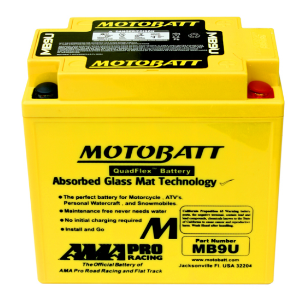

  4. Well, I put a Motobatt one on my Desmo about 3 years ago. It's constantly plugged into an optimate, but it looks to have failed over the last few days as the charger is now blinking red more than the usual green. There is the constant draw of a tracking device, but this hasn't affected other bikes plugged into Optimates. :( this is the 1st battery failure I've had in years.
    Think I'll put a Yuasa on it.

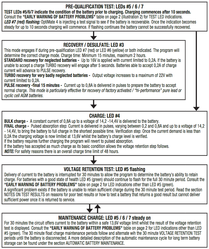

  14. So @Pete1950 I'm interested (as an electronics engineer) how you'd go about this?
    What makes you think an Optimate or any other battery tender would hide this?
  15. Awwww, you've humoured our forum self appointed expert, you silly billy. I was going to reply along the lines of the Optimate having an early warning function of battery failure built in, but couldn't be bothered to engage him. :rolleyes:
    God damn you @AirCon :mad:
