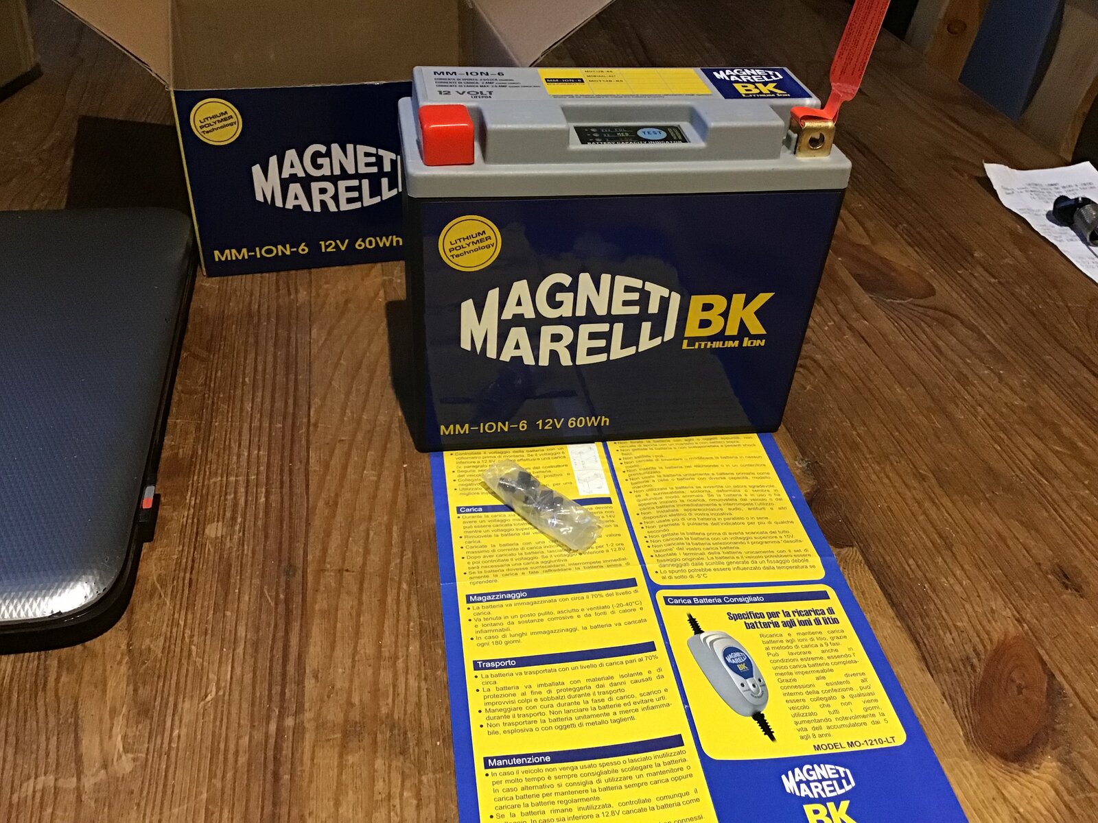

    Magneti Marelli now do a range of Lithium Ion batteries specific to Ducati, this one for my 998. Chargers also!
    • Useful Useful x 3
  10. And do you get stickers, I mean it’s worth getting one of those just to have a Magneti Marelli sticker on the fairing!
    (As always people, ensure you reg rec isn’t supplying more than 14.5 volts before going Lithium).

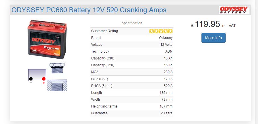

  12. I used an "Odyssey" Extreme motorbike battery on my 900SS, gives a bit more cranking power but fairly pricey. Spec is great and last longer between charges than a 'regular' battery. Originally from the USA but I think they're now available from 'Tanya' batteries in the UK (online shop).
  13. They are Glass Matt Gel Batteries made in the USA, UK and France - but Yuasa also do a higher cranking range now too.
  14. Thanks for the info 'Exige': but just to finish off what I wrote, pls see this attachment (£120!)
