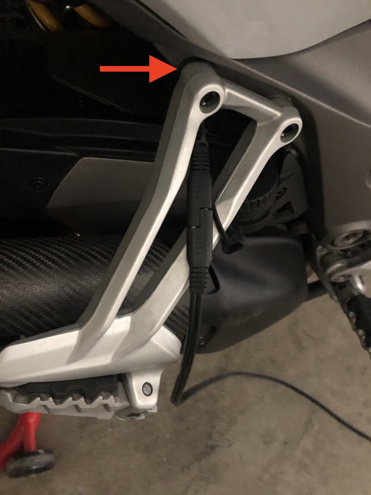

  2. battery tender power plug on right side, threaded down to pillion foot peg bracket, and zip tied in place (arrow points to zip tie). IMG_6274.jpg
  3. I have a similar cable if not identical and similarly zip-tied.
    However, I have it on the clutch side for a reason namely: my heated gear controller is clipped to my belt on the left side which allows me to adjust-it without taking my hand off the throttle.
  4. nice.
    i use a power cable plugged into the tank bag power strip to power up my heated vest, so i have routed the battery tender "pig-tail" out the right side of the 1260s, so i can plug in the battery tender when she is in the garage.
