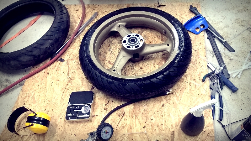

  7. Would be nice if some of you could show your home tyre-change kit in images.

  10. Many of those are too small to fit a 17" wheel properly. I tried 2 different models and the support rings were a smaller diameter than the rim so the wheel is supported on the spokes, this may work OK but the potential to damage the wheel is always there so I sent them back.
    I ended up finding one that is not only bigger and supports both a 17" & 18" wheel properly but that also has an add-on extra rim to suit even larger (21") wheels. To add to the protection I fitted foam pipe-insulation to the ring to cushion the wheel.
