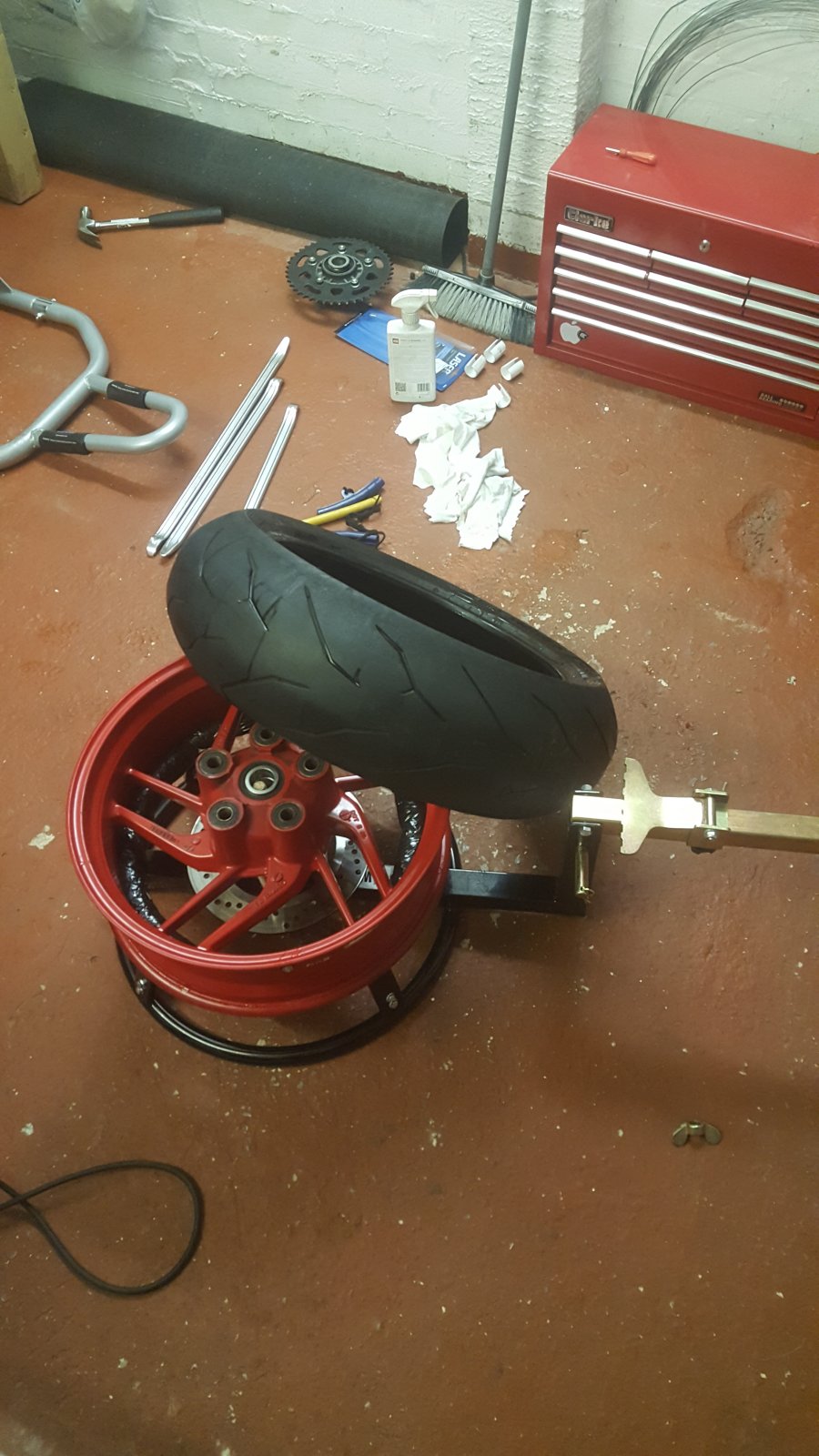

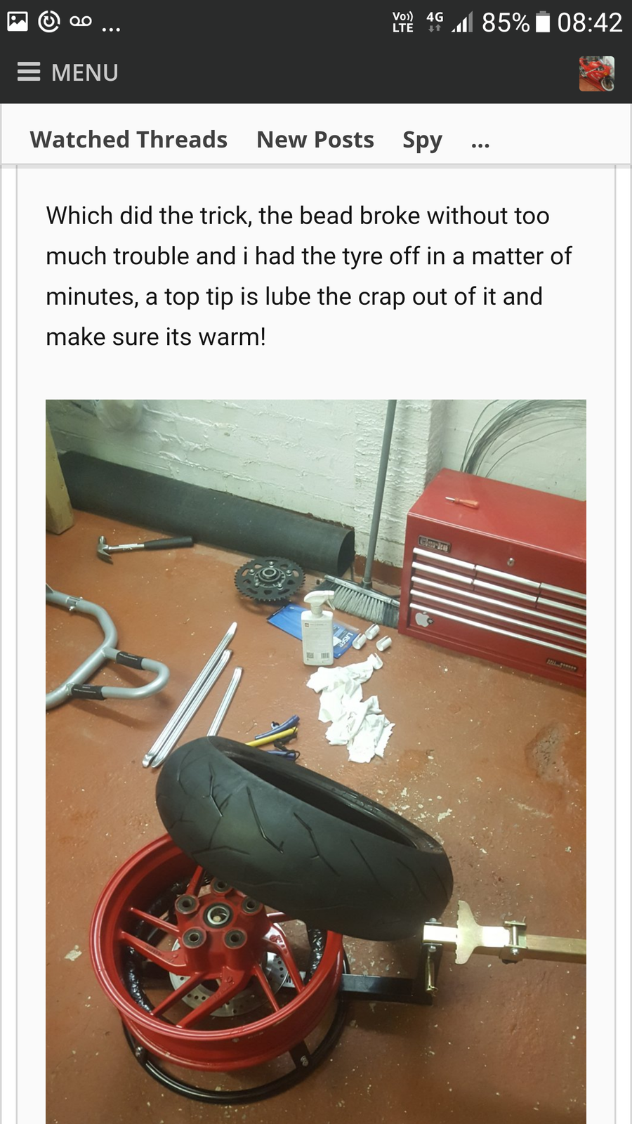

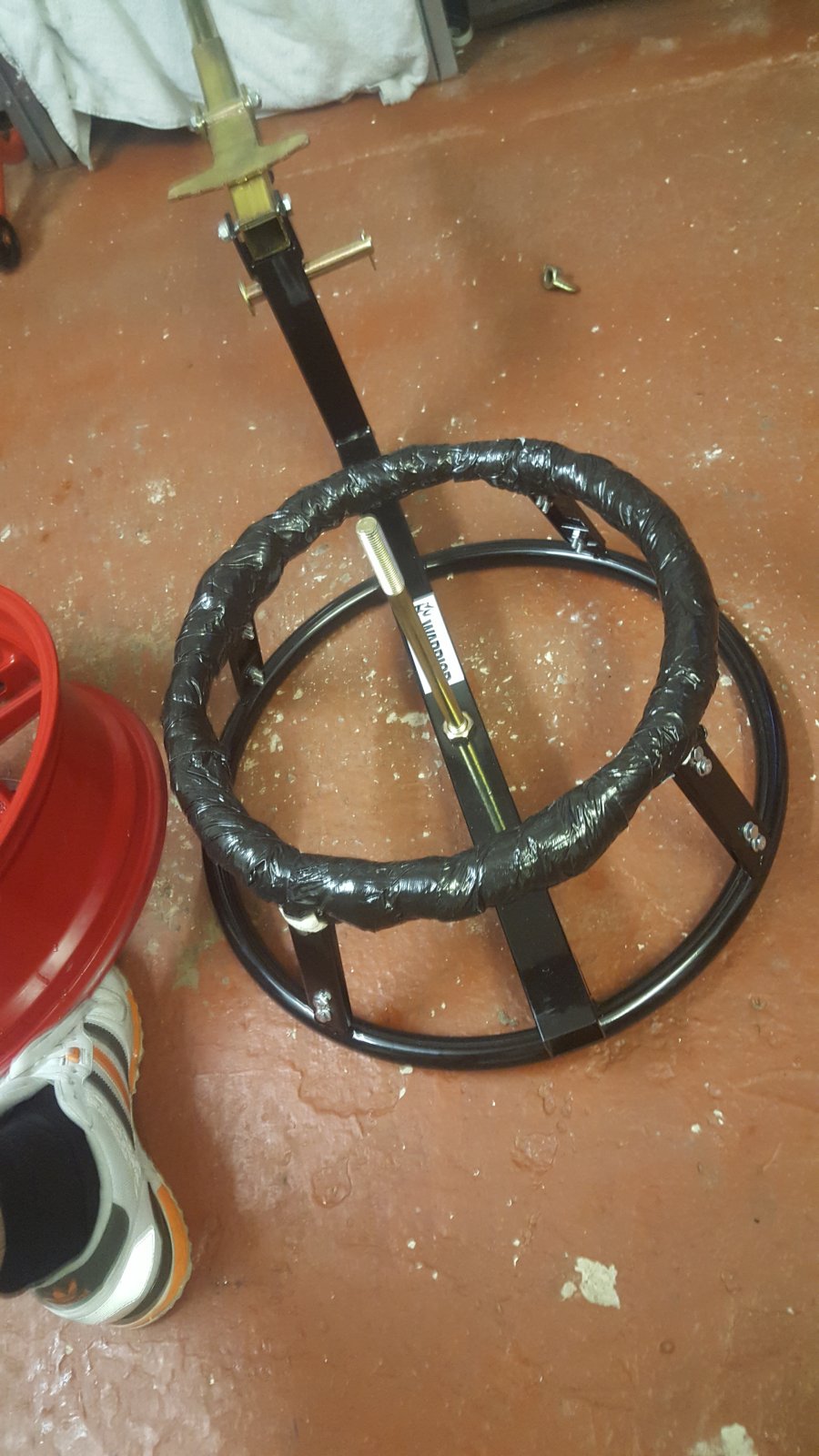

  2. Happy to report no tools got wanged!!! In the end i stumped up for one of those £38 bead breaker/tyre changer as mentioned earlier in the thread, the rim rested on the spokes on it so as not to damge the wheel i added a little padding
    Which did the trick, the bead broke without too much trouble and i had the tyre off in a matter of minutes, a top tip is lube the crap out of it and make sure its warm!

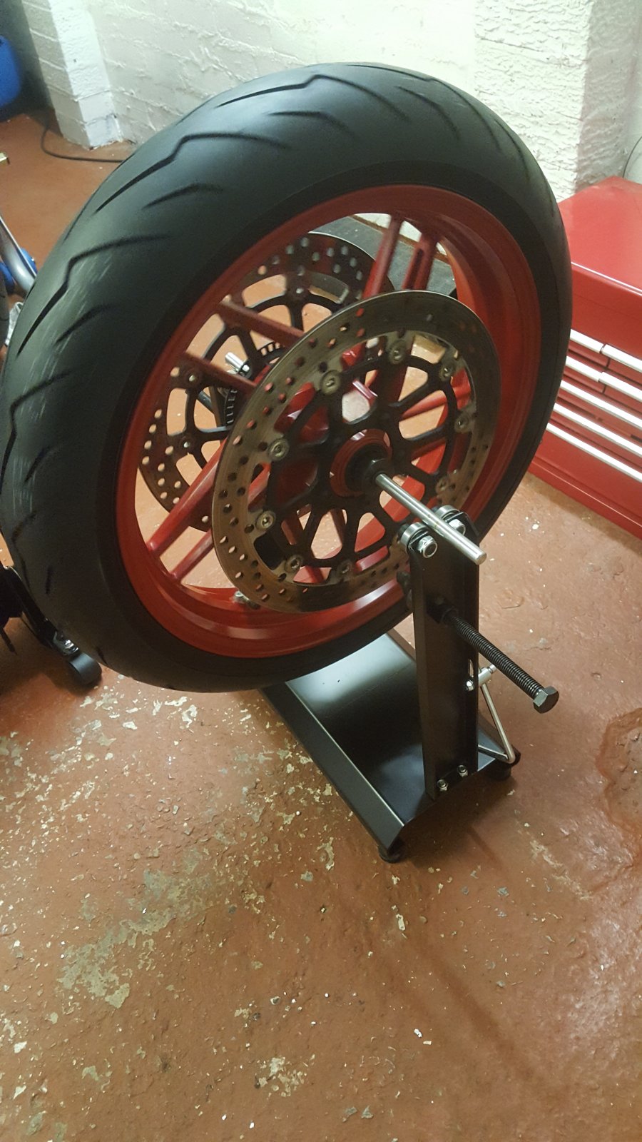

    I also purchased a static balancer, which i am still awaiting delivery so havent yet put the tyre back on, i shall let you know how that bit goes!
    Even with the purchase of new tools (which, lets face it, is always fun) i have still saved just shy of £30 from having them supplied and fitted at a dealer, so any future changes will save even more.....and acquired a new skill to boot!

  4. I have one if those.
    I moved the plates between the hoops to the inside as the nuts/bolts caught the inner rim on a SSSA wheel.
    Window cleaner makes a good lube.

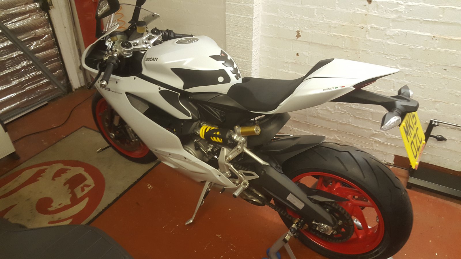

  5. Tyre iron launched into neighbours garden ...oops. getting the rear tyre on was a massive pain in the ass, i lost my rag a time or two and forgot to take pics, anyway,
    after i had a brew i tried the tie wrap method but with ratchet straps....worked a charm! Made things much easier and after retrieving my wayward iron i was calm enough to balance the wheels (balancer was waiting for me after work)
    This bit was super easy and very cathartic, watching the wheels settle really chilled me out for some reason, anyway not long after the wheels were balanced and back on the Pani.
    Cleaned the axles and regreased everything that needed it and whilst the wheels were off i got right into the nooks and crannies for a good clean and then gave it a good dose of acf50, all bolts torqued to spec. Job done!

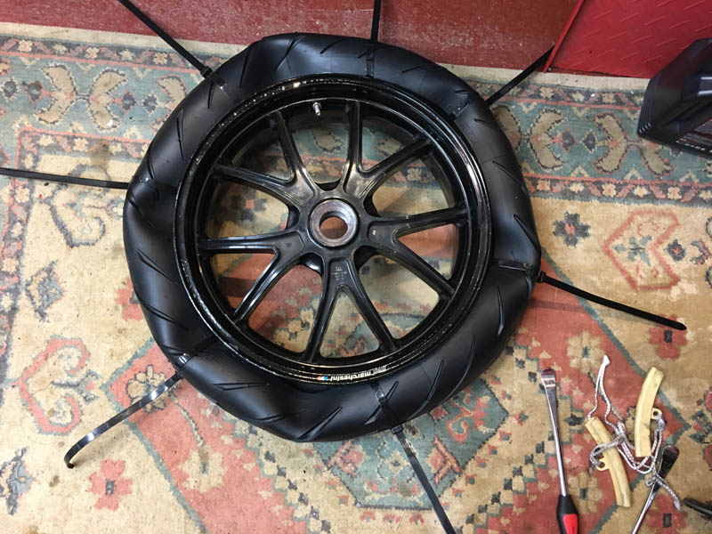

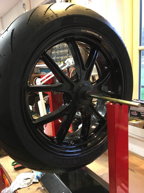

  10. Told ya so, re the cable tie method.
    See those tyre levers .. all you'll do with those big berthas is knacker your rims.
    You'd have been better off leaving them in your neighbour's garden.
    Mine are literally 3 inches long and made of plastic.
    And I only use those rarely.
    As a mate of mine said .. "its not a rubber band .. you'll not stretch it on".
    If you're fussy, its actually quite easy to balance the wheel with minimal lead weights.
    First balance the bare wheel and mark the heavy (or the light) spot.
    Then fit the tyre with cable ties equispaced all around the rim (this allows the tyre to be easily rotated on the rim later).
    Find the balance point in that condition and mark the tyre.
    Observe the tyre and rim markings and move the tyre around on the rim until mark on the tyre is opposite the light point on the rim.
    Repeat a couple of times until the wheel/tyre assembly balances up with the heavy point of the bare rim coming to rest at the lowest point once more
    Remove ties, pop the tyre onto the beads and then add your balance weights as necessary.
    Or something like that .. you'll work it out as you go along.
    Ok, that might be being ultra fussy but when you've shelled a couple of grand on carbon wheels the last thing you want to do is slap unnecessary lead on them.
    I saved myself about 50g on the rear wheel.
    And that's 50g unsprung weight, rotating at full wheel diameter, so fairly significant.
    You wouldn't think a new tyre would be so imbalanced, would you (brand new Michelin PR3).
    The bare rim balance points can be permanently marked so subsequent tyre changes are simpler .. I used a tiny vinyl dot sticker.
