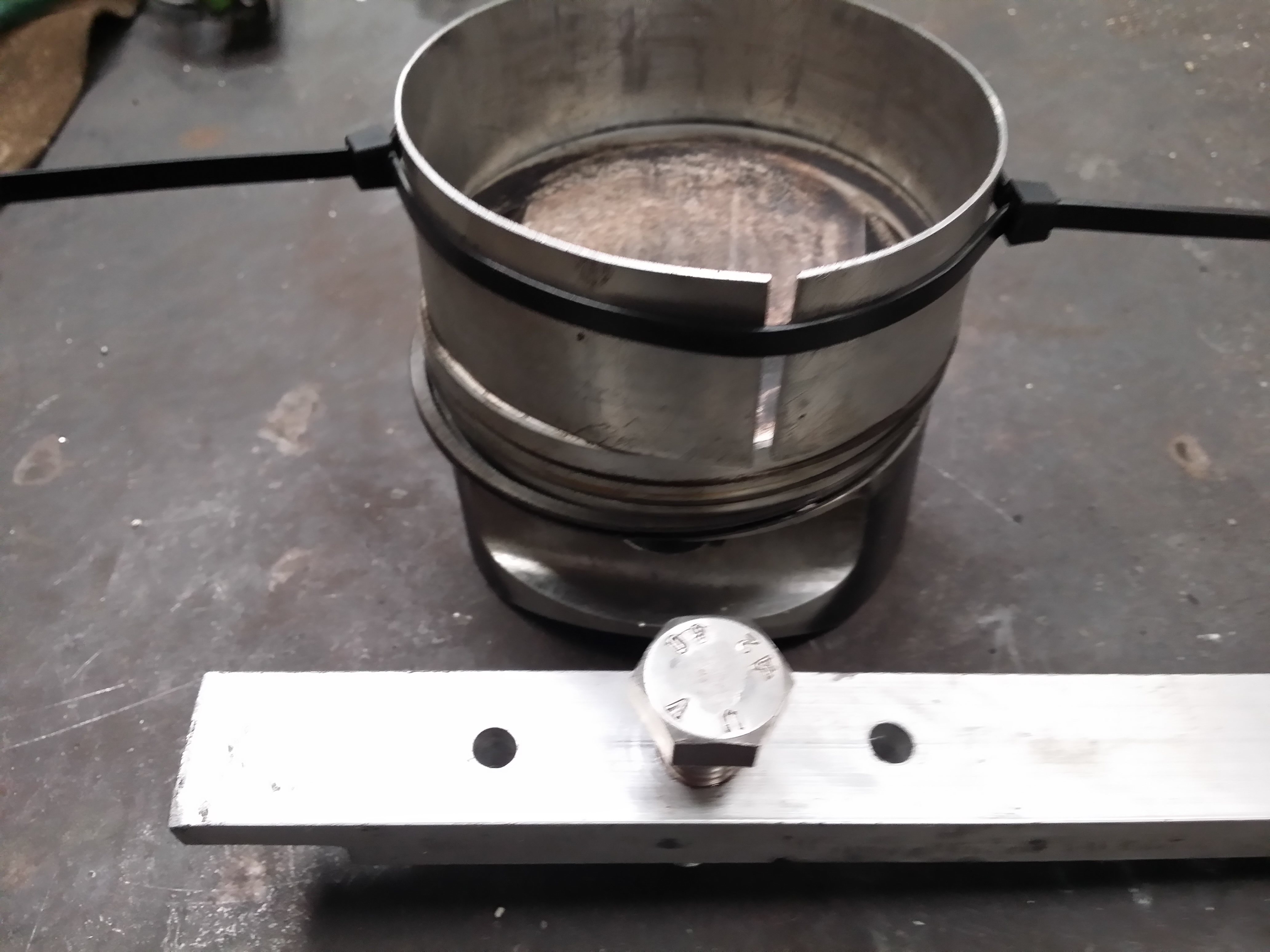

  6. I forgot the piston ring compressor....it can be a tricky job if you dont have 3 hands so i made this from some thin alloy sheet and a couple of cable ties,a couple of pieces of wood will do if you dont have a engine stand. 20140730_121526.jpg

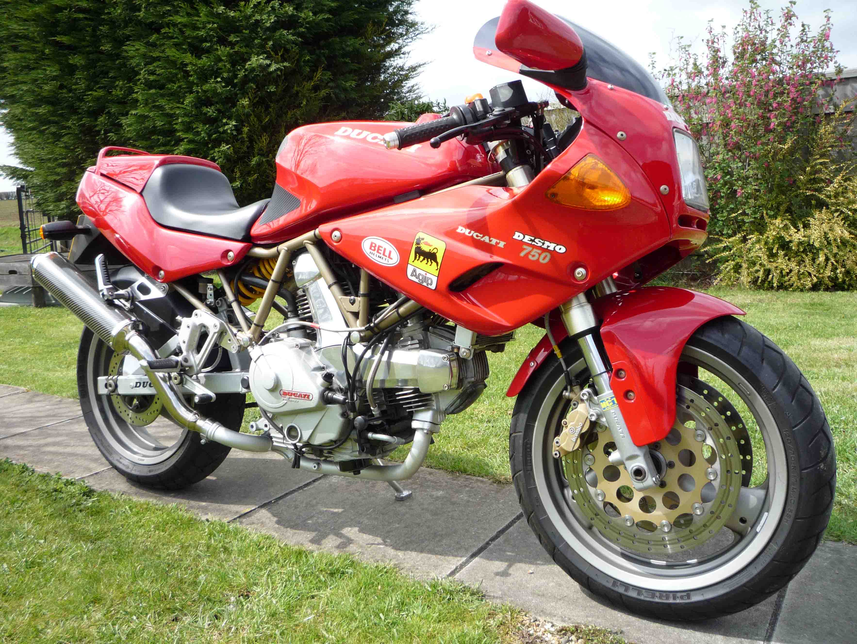

  12. I've just used enamel paint on the belt covers on my 400, and I used Halfords own engine paint on the rest. The paint is really good if you like a shiny finish, the 750's engine is the same, there is photos in the gallery.
  13. I polished my belt covers.........they're shiny too........... :p
  14. Can we see a pic?
  15. Look in the gallery..............oh, OK, and below..........
