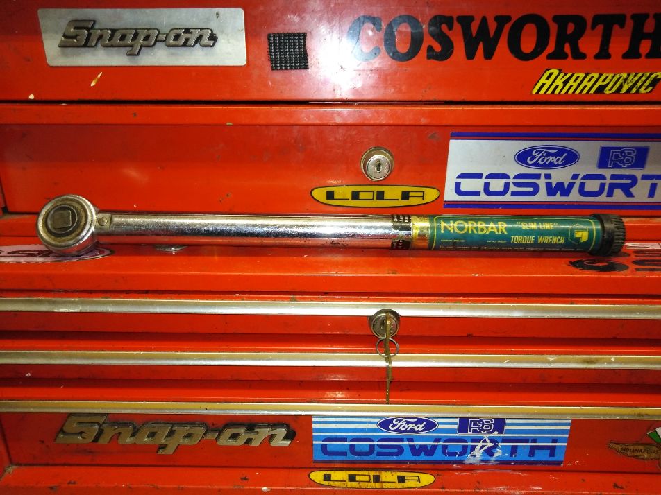

  1. Must've had this NORBAR for 40 years, and it was my old mans before that. Always zero'd after use but never calibrated. Wonder how far out it is? wrench.jpg
  2. I have it's baby brother, thinking about it, it's the same vintage. Bought new by yours truly... how did that happen :confused:
    Mine has never been calibrated either and like yours is wound down to the bottom of the scale after each use. It's an assumption for the lower values but I don't think it's wildly inacurrate as I tested it against my smaller Halfords advance torque wrench, for values with an overlap, and it seemed to be the same or as close, in my eyes, as makes no difference.
