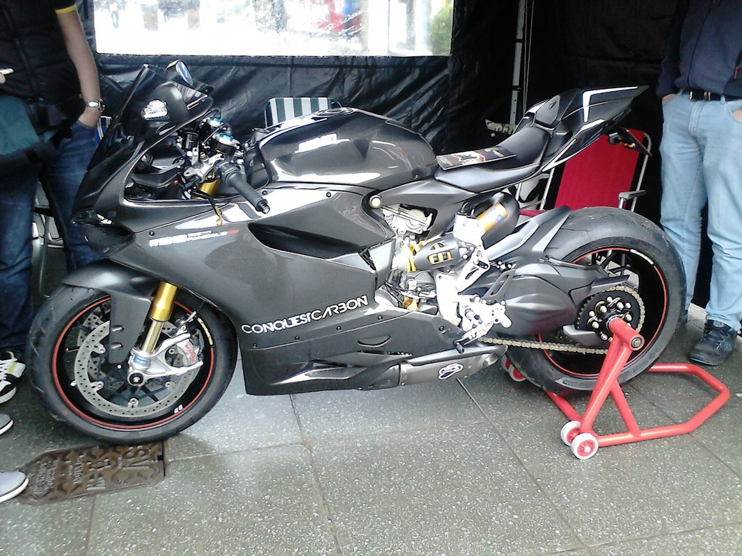

  12. Our show bike 1199 has all Fullsix carbon fairings inc tank
  13. Fullsix don't import any of their products instead they are the manufactures. They also make many OEM parts for BMW and a lot of their products are used in BSB & WSB. They are also the only manufacture who have developed the Monocoque tank and subframe I.e a product from one single piece of carbon fibre. Here is there promo vid.....
