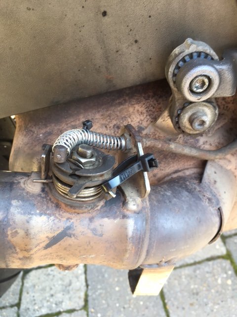

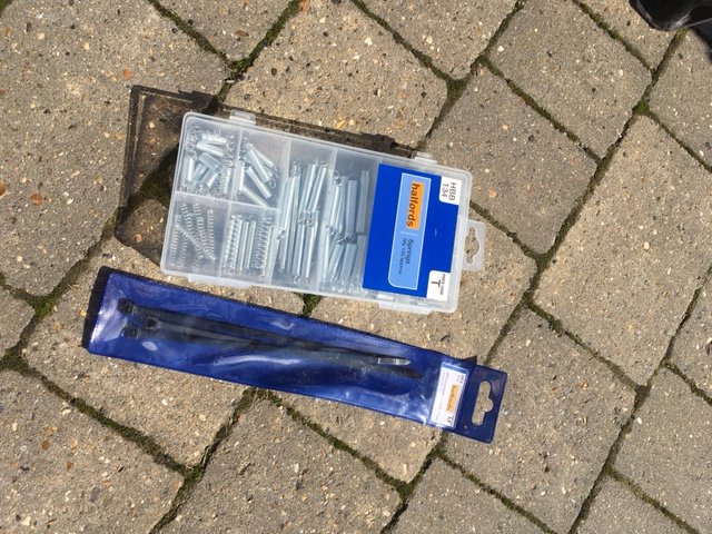

  7. Followed your advice Bradders, bought a small pot of assorted springs and some cable ties for a few quid from Halfords. Cable tied the valve open and threaded a couple of the springs into place. Result! Valve is now locked open and the cable pulls in and then the spring pressure pulls it out again every time the engine is started. Flat spot has disappeared.
    Hmm, post script - orange light is now permanently on.
  8. Have you ridden it yet? IIRC mine came on then cleared when ridden. It may be worth adding a bot more tension to the spring. Or spend £50 and buy a healtech plug in thing :)
  9. Have ridden it - although only about 10 miles. Will add another spring to increase the pressure and see if that does the trick
  10. Wont the cable ties melt?
  11. Looking again at the pic, I doing have the cable tie on like that. It is used to add tension to the spring, not hold anything together IIRC, and may be causing your light. Remove the cable tie and see what happens: the valve return spring still needs to be fitted as usual: all you are doing it disabling the cable
