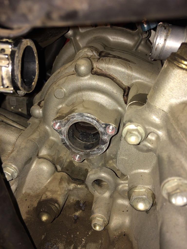

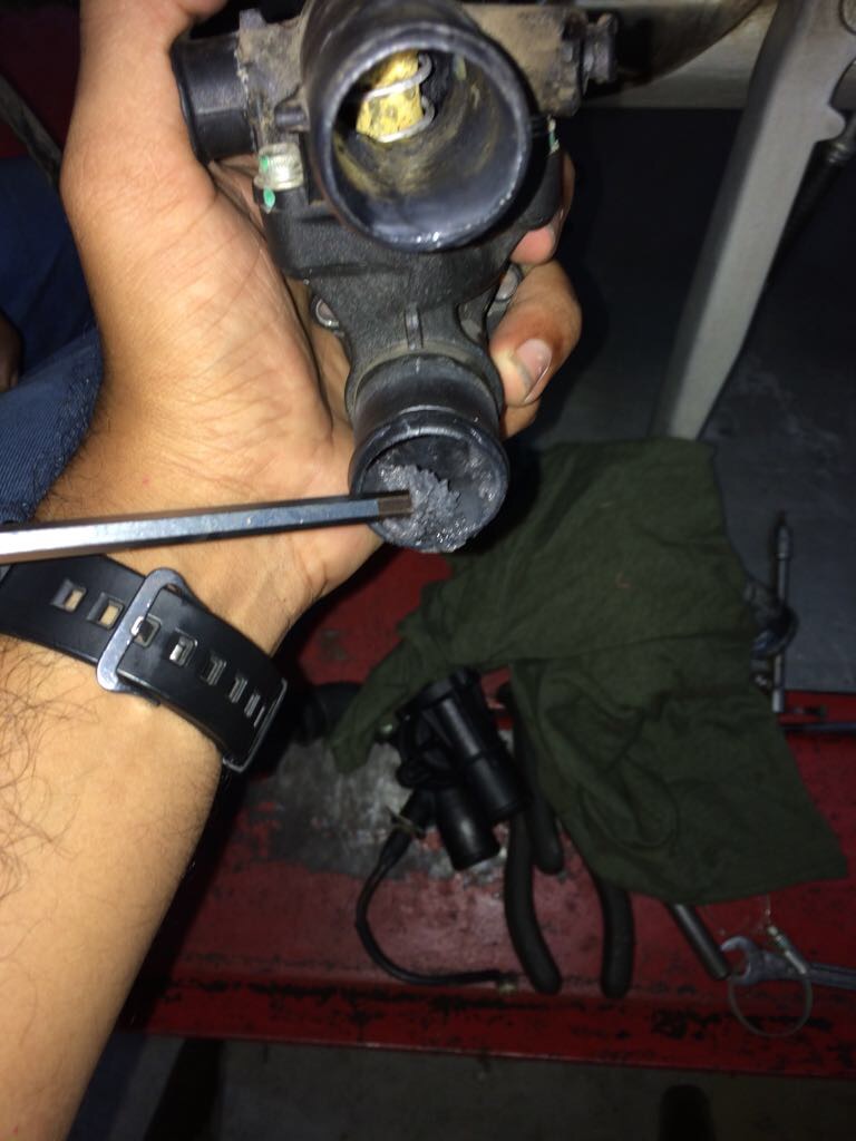

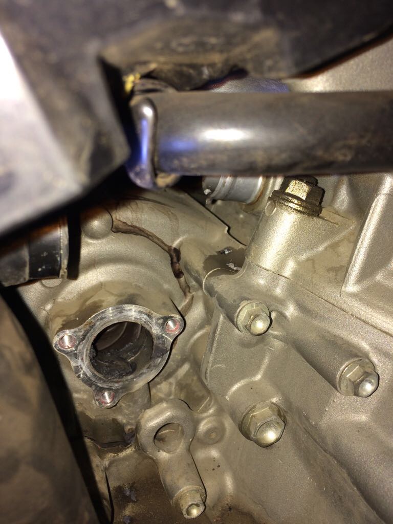

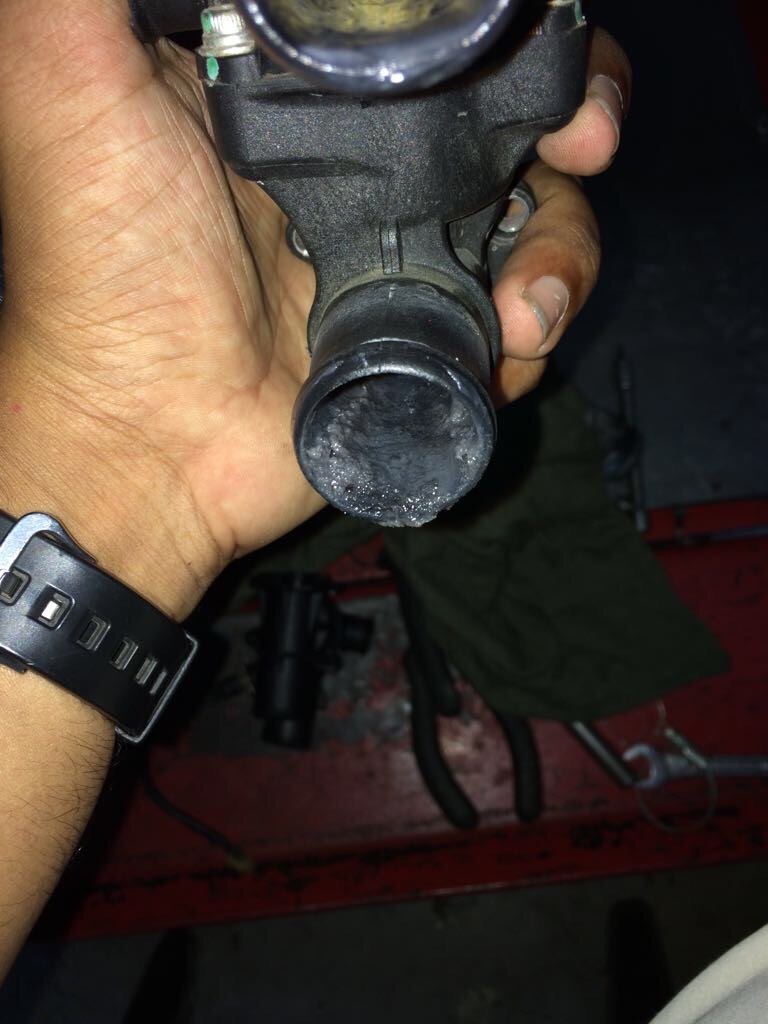

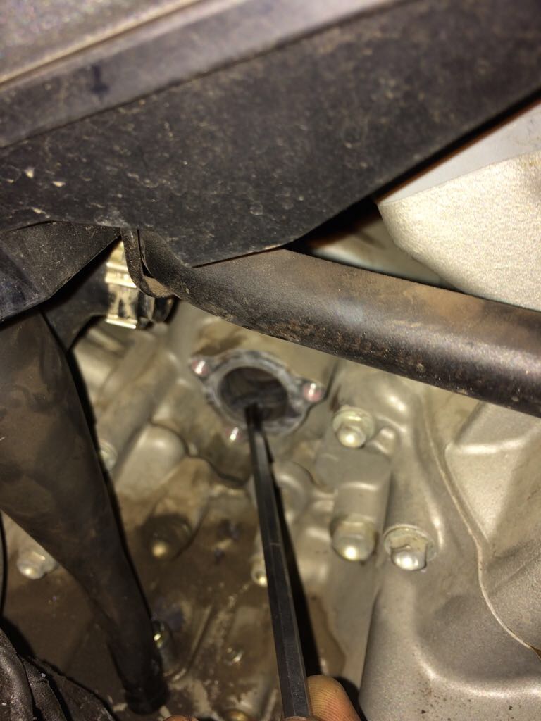

  10. Sooooo... I finally got an update for my bike yesterday and it’s not pretty... All this because of a coolant change... ‍♂️
    To quote the Ducati mech -
    B06105BB-2FB7-4FD5-B16E-3DA64704CE31.jpeg E26D0BB6-DDCE-44F6-9209-C090E7BCCBEE.jpeg 351E03D7-FB28-47DB-A274-01D67870B7BA.jpeg 4658E037-61CB-4C6C-837D-C4AF0A9B3AC5.jpeg 35FE1620-7346-4C42-A224-B89BC2ADAA94.jpeg

  12. He's going to be taking the engine apart and cleaning the residue left behind by the water wetter and take it from there. No parts to be replaced, apart from the broken thermostat, but a shit load of labor... :worried:

  15. As has been said, Water Wetter is not a coolant, it is an additive. It is intended to be added to your coolant, not to replace it.
    Can’t help suspecting that the mechanic has simply drained the original coolant and replaced it entirely with additive.
    Either that or he has used an entire bottle, rather than an amount proportional to coolant capacity. I suspect the former though.
    Water Wetter is an established product that has been on the market for years, if it did this to engines when used as instructed it wouldn’t have lasted five minutes.
    Imho, It is almost certainly the mechanic at fault rather than the product.
