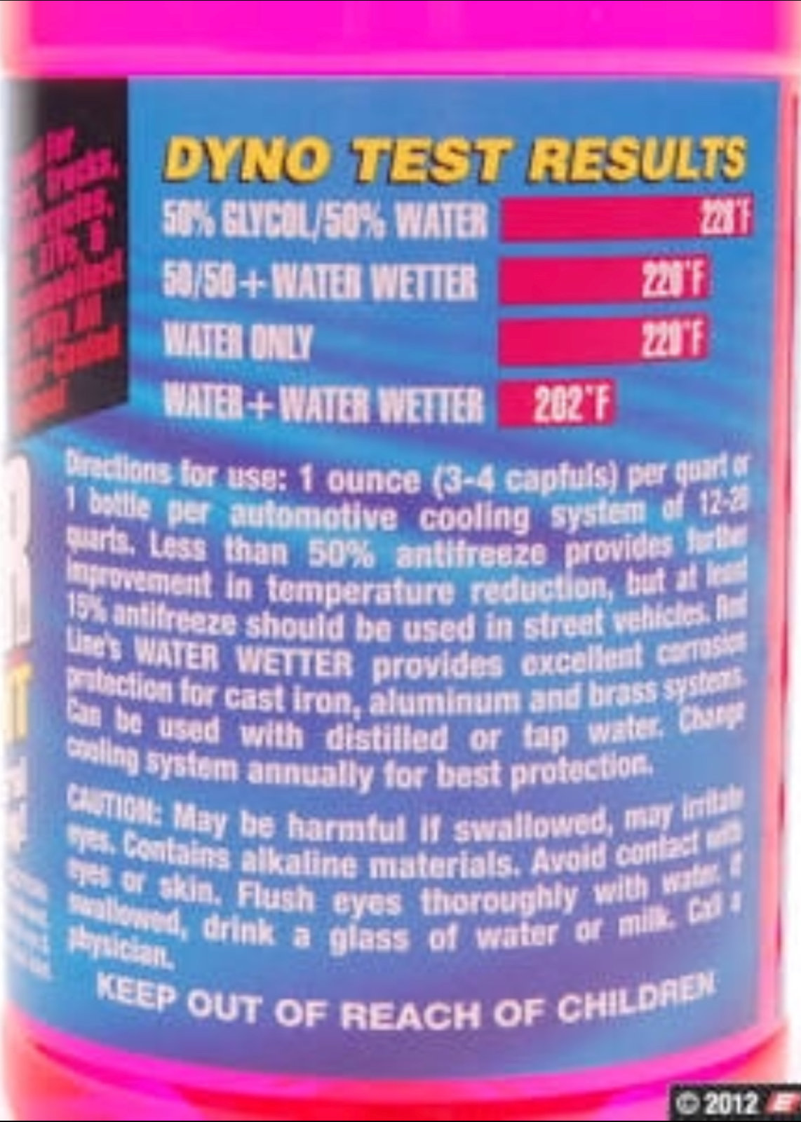

  3. No anti freeze was added for two reasons:
    1) Redkine recommends just water wetter plus distilled water for best results.
    2) I live in Bombay, which never goes below 15*C, let alone below or even close to freezing.
    Do you think that caused the problem?

  5. Maybe he put the additive in first and then topped up with the distilled water, so the two failed to mix properly before the engine started to get hot and fried the unmixed additive.
    Favourite scenario has to be that he simply put the whole bottle in and then topped up with distilled. If the additive was correctly added to the distilled water

  7. Hi guys, just a thought, wouldn't it be possible to clean out the engine by just flushing it with some kind of solvent, to remove the residue left behind by the coolant. I've put forth this with the ducati mech, not sure if it's a good idea or not..
  8. There are several proprietry flushing products available but not sure if any of them will shift silicone mush. Got to be worth a try though. Andy

    Distilled water is a more efficient coolant than the conventional 50/50 mix of water and ethylene glycol. However, the ethylene glycol raises the boiling point of the coolant compared to pure water. The combination of that and the pressurised cooling system raises the boiling point from 100C to something like 130C, so it’s not a simple call, which is why Water Wetter sells.
    It allegedly allows you to retain the high boiling point, along with more efficient cooling at the same time.
    Apparently, the ingredient that can leave residue is an anti foaming agent, not the active ingredient.
    Motul make a similar product - I wonder if it has a different anti foaming agent?
