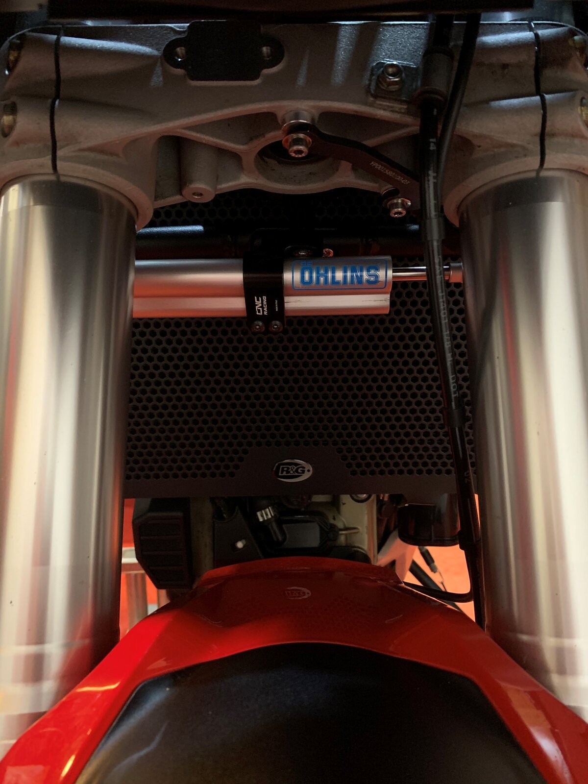

  9. Add a steering damper, they can be discrete so as not to annoy the fruitloops that moan about 'em not being needed ;) and they do sort any flightiness. Win Win :)
  10. Was thinking about this - standard fit on the KTM Super Adventure S that I had - a bike with similar characteristics at higher speeds.
  11. That's pretty neat and tidy...
