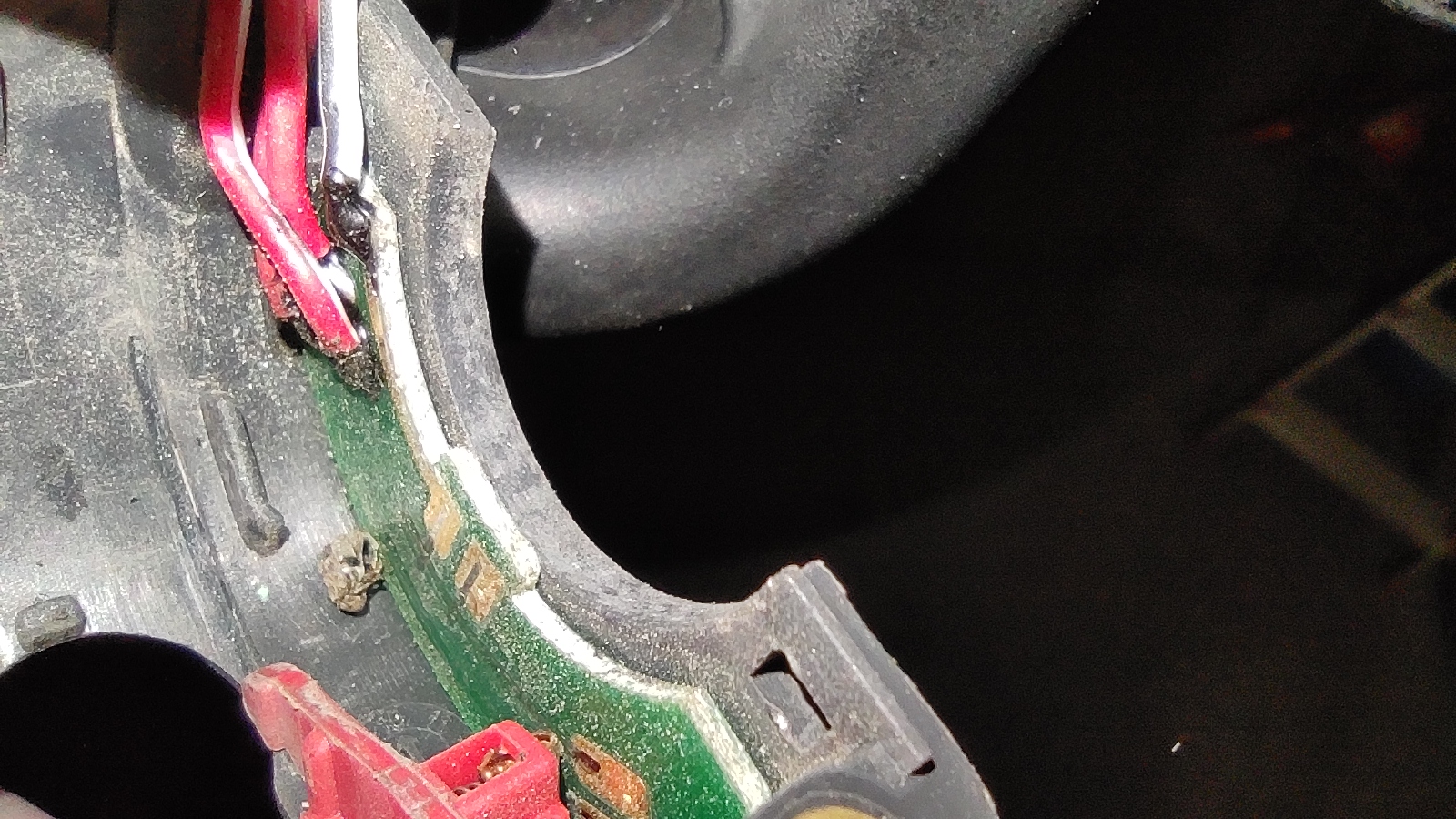

  6. Dismantled the right switch gear. It looks quite clean to me. No signs of moisture whatsoever (fortunately it is way less of a headache to reasseble it than I imagined). Tried to test if the relay connector sends voltage but unfortunately the bike won't even turn on without the connector attached to the relay (obviously the main unit checks whether there is a connection there and only after it finds one sends the signal to the dash to light up. This can be devised further from the fact that DTC is turned off and the trip counter is reset when this loom is disconnected. It also lights up the dash momentarily when reconnected). Tried again to fire it up with the bike on center stand, side stand up, in neutral and clutch lever pulled in. No joy.
    I have noticed that if the bike is in 1st gear and the clutch is pulled in it does not disengage completely, making the rotation of the wheel by hand quite difficult, although I doubt this has anything to do with the situation.
    I'm running out of ideas ...

  10. Small update on my situation:
    Starter relay is in working order (not stuck)
    Sidestand switch is in working order
    I'll try the clutch switch next (when I find where exactly the connector is) and then try to read the voltages on the relay connector if I can manage to slide a small wire in there and if this works as well, it's off to the dealer.
  11. So, after a 3 month delay of the RH switchgear order, I have finally found the culprit. It was the start button after all. Thanks to everybody for their suggestions. It seems it was a good opportunity to learn a bit more about the bike as the fuel tank needs to be removed for the switch to be changed (the loom ends up in a bundle of connectors tucked under the tank). Tested all the relevant switches (clutch, side stand etc.) as well so it was a nice tutorial.
    Ready to fly again. All the best.
