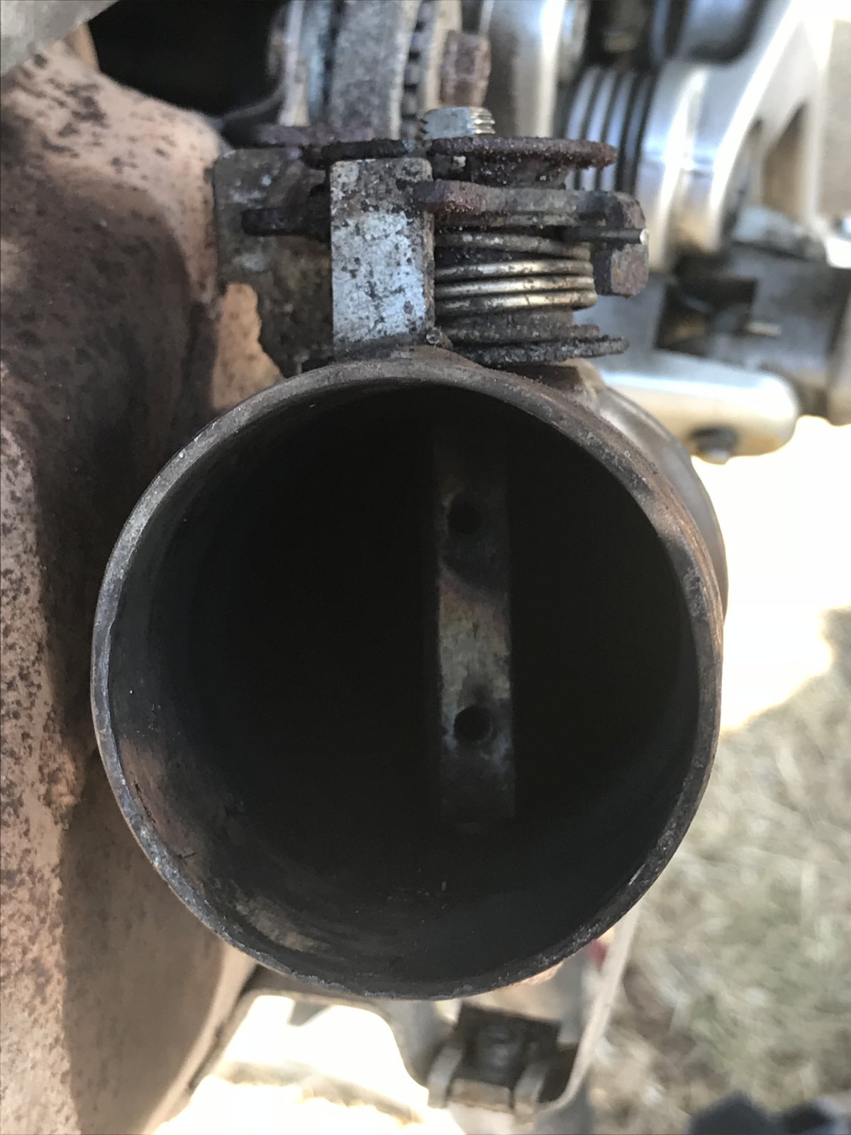

  17. Had the bike out today and experienced the same, no top end power at all, all choked and restricted. Got home, took the termi off and freed up the valve, perfect now.
    How do you go about removing it??
  18. Take it off & drill or die grind the 2 fixings on the flap & remove it. I believe doing it this way will not bring up any fault codes on dash. I say this as I have the full termi on which gets rid of valve altogether.
  19. I removed mine recently. As others have said I just drilled out the two screws and removed the flap, whilst being careful it didn't disappear down into the collector box. It still cycles with no fault code.
