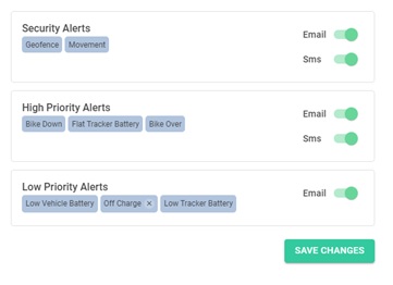

  2. This is an update to my previous post (#18) on this subject, which may be of interest to those possibly affected.
    I asked Biketrac why I did not receive an SMS low voltage warning from the tracker before the bike battery voltage dropped below its threshold level.
    They told me that they no longer send SMS messages for all alert warnings, and the current policy is:
    Apparently, I should have received an email warning, but an error with my recorded email address appears to have prevented this.

    However, an update from Biketrac sent today states:
    "I am afraid You have pointed out an error on our website which we have missed and should have been updated five or more years ago when the changes were made. Thank you for pointing it out and we will get that changed. The current state of play is we send Email alerts and Push notification to a person’s phone as long as they have the App downloaded (the intention that this would replicate a text on some level) there is no option for SMS. Apologies for any misunderstanding that has occurred, you can see in the previous image the current state of the application and its associated alerts."
    I suppose for those who are able to run the APP, then this provides a workaround, otherwise low bike battery alert warnings will only be sent by email, which isn't always readily available, depending on where you are, which might lead to a flat bike battery and affect Tracker functionality before corrective action can be taken.
    This seems like a reduction in the extent of the alert warning system, which is not good news.
    Anyway, I hope this helps clarify how Biketrac deals with different types of alert warning, and helps avoid any associated problems.
