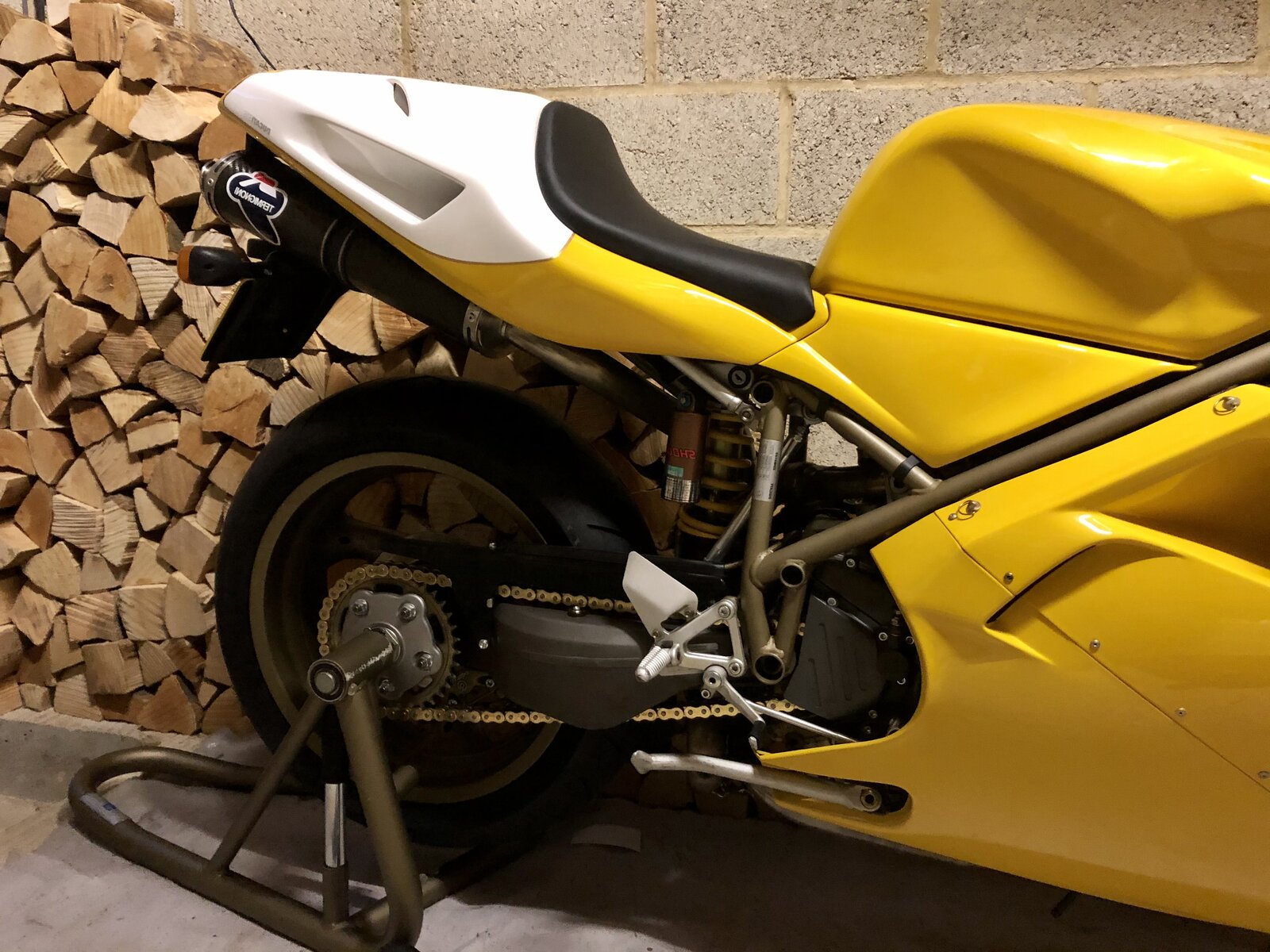

  1. Bloody hell!! Be careful mate, you’ve put the chain back on the wrong side :D:D:upyeah:

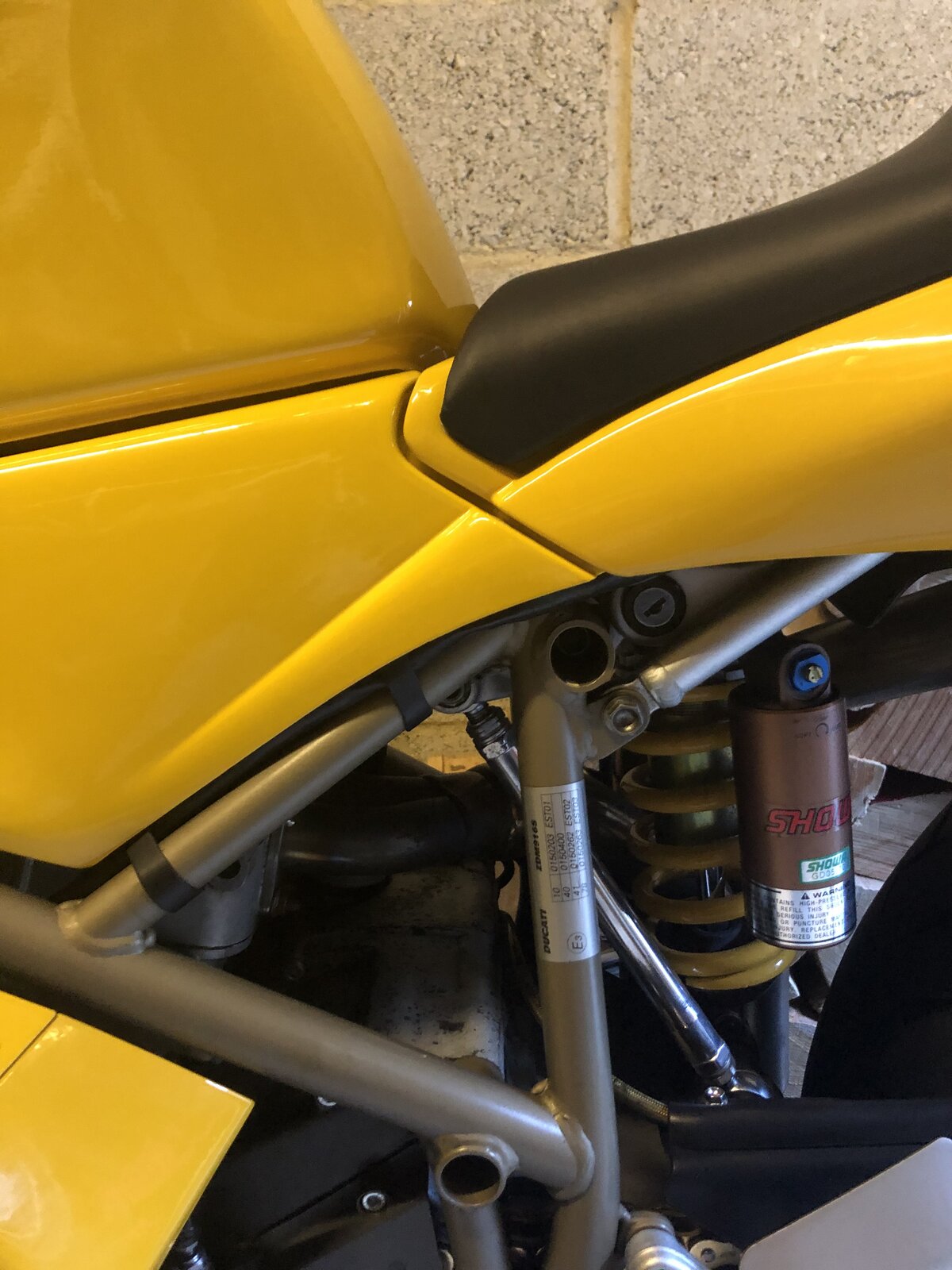

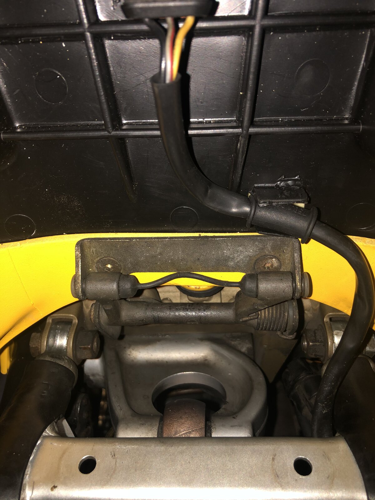

    On serious note it looks mint, but the gap between seat unit and air box looks very tight. With riding it will flex and chip the paint off. Are the spacers/washers inbetween the frame and seat hinge in place or need a touch more?
  2. Haha well spotted pic got reversed!
    Already adjusted the seat by moving the locating pin so hopefully it doesn’t rub against the airbox panel. Do I need spacers as well ? 9B7032D9-A276-4235-A96F-28735FC97E83.jpeg B05AB315-93FD-48DC-A86C-5279B5A4D873.jpeg

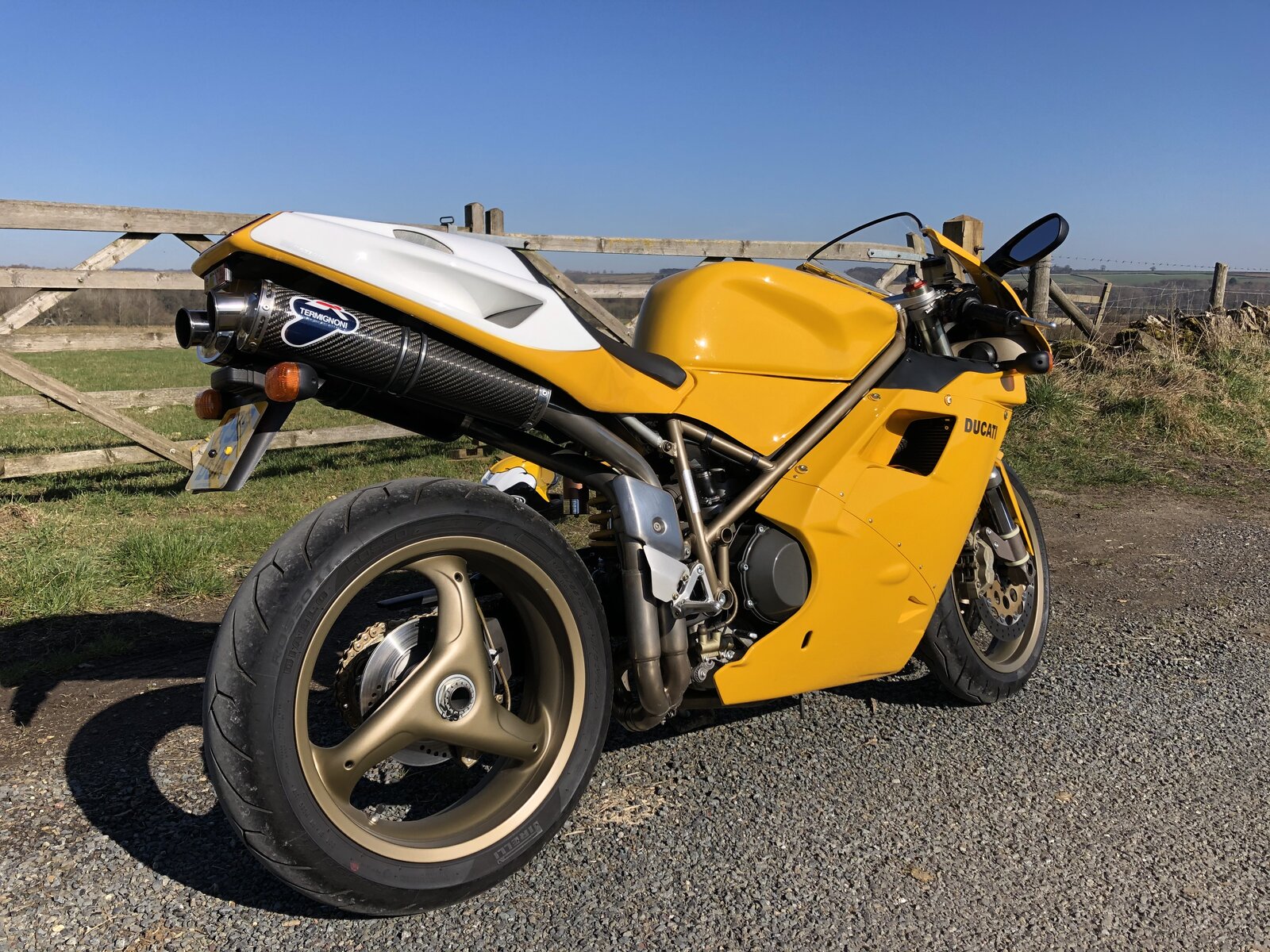

  5. Very happy with the final result including general tidy up and battery switch back to stock from Lithium :)
    • Like Like x 8
  6. thats a great looking bike mate, good work:upyeah:
