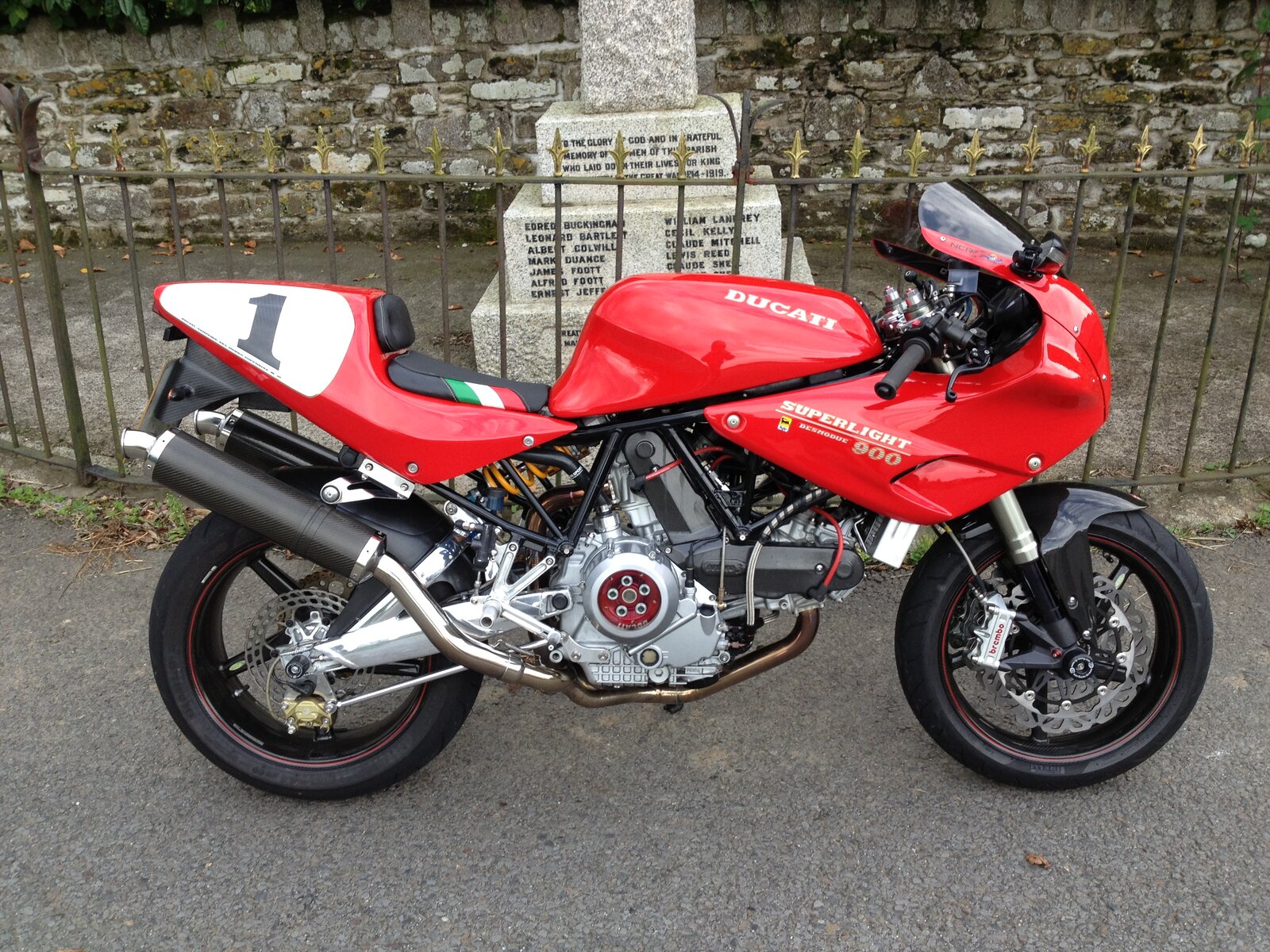

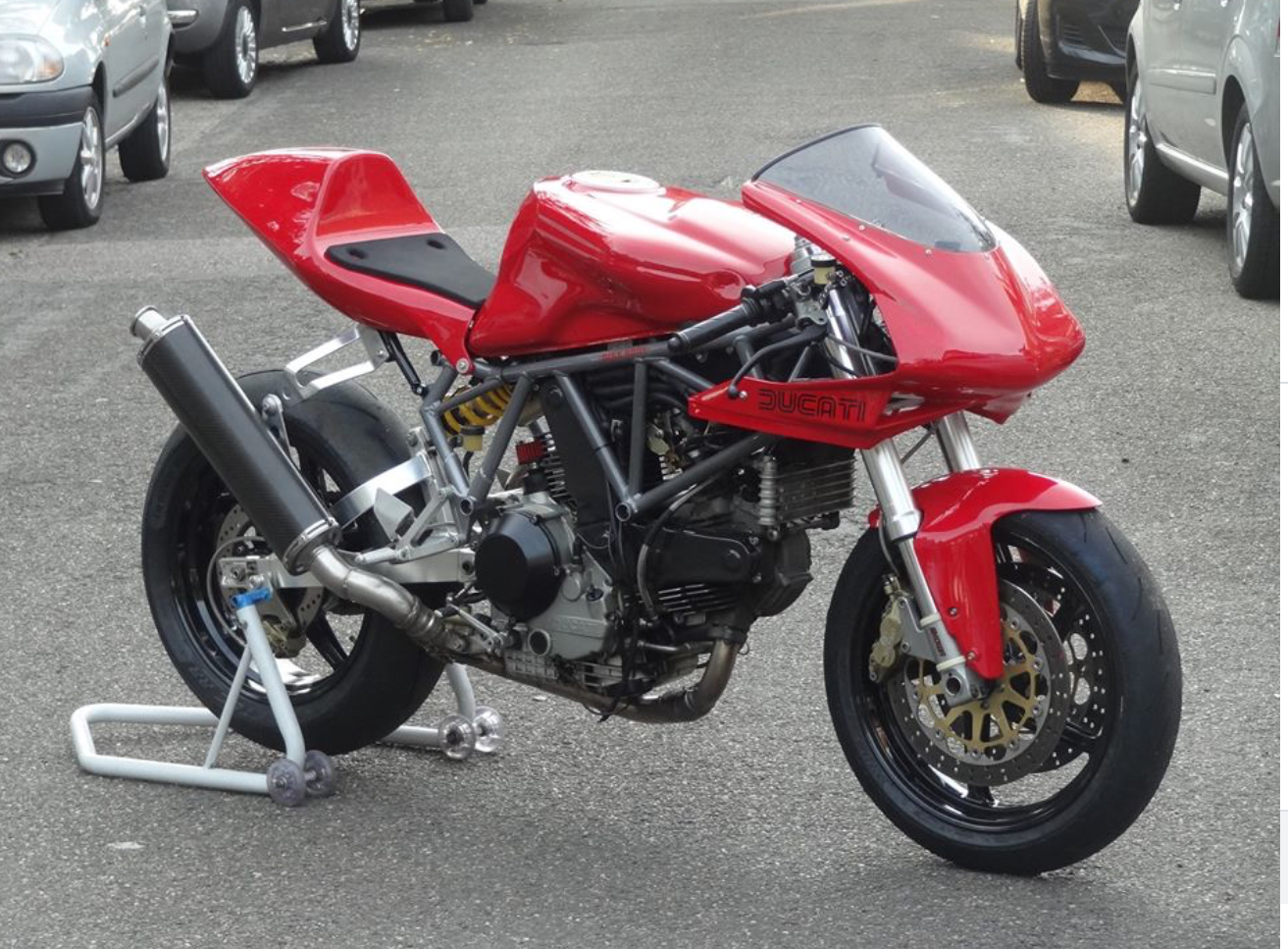

  2. If you do decide to go Superlight look..just buy a ready painted rear tail, they do come up from time to time on the bay. i went with pattern ricambi weiss. And by the time I had sanded, painted, added fixings, added seat, added decals I had spent the same as a one off the bay. (And I had lost a couple of days of dicking around with it).
  3. There we go! Still one of my favourites.

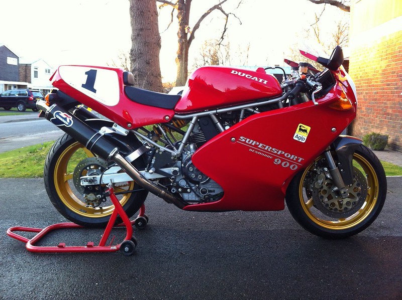

  4. Standard / OEM dual seat and pillion cowl. I designed and did the paint job. OEM wheels.
  5. It also looked like this....about two years before I did the paint job.
  6. I've had a few bikes with different mods and it can be a right money pit........still is.

  7. ^ you're being modest Paul - have you got some pics handy? did you end up happy with the c/f airbox you designed and made?
  8. Alright Chris. Yep stuck with the airbox and it's been fine.
    IMG_1669.JPG Old picture and still modding, just a lot slower progression since getting the track bug. Bike has a set of black HEL calipers fitted.

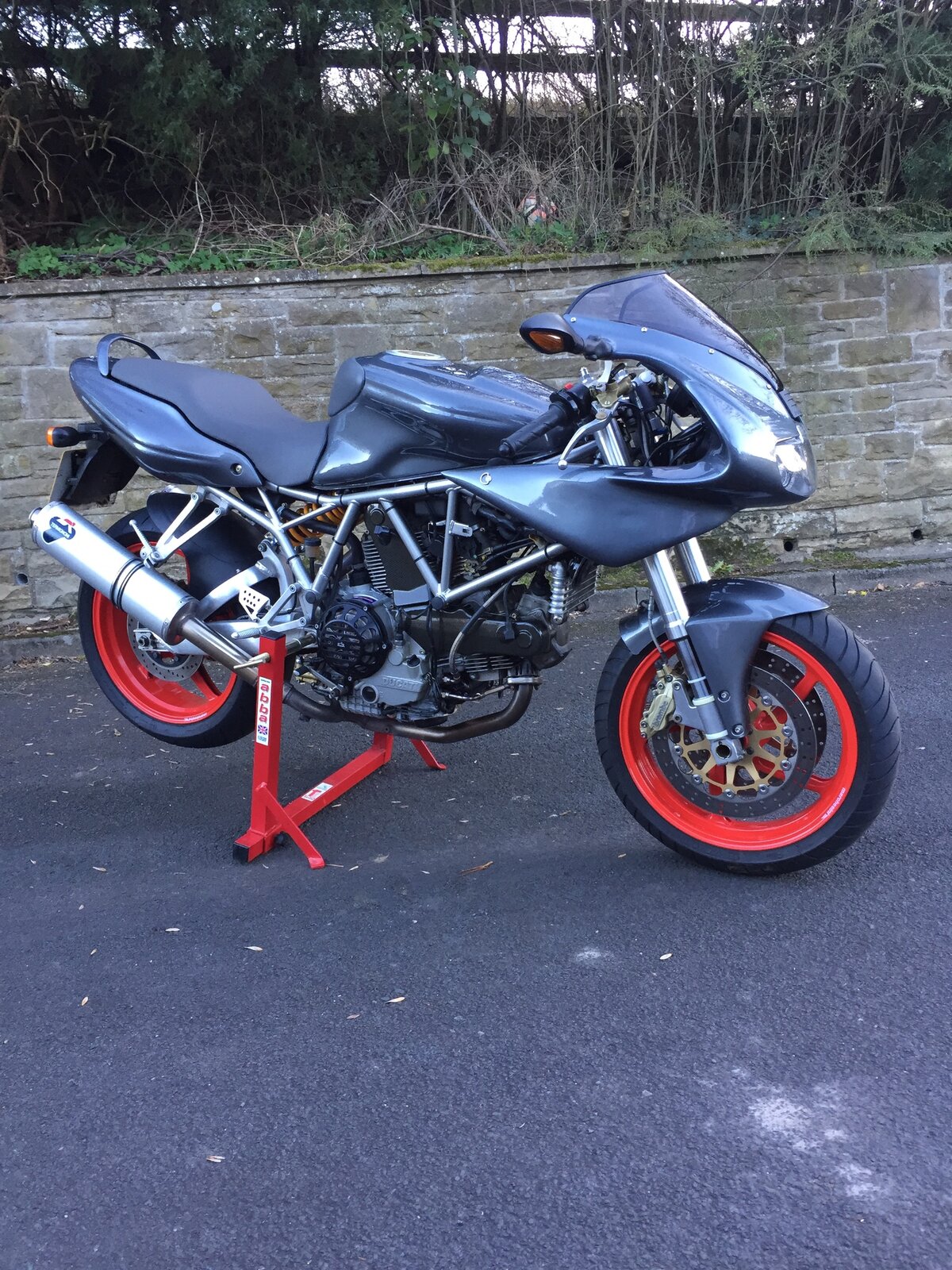

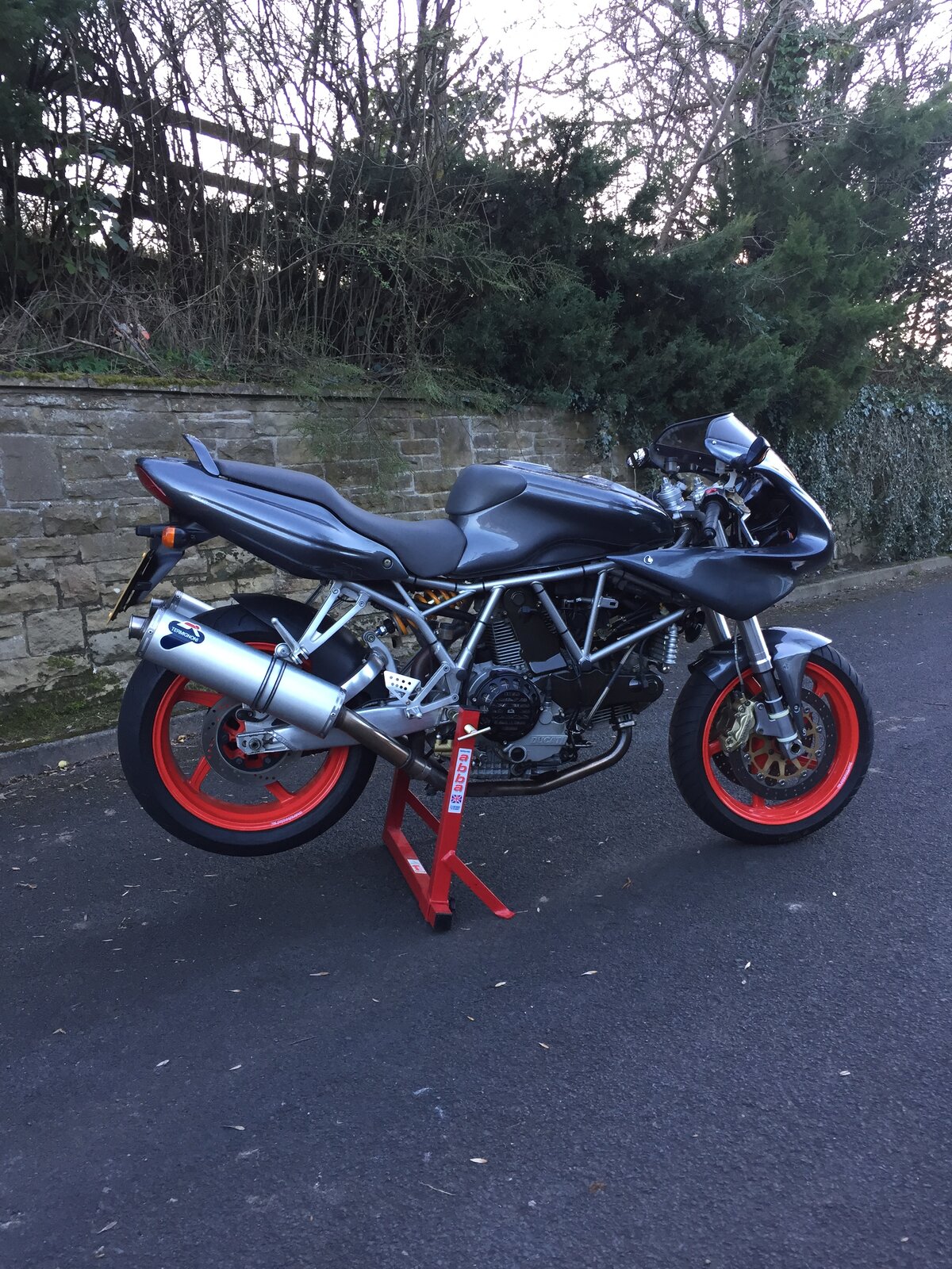

  13. @dukesox has one for sale, similar but different.
    My god that’s clean!
    Love the senna and red wheels, reminds me of my earlier monster S4.
    • Thanks Thanks x 2
  14. Bit of corrosion at the front of the engine but overall it’s a clean bike. Best mod pound for pound is to lower the gearing.
    I think changing the wheels on the earlier bikes is a good thing to do as the standard ones are quite heavy. ST4s seems to be a popular choice.
