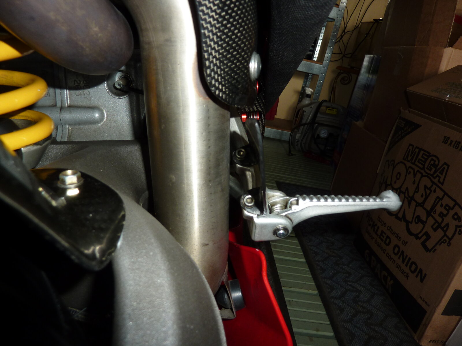

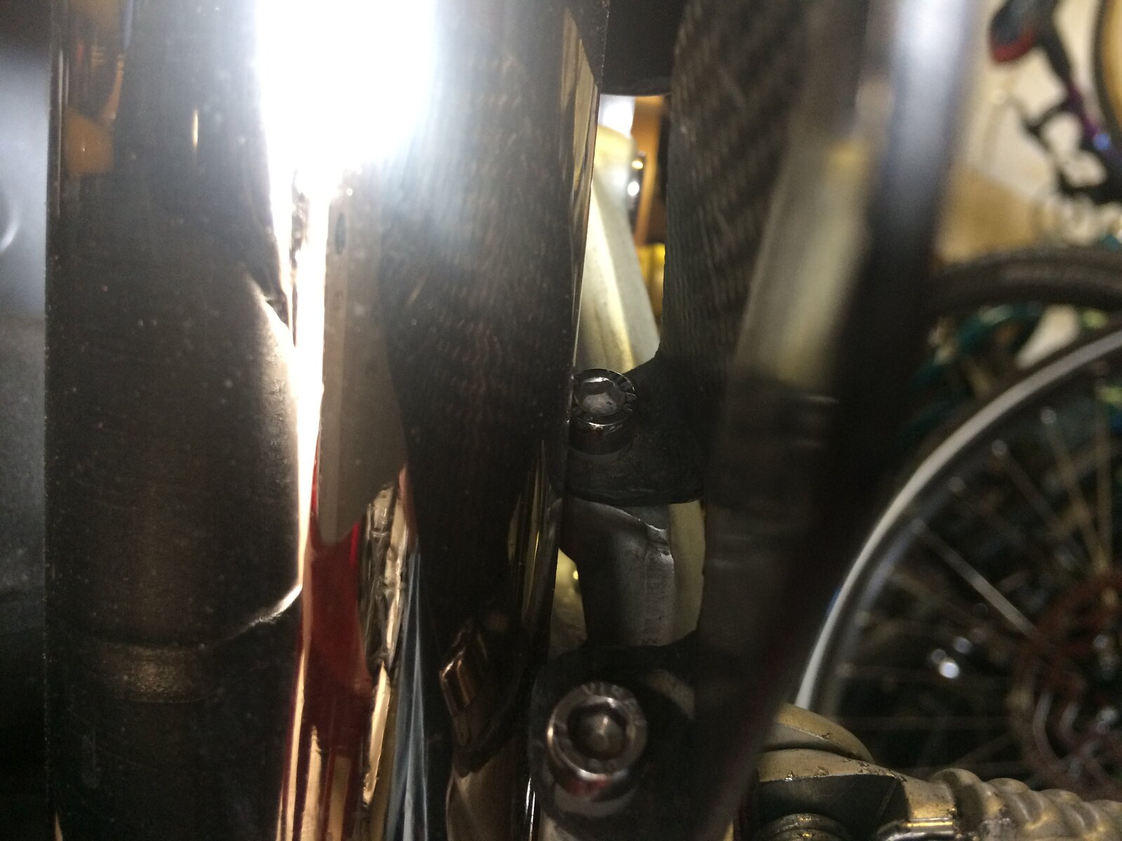

  8. Fitted Chiz’s footpeg yesterday but discovered the clearance between hanger and exhaust was pretty much zero, so now worried my hanger may be bent. Can anybody confirm the clearance on their 999 please??

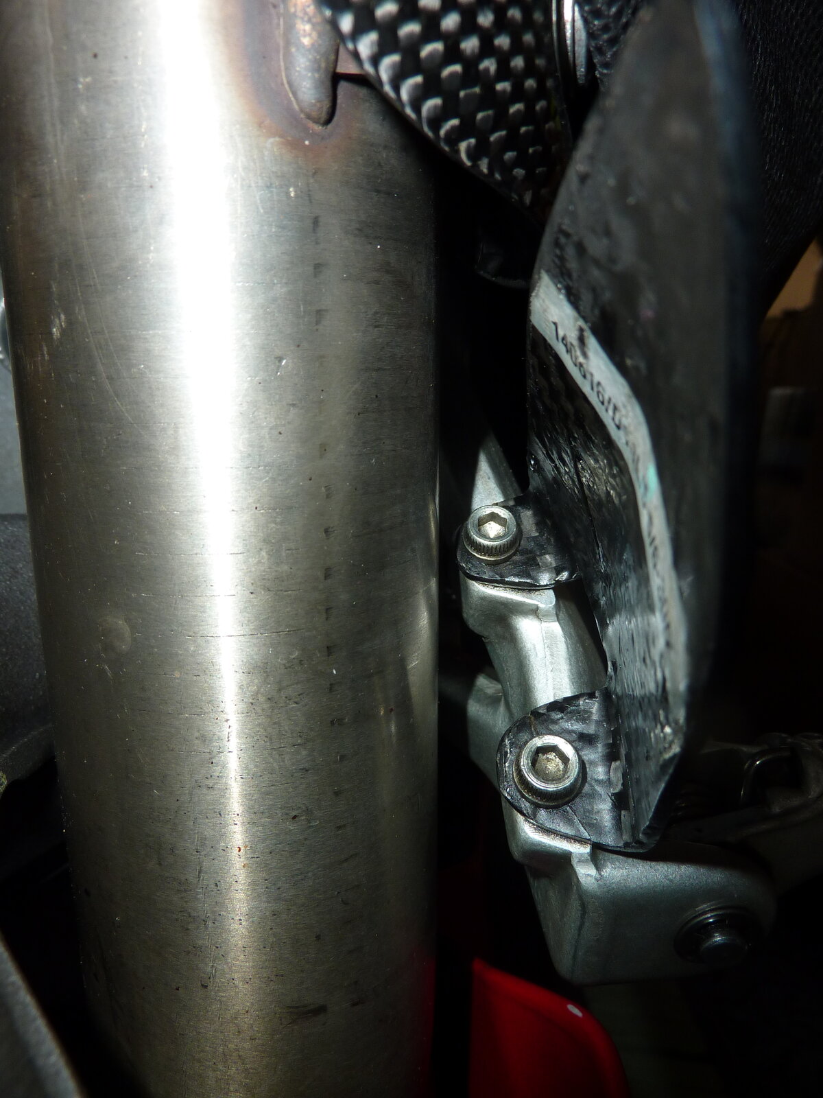

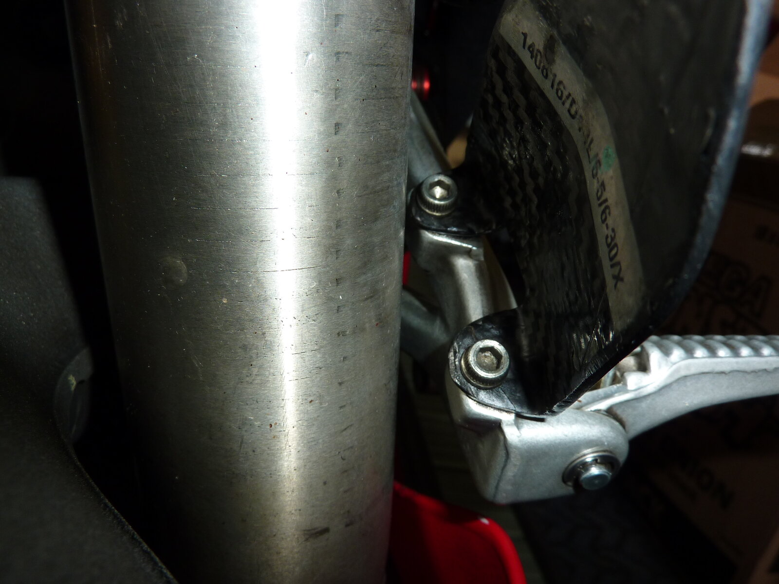

  9. P1000413.JPG P1000414.JPG P1000415.JPG The narrowest point is at the upper heel guard allen bolt.
    It is approx 8-10mm
  10. Bummer.
    Do you have big bore exhaust.
    Without a hanger to compare its difficult to say its bent you really need a known
    good one to compare to.
    If you cant find one locally I can send you mine.

  13. OR, I have a Mivv decat on mine and the pipe is flattened in that area, FWIW the bottom fixing is 2mm from the pipe and looks to have had light contact with no detriment, the upper mount clearance is 8mm. There is some flex in the exhaust system, it may be worth checking that is all sitting where it should be. The peg is fitted fully square to the wheels, if the hanger is twisted it should be obvious.

  15. My pipe is flattened In that area too.
    The can is gutted and straight through with Termi sized outlets.
    I appear to have no cat.
    Will fiddle with the exhaust to see if it’s displaced.
    The peg does appear straight.
