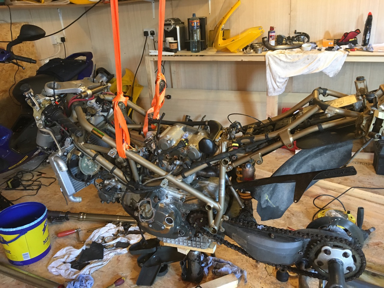

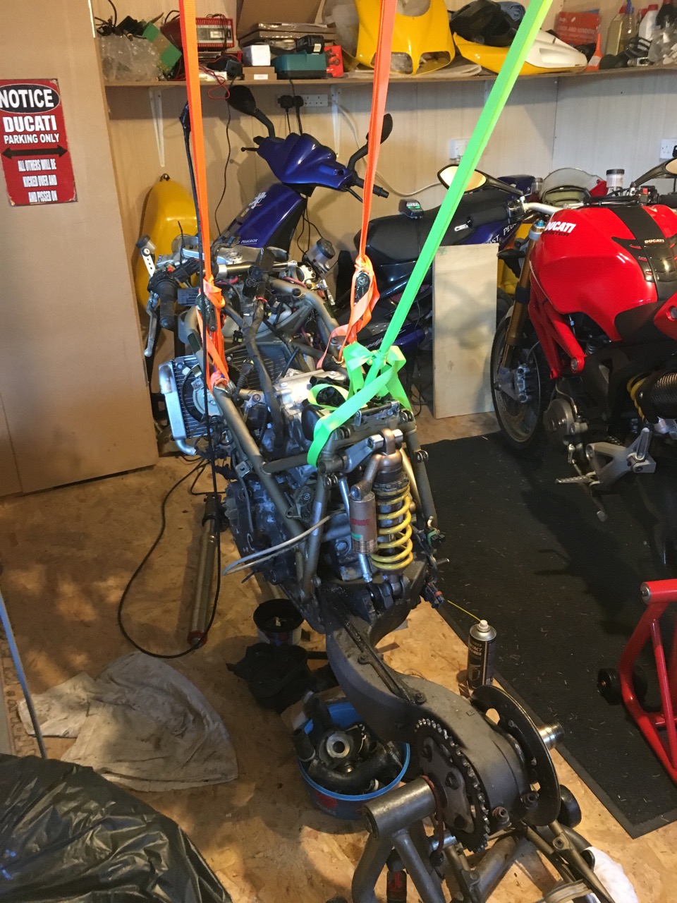

  13. When I did mine, without using a stand (although I do have paddock stands, but the rear got in the way for this job), I removed my foot pegs and flipped them over from left to right and upside down, you can then put axle stands under them. You can also have jack and wooden blocks under the engine and suspend it from the ceiling to keep it all secure and stop it falling off the makeshift stands.
    The photo below is before the footage stands went on and the suspension came out.
    I also added a 3rd strap at the back for safety.
