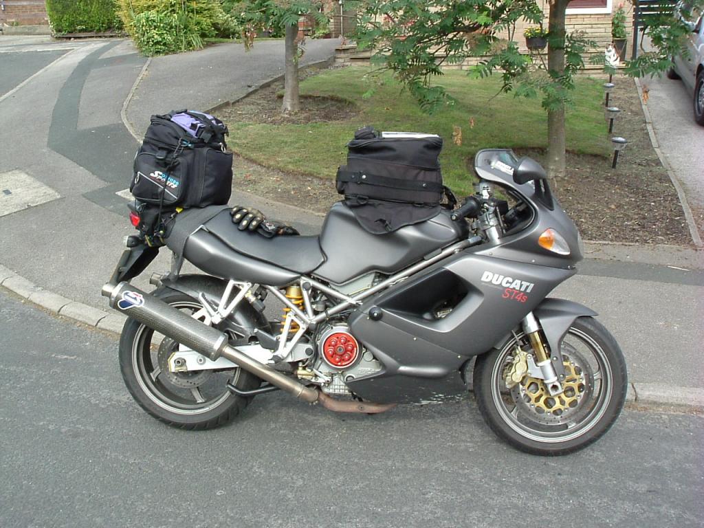

  7. Here's the bike that got me into Ducatis. Fresh from a trip to Mugello in 2004. A real wolf in sheep's clothing.
