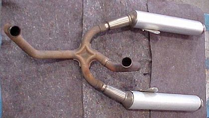

  12. Standard exhaust is fitted just different end cans.
    I’d imagine the central cross over section would create some form of resistance and each outlet would favour one or the other with the least resistance to that specific exhaust gas flow.
    The smoke is only present at the right hand side exhaust.
    Starting the engine from cold and feeling the temperature rise as the do at slightly different rates from each other throughout the exhaust system should answer which cylinder is at fault
    It is however a fair point
