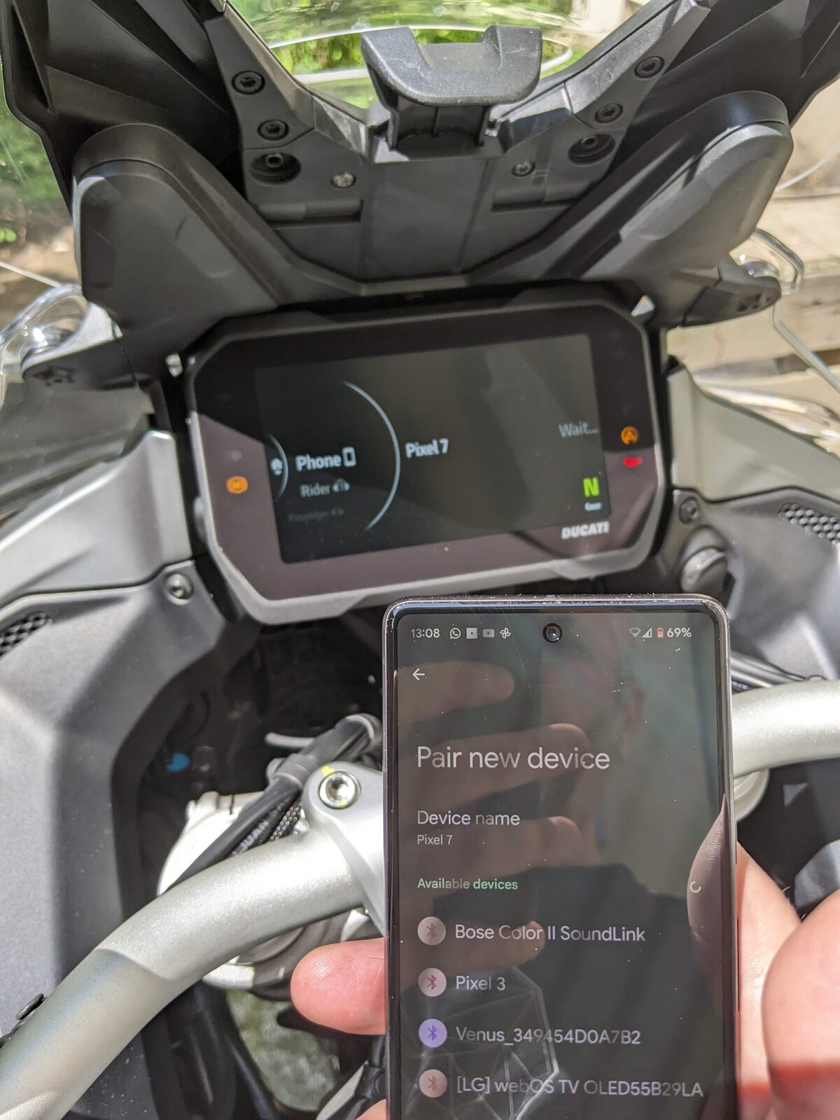

  6. Hello everyone.
    Same issue here. Google Pixel 7 is not visible from Ducati system.
    Tried to downgrade from Android 14 to Android 13 but still no luck.
    Tried to reset bluetooth connection - no luck also.
    Contacted both Ducati and Google let's see what happens...
  7. Go to the dealer. I've already posted what needs done. There is a special update in the DDS to allow the Pixel 7. It even has the description of "allows Pixel 7 phones to connect"
  8. @WyldCFh called the dealer this morning. He told me that I have installed all the latest updated. He does not specify any special updates for Pixel 7. I'm going to write a support request on Ducati official.
  9. Unfortuantely, I do not have the info for the update as my dealer did not charge me for it. But I stood there and watched them install it and as soon as it was done my Pixel came up instantly.
    They need to look a little harder
  10. YES!! Finally I got it!
    @WyldCFh you are right: there is an "hidden" update related to Google Pixel.
