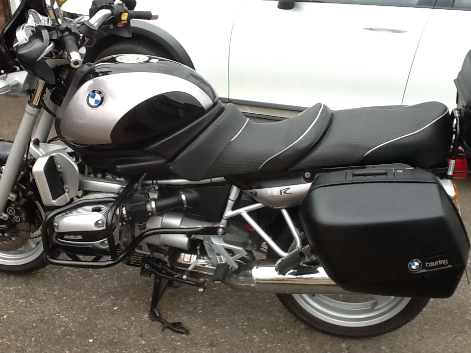

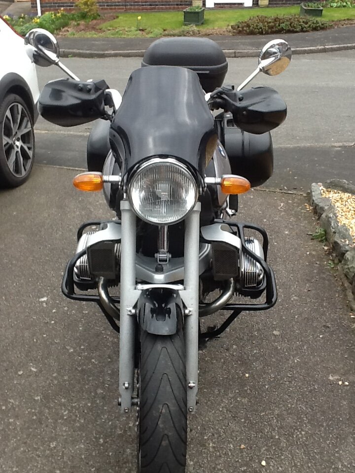

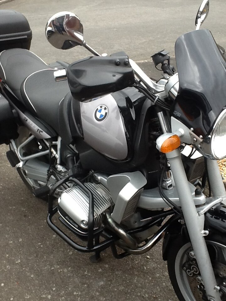

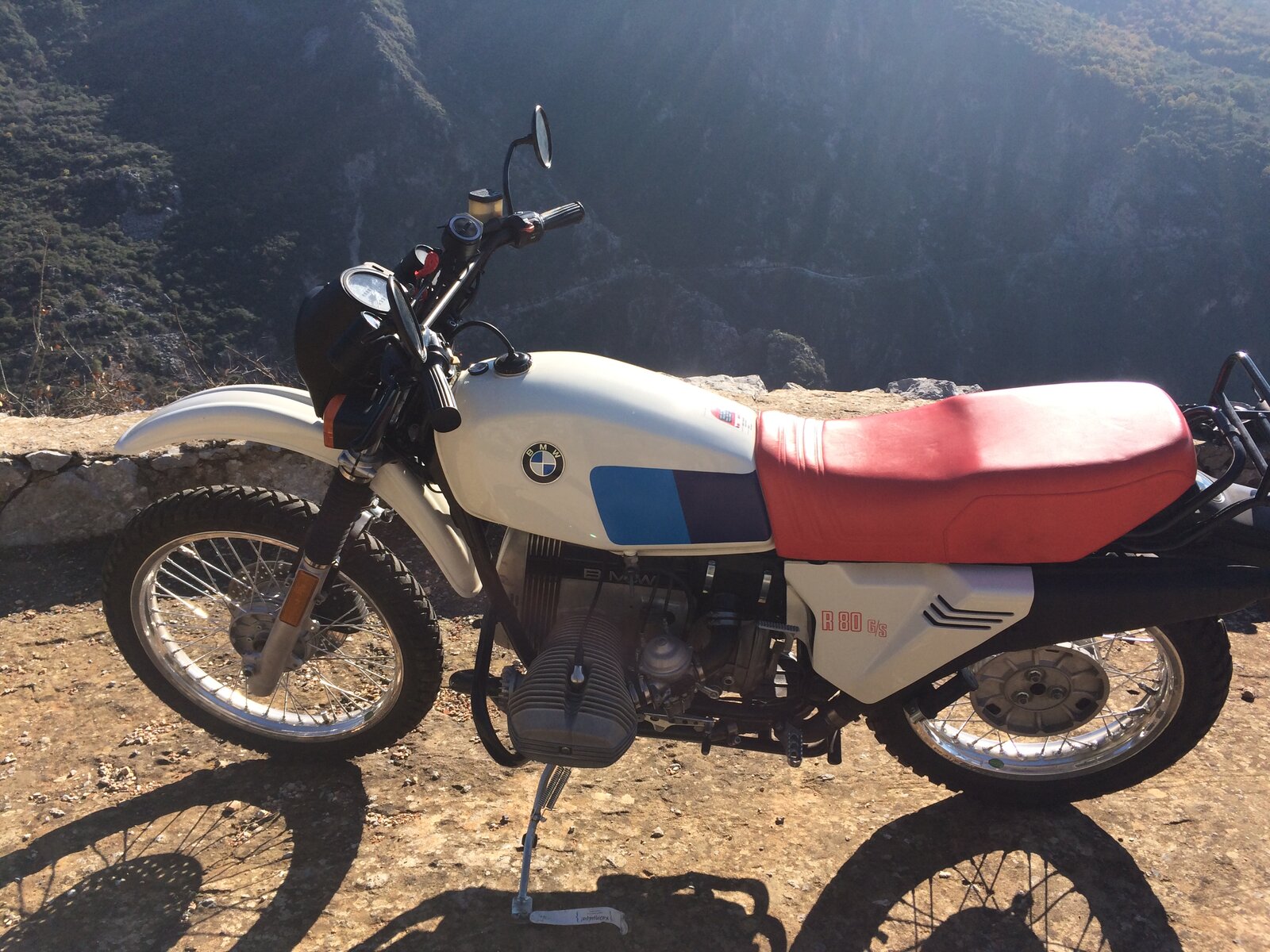

    My keeper, maybe. 58k, RT exhaust so I can fit full size panniers. Corbin matched seat. Full engine bars hand guards Cruises all day. Mint and light enough to enjoy.
    Had R100 RS, RT, two R100GS. R65, R80. K1100. 1150 GS. R90S for 10 days,rebuilt gearbox and flipped it for a £1500 profit should have kept that one. Love the old boxers.

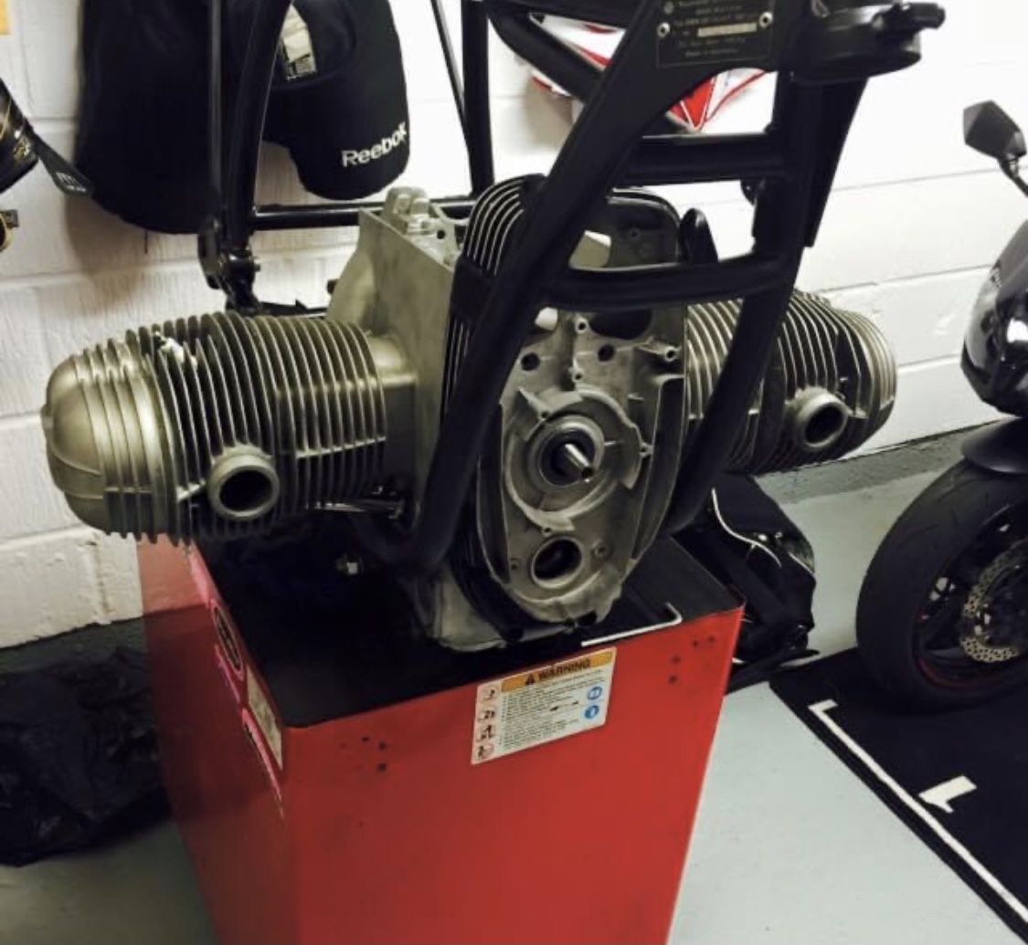

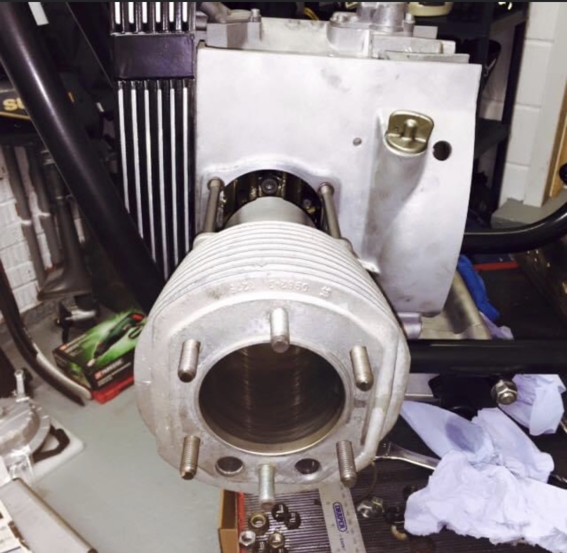

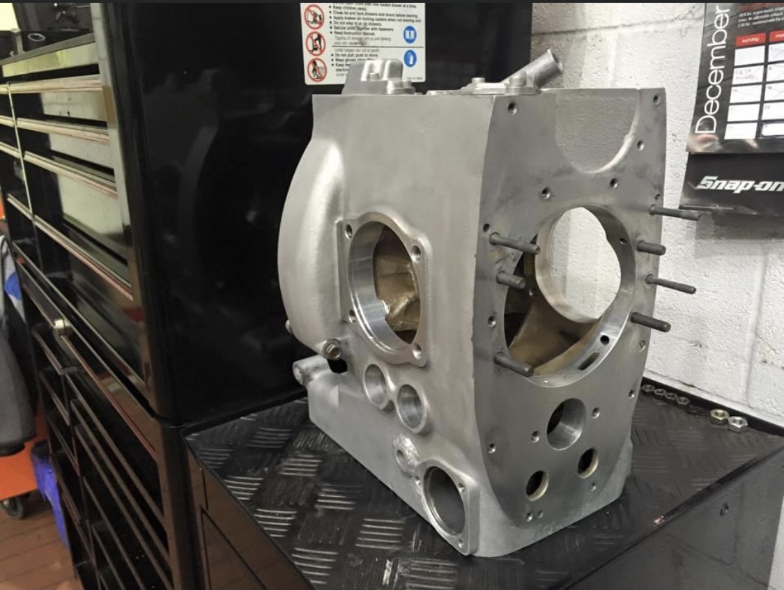

  5. View attachment 238471 So one thing lead to another..... I had to remove the engine to have the frame powder coated but the front engine mounting stud was seized solid in the engine. After almost 2 weeks of heating and trying all types of penetration oil including a home made mix of ATF and acetone, I resorted to cutting the stud to remove the engine.
    So I took the engine to a local machine shop to have the stud drilled out. It’s around 12” long. Picked the engine back up and decided it would be a good time for a full tear down to a bare block.
    Media blasted the engine block, quite happy how it turned out.
    #25 James85, Apr 15, 2021

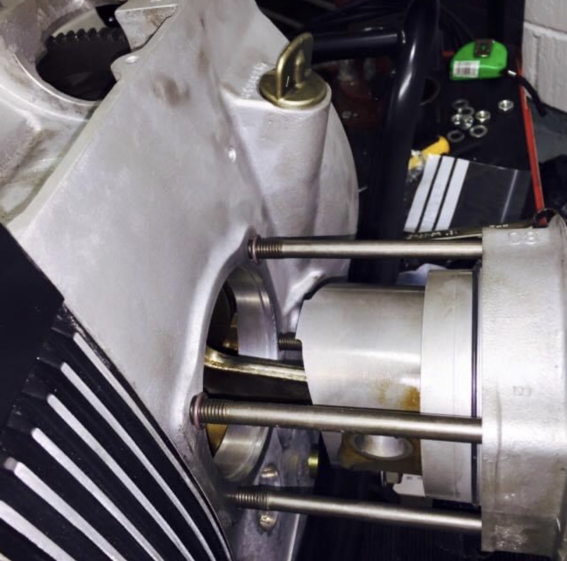

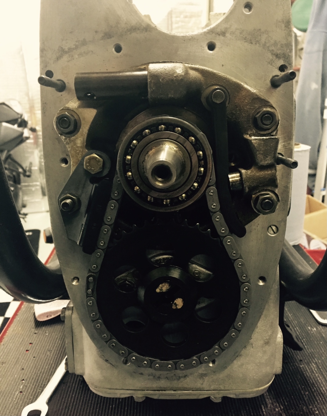

  6. Bottom end rebuilt, all new bearings, shells and seals. Oil pump inspected ok and refitted. New timing chain and tensioner. Sprocket teeth were like new even after 30,000 miles
  7. R80s where good for 80k min if oil changes followed the 3k oil 6k filter change. Seen one with double that. Over engineered, under stressed simple motors.
    Get a move on, no slacking now:)
  8. Surprised the timing chain is clipped together, would have thought it would be riveted?
  9. They were normally split link across the range. Not sure from 1100 series on. Makes fitting far easier across two fixed sprockets. Limited adjustment by the chain tensioner. All heavy duty on a 50 bhp motor. Love em!
  10. Seriously over engineered !

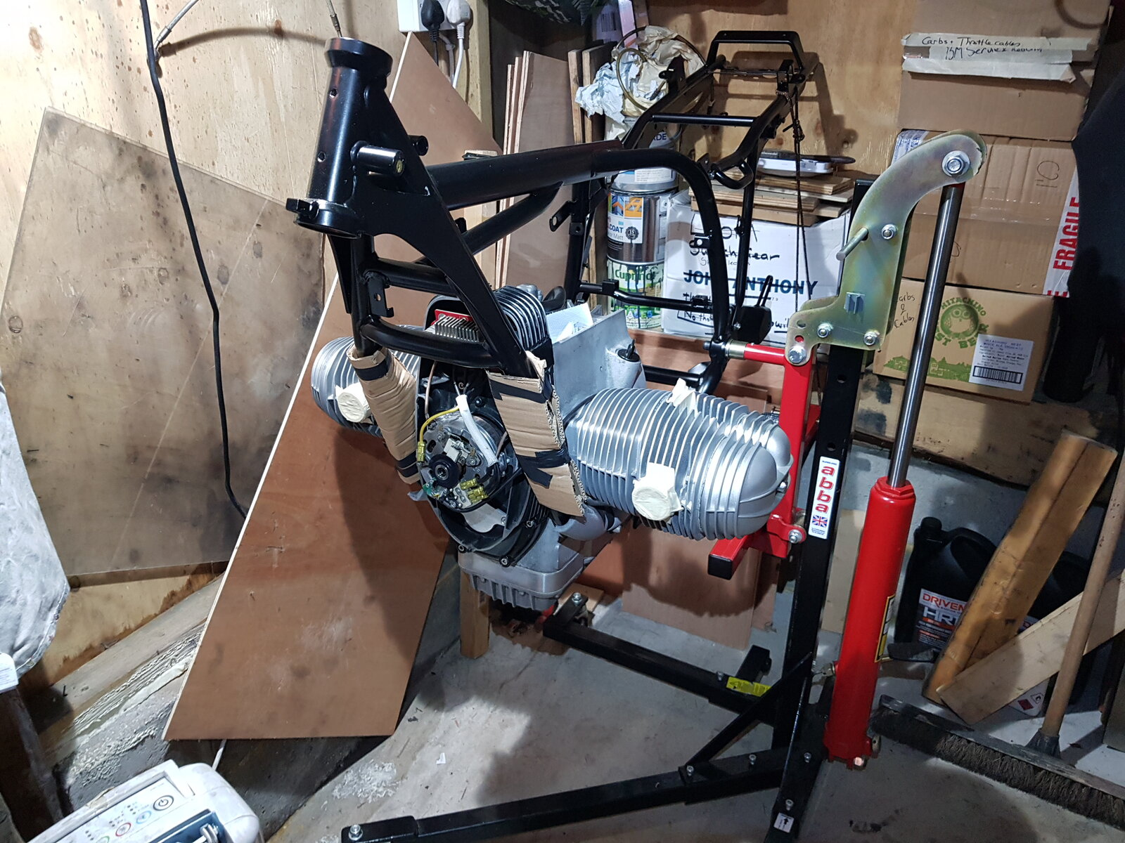

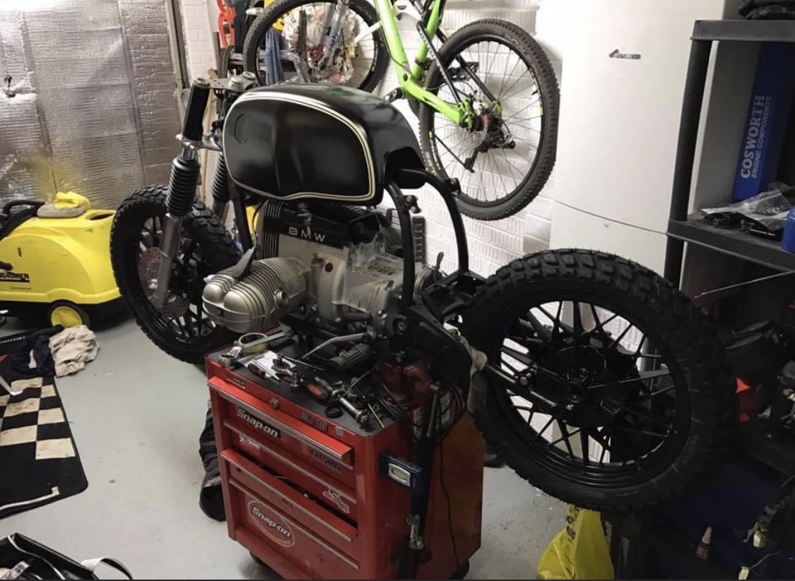

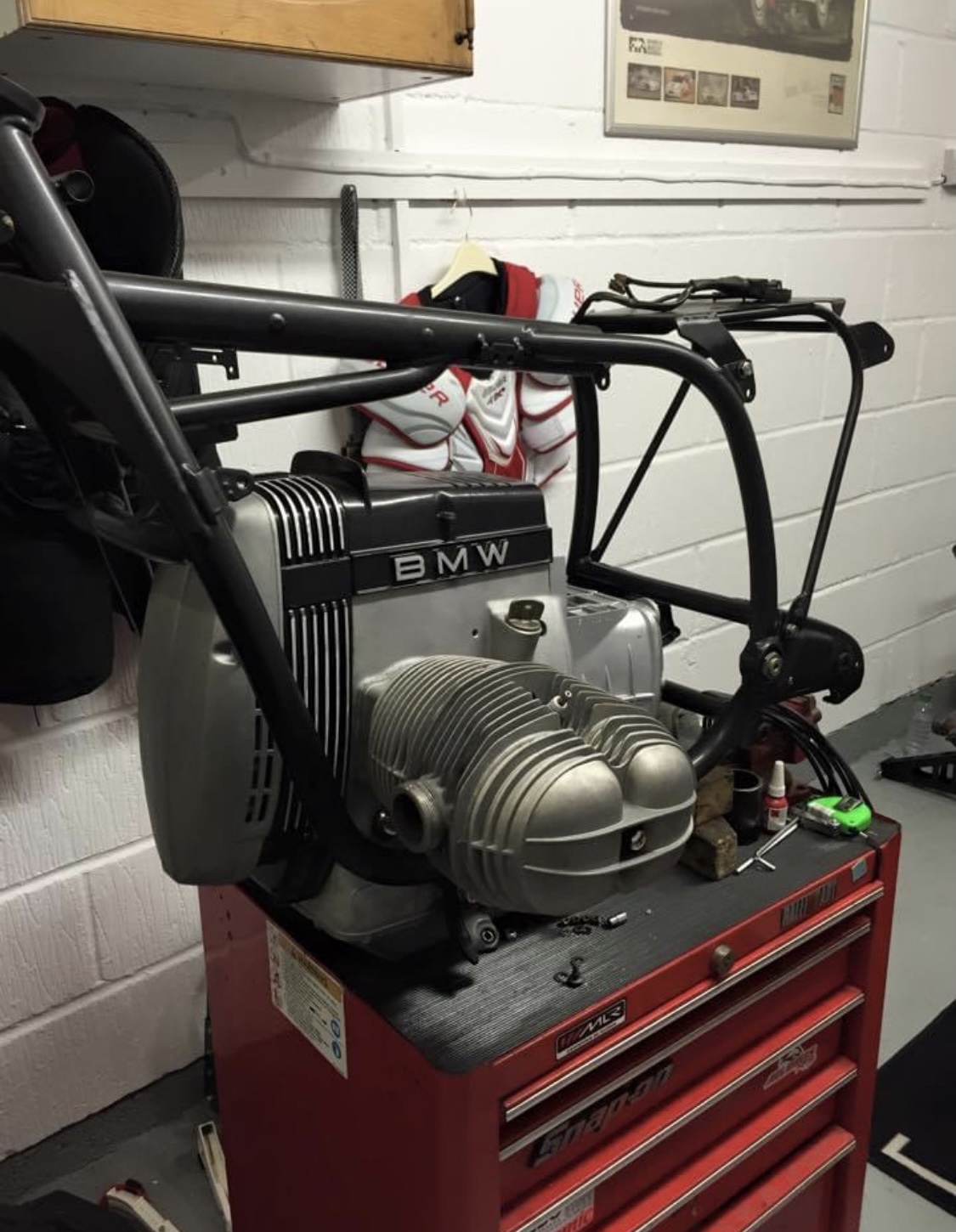

  11. Engine block back in the freshly Powder coated frame. Barrels and cylinder heads fitted. Timing chain cover power coated then sanded. Really starting to take shape. 2B24DF23-9658-4F5F-B0B9-514A063ACF56.jpeg 573DC775-ABF8-408C-9278-048BB887AFEF.jpeg CBAFC411-E2D8-493A-B726-BBCAF9BF8E67.jpeg 64E6991B-6405-4335-9EF2-230A6EE3441D.jpeg CEA2945D-04E4-45E2-A36F-1B2A0E59A474.jpeg

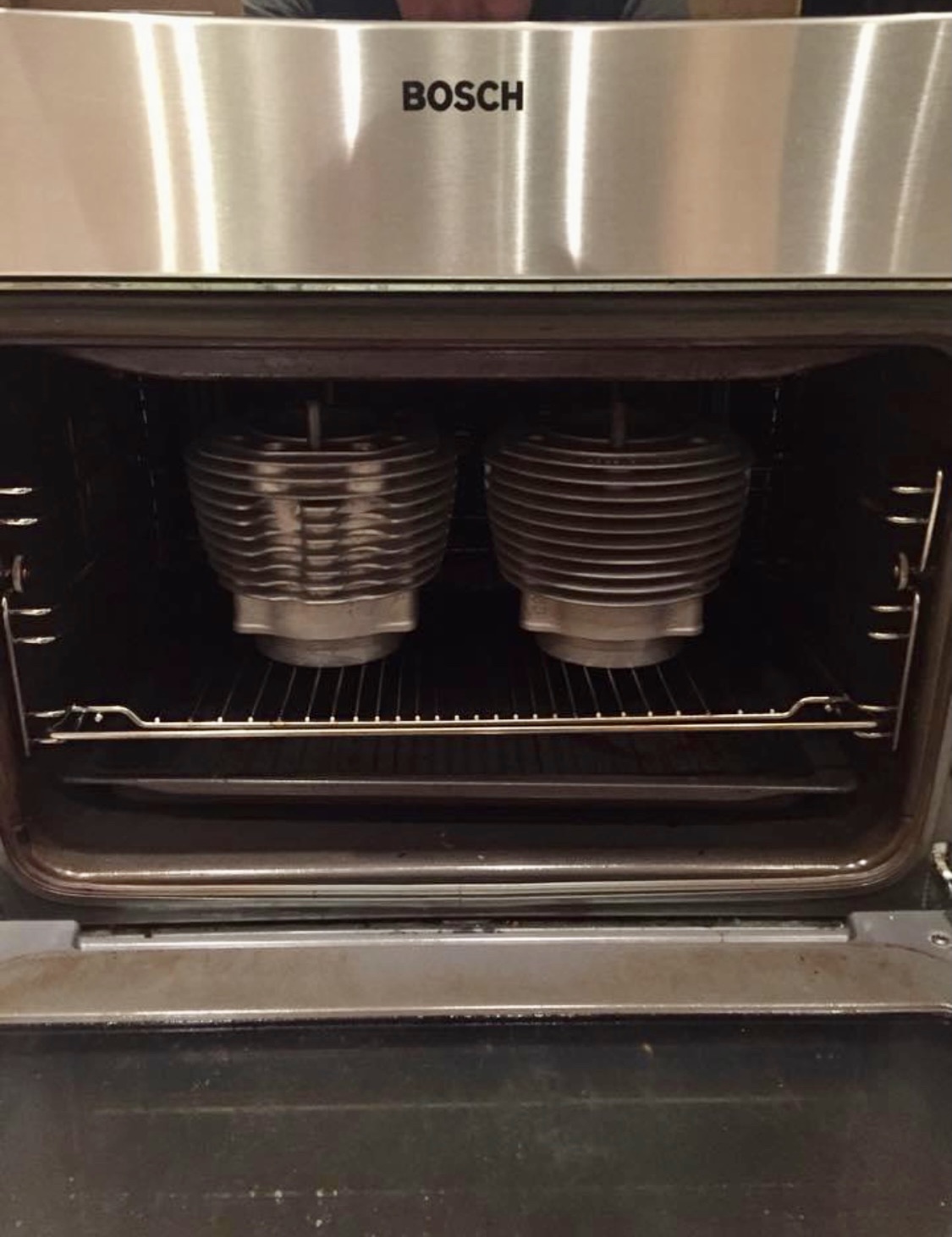

  12. 07D6F3D9-D461-4439-A02E-EB768C1A0C00.jpeg Turns out I do know my way around the kitchen. Oven set to 200c to expand the cylinder barrels to allow the replacement stainless pushrod tubes to be fitted. The tubes have been in the freezer overnight.
    This is also around the same time I realised the dish washer is basically just a parts washer

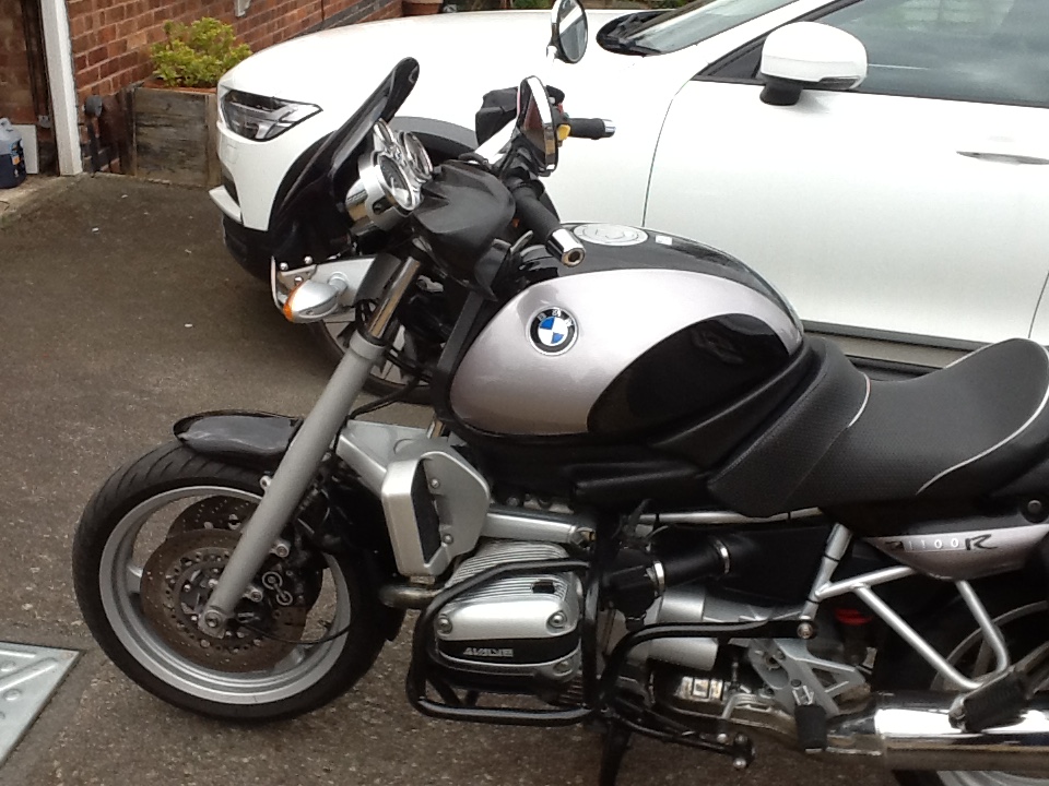

  15. Love airheads. Part way through my R100R rebuild. Was set on fire so using it as an excuse to upgrade pretty much everything.

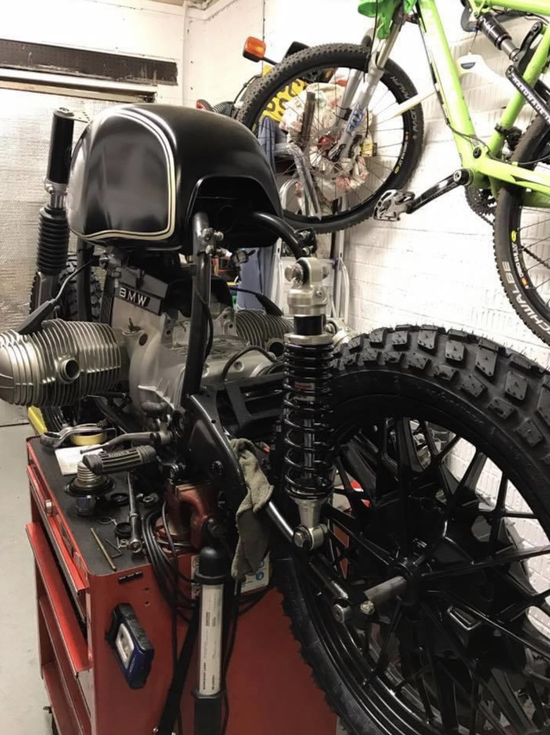

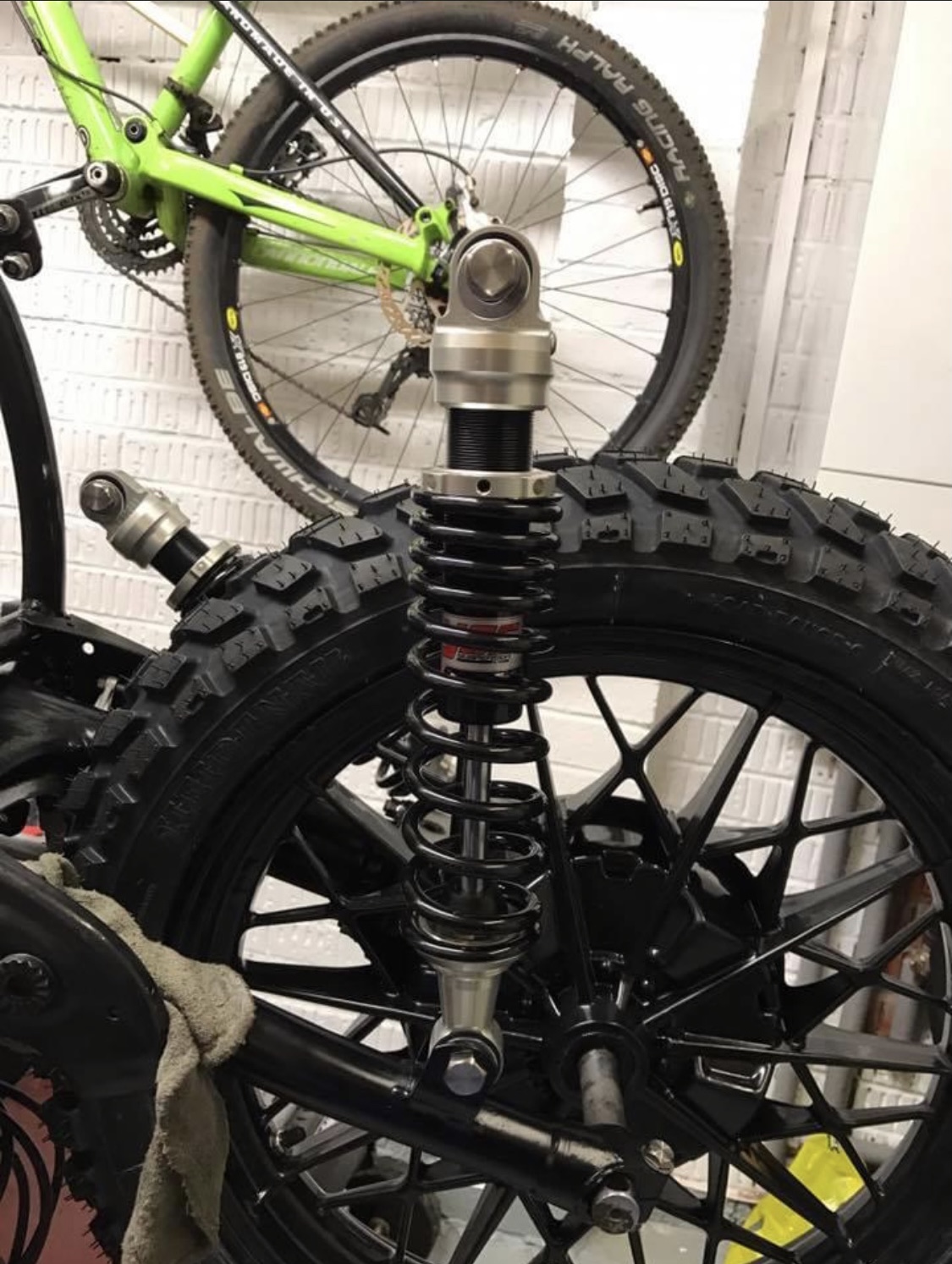

  19. Wheels/tyres and suspension on.

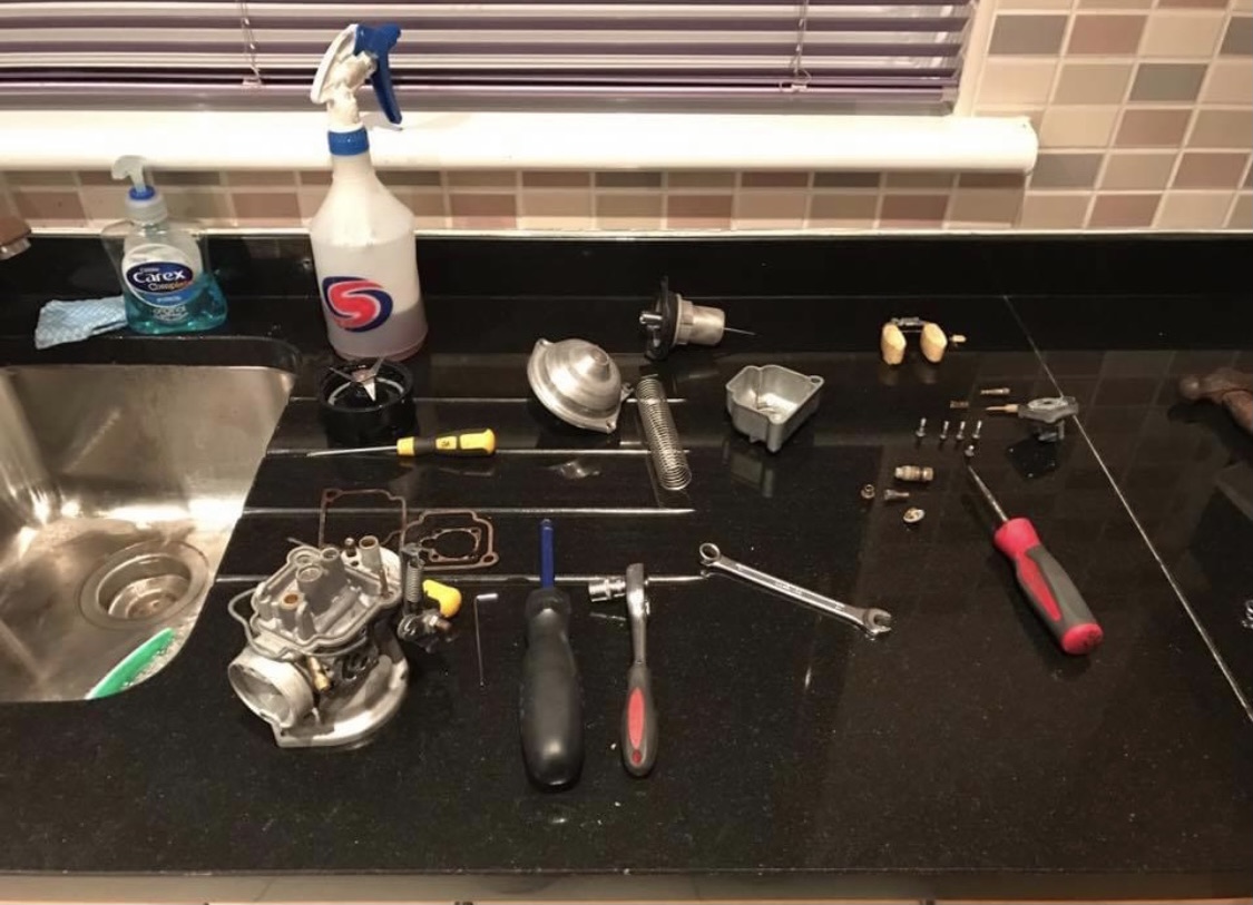

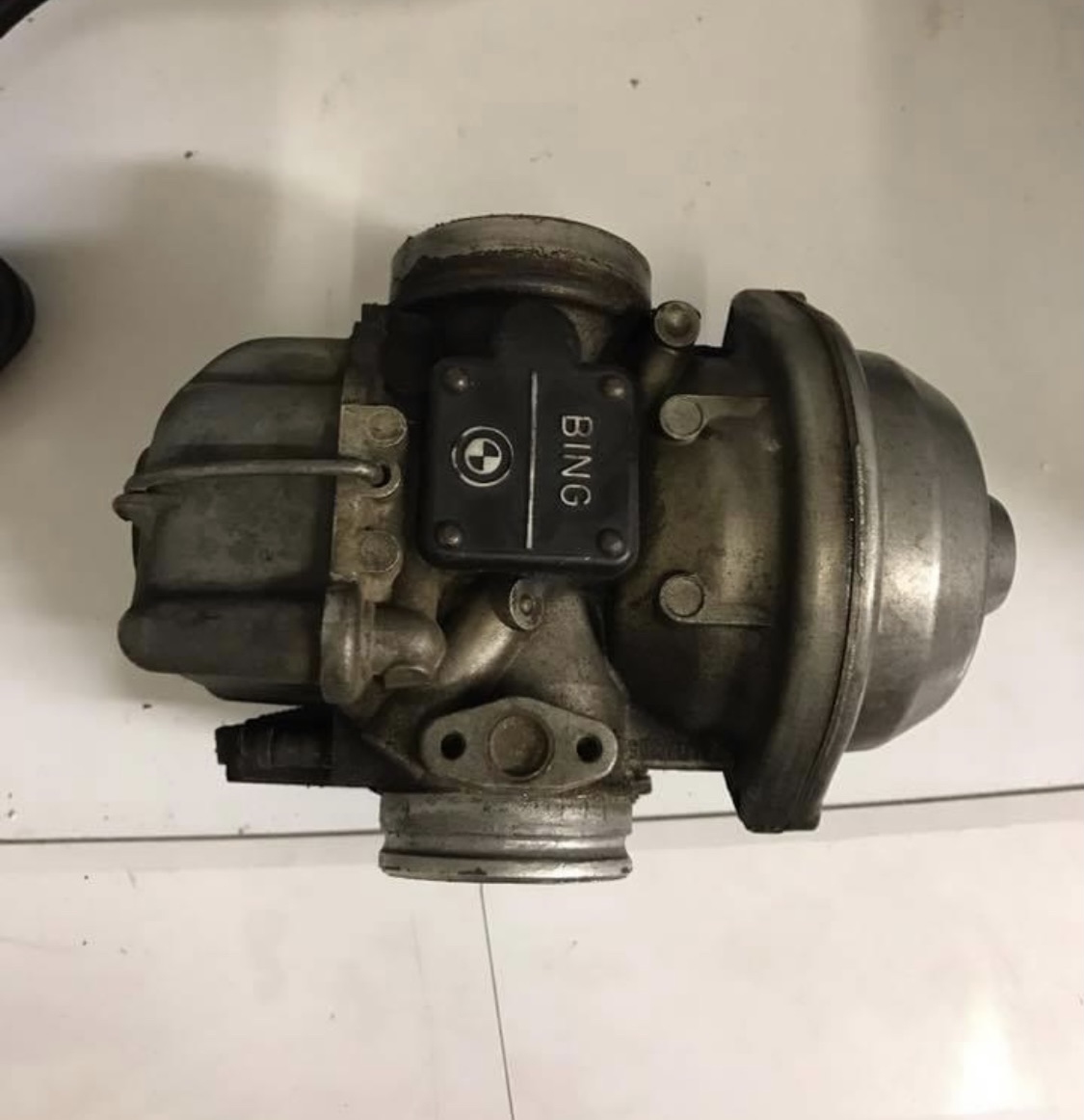

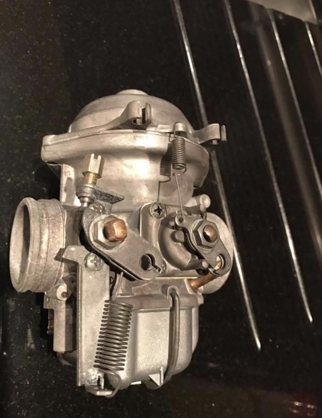

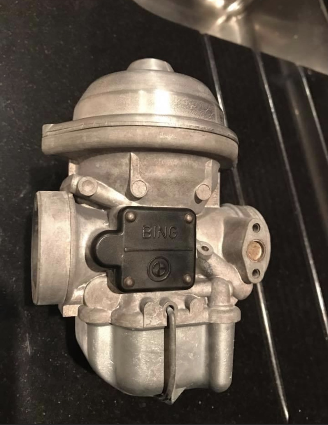

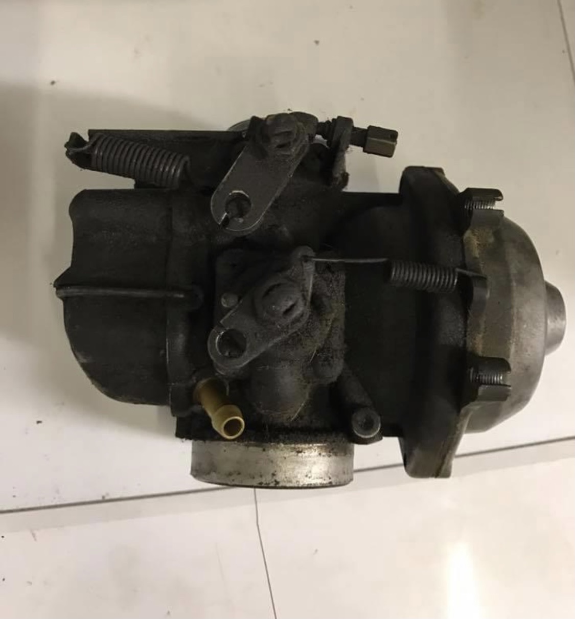

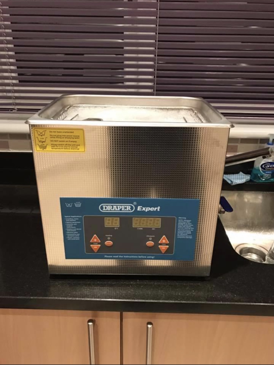

  20. Some ultrasonic cleaning of the slide carbs.
