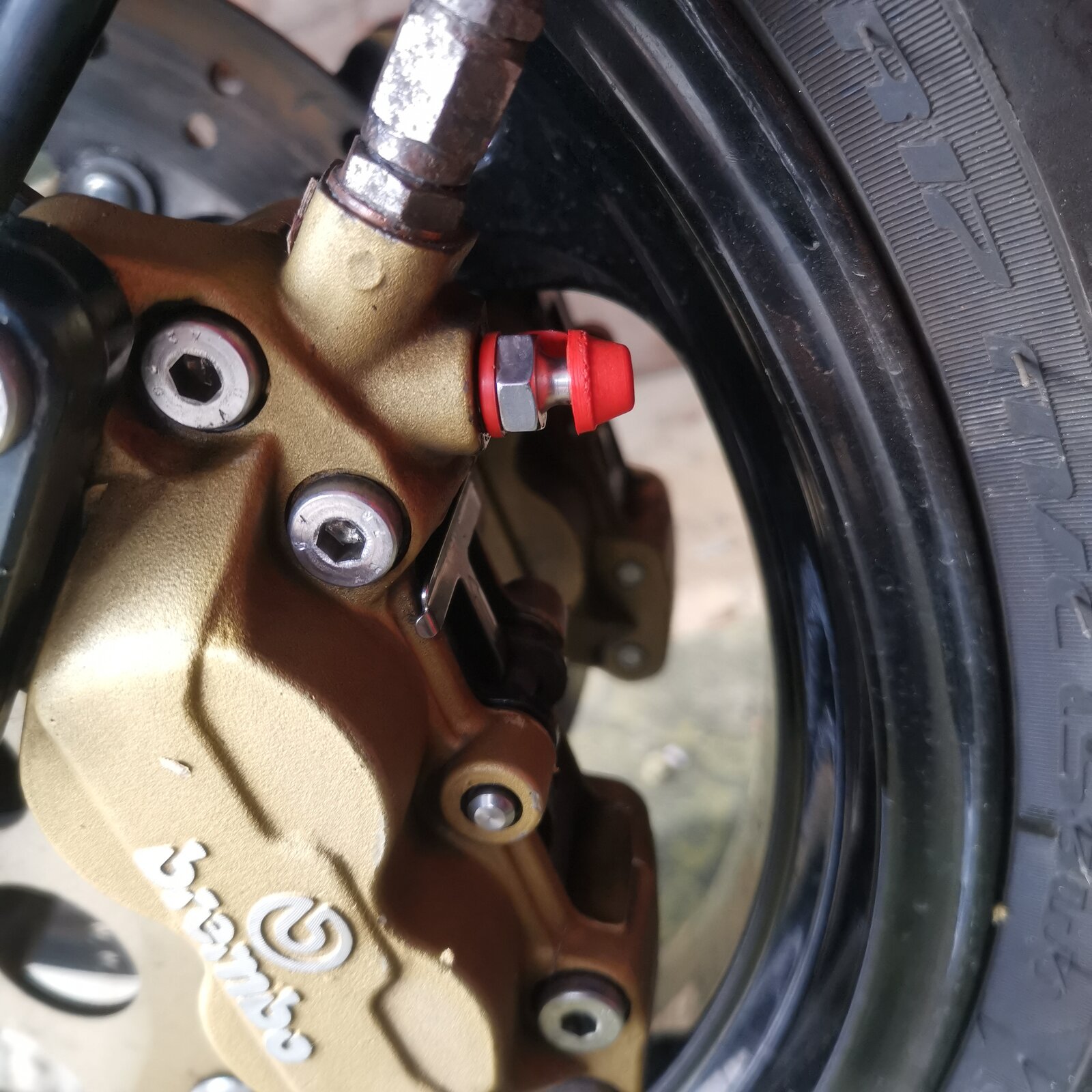

  6. One final thing I have just found. As you can see from the photo I have replaced the banjo bolts and bleed nipples. When the bleed nipples arrived they were all M10 x 1.0 which is fine for the rear calliper but too big for the fronts which need to be M8 x 1.25.
    When I spoke to my supplier they said that they were relying on information provided by Hel. So I put it down to misinformation but if you look at the torque settings in the Ducati workshop manual there is only one entry for bleed nipples and it refers to them in the plural. So Ducati got it wrong.
    Also when ordering parts do not rely solely on the part numbers, always describe the part you are after as I found that the part numbers for the front indicators were transposed. Ducati wrong again.
    Caveat Emptor o_O
    The 10mm blead nipple fits the earlier calipers.
    Steve
  8. Billy don't confuse Brake Bleed Connectors or Bleed Unions with Bleed Nipples, they are not the same thing. In the Factory manual for my MY02 748 for example the torque settings page for the brakes clearly shows a different setting specified for the nipples (which on my bike are only 6 and 8mm) and for Bleed Unions (which are 10mm x1mm) Although I would never use a torque wrench on a bleed nipple anyway. It looks like the bleed nipple sizes are MY and type specific. The factory manuals are also reissued for each model and MY, often updated through the MY based on factory part supply changes so the settings/thread specified in the book needs to checked against the part. As you suggest, the only safe way is to measure before buying.

  9. Denzil, definitely no confusion. You can see from the extract above they use the terms brake hose connectors and brake bleed connectors, the word nipple is not used (how many posts is that going to generate?).
    As for currency of my Workshop manual I bought my machine the October of the MY and didn’t purchase the workshop manual until the following year.
    When I reported the error to my supplier they were able to see if this had occurred before, it had, twice so hopefully they will now amend their system accordingly.

  10. I hope they will fit a 748 916
  11. 2001 900 SSie front calliper bolt is M10 x 20 x 1.25 (metric fine) despite the Ducati workshop manual telling you that it’s 1.5
