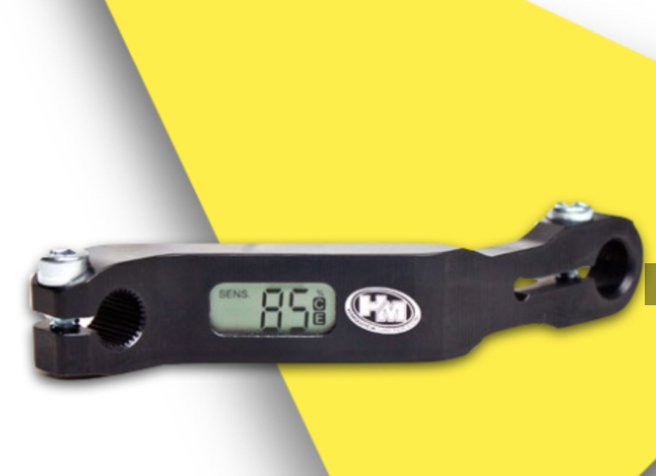

  9. Still waiting on HM replying after sending them loom pictures which they hope will show that the loom isnt their part. In the meantime, I've sent a return request to the latvian ebay user "peglob-0"
    who sold the shifter, beware that one. Its a lever type shifter, not the rod type sensor.

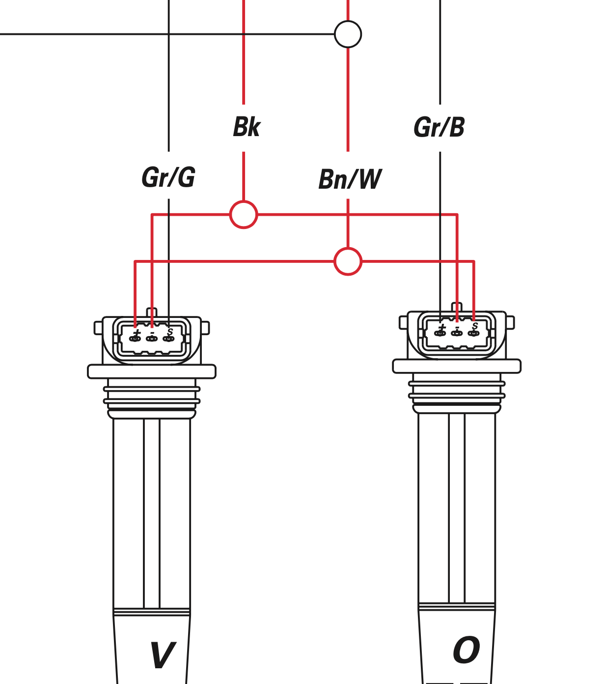

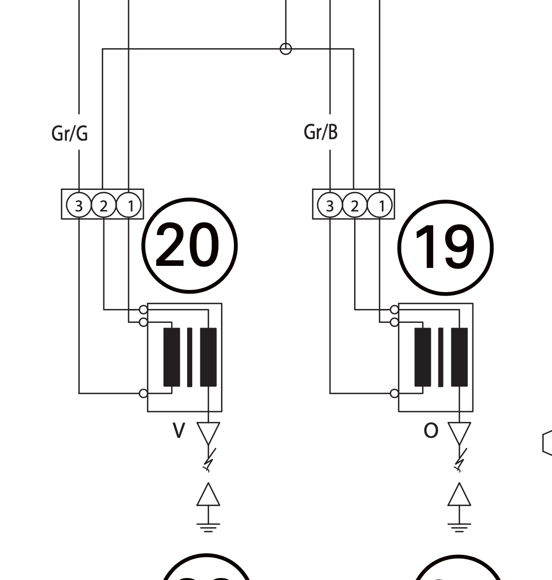

  11. Came across this anomaly in the wiring manual between 749 (top image) and 848/1098 (bottom image) coil installations....wonder if it has effect on QS operation? Screenshot 2020-10-06 at 09.00.21.png Screenshot 2020-10-06 at 09.00.54.png
  12. Thx Paul, I have a couple of pink injectors but they pour fuel in and choke you without remapping! lol... So far I've run this morning without seals in the coil couplings and it seemed to run ok, I refitted the seals and it still seems to run ok. Time to put it back together and try a run.......
