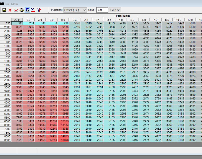

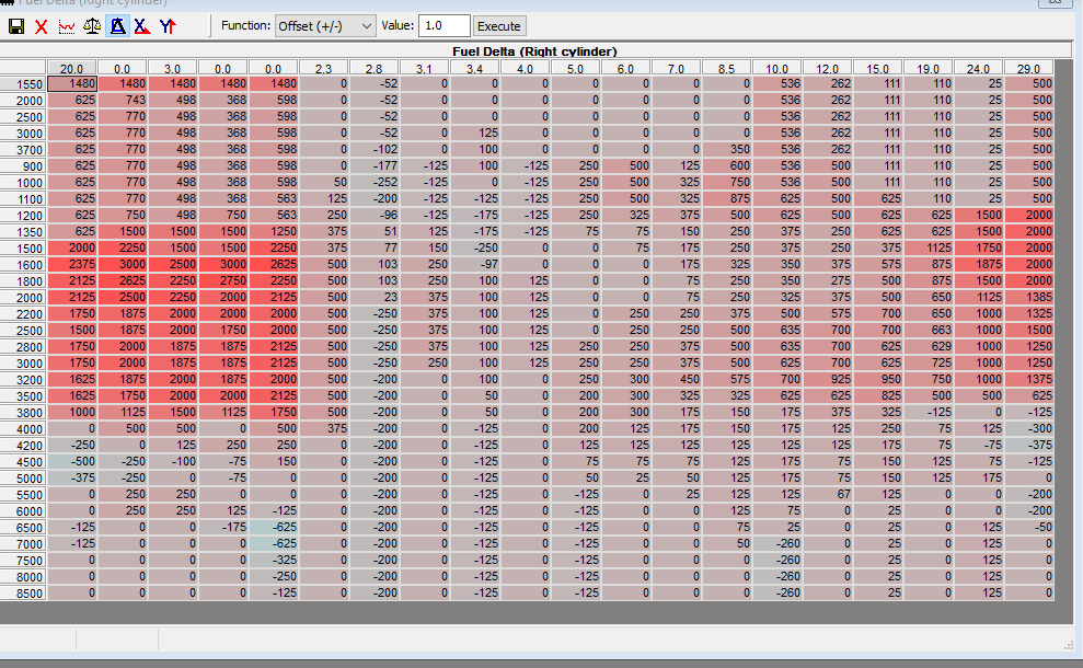

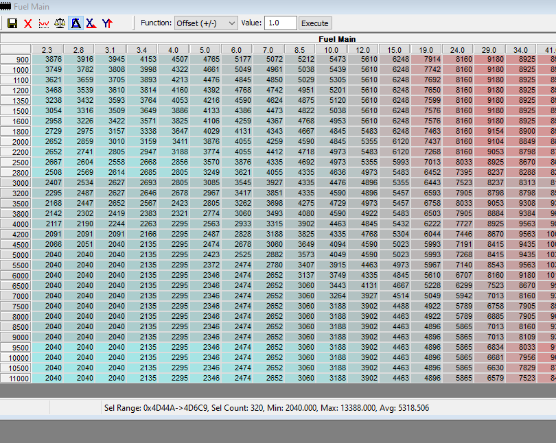

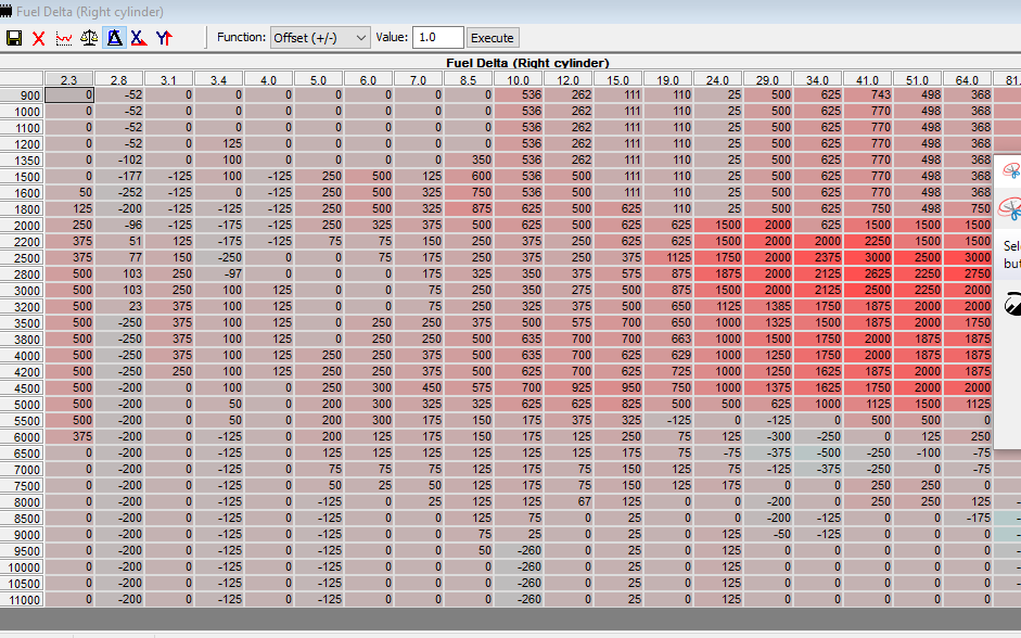

  9. I had some serious thinking today and went out with the laptop...
    I took the .bin files from my phone and imported them into tunerpro using a 749hex file.
    What I found was the map that was used on the dyno and the road UP UNTIL THE QS was installed has some serious erros V's the 999 map I'm using now..take a look at the images..
    First up the good main fuel and rear cyl fuel diffs files;
    Then the BOOOMING map tables...
    These explain a lot.....!!!
  10. So, given the above, I cant explain how the corruption took place there.
    I then took @SHarper advice and went back to basics. I left the working file alone in the ecu and reset the TPS and both idle screws. I thought I had some CR9EBs but only one kicking around. I looked up the NGK tables for the CR9EIX's I have and was quite shocked that they are advocating a gap of 0.6mm which is small compared with the extended gaps found in various recommendations. NGK must know best especially as I'm troubleshooting here.. I gapped and fitted those and opened the bleed screws 1/2 turn each, pressed the starter and cracked the throttle a fraction, she fired into life and warmed up at idle to 90 C with no more intake popping or backfiring. What a result, its been weeks of work and cursing, she needs a we run out to be sho to be sho, but I'm extremely hopeful and happy at the warm up lap!! Thanks to all for suggestions and pointers. I'll get the CO adjusted when the opportunity arises. Just the horn low volts to trace and she'll be roadworthy again. :blush:..:sun::beer::beer::beer:

  13. Also FYI...
    I had the exact same 'corruption' issues using tuner pro, turns out the XDF's i had were wrong, i bought one from Old skull tuning and everything is exactly as it should be now
  14. Rather than looking at the fuelling maps try comparing the ignition timing maps between the 749 and 999.
