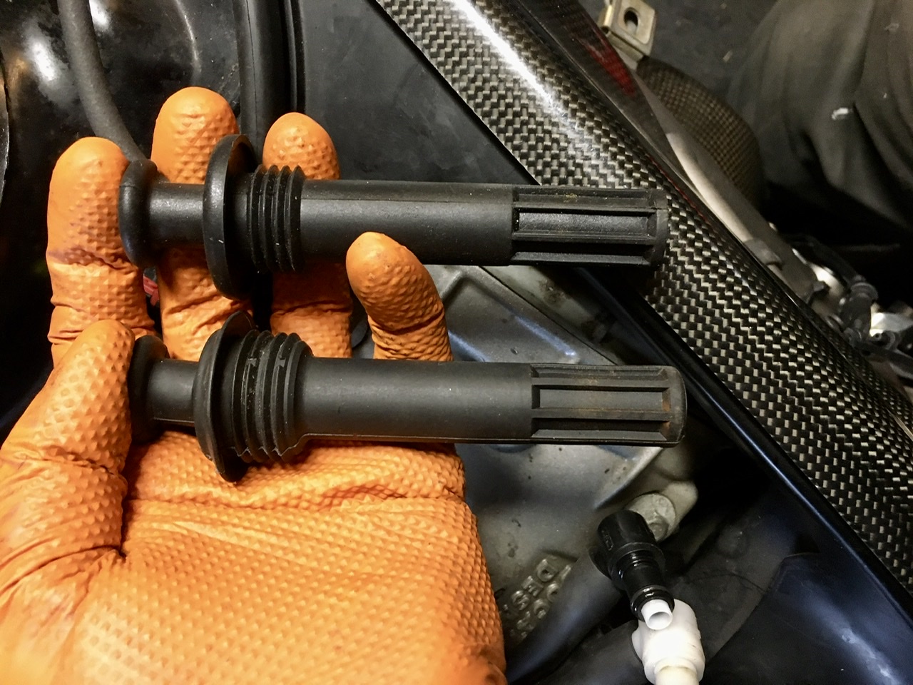

  12. I’ve got both spark and fuel. These spark plug caps, they don’t seem to reach to properly clip over the nipple. They’re the oem ones but I’d rather feel a solid click from them.

  15. Are your HT leads and caps OEM or has someone replaced them with another part? I had a situation with a misfire on my 998 when it arrived, when going through the process to uncover the fault I discovered the previous owner (or most likely a mechanic) had saved money by buying a car part, probably off a Fiat. At £90 for the OEM HT lead I’m not surprised. However, the non-OEM one was very slightly shorter, just a couple of mm or so which meant it wasn’t making a secure contact with the plug but merely resting against it.
    OEM from the other cylinder at the bottom.
  16. Thats exactly my concern Paul, but theyre oem and have been on the bike all the while ive owned it (20+ yrs) and have the elephant moniker on them.
  17. Not meaning to confuse things, and can’t give you a timescale, but Ducati did fit Fiat/Lancia plug leads as OEM at one time, these were identical part number to those fitted to Integrales etc at the same time.
