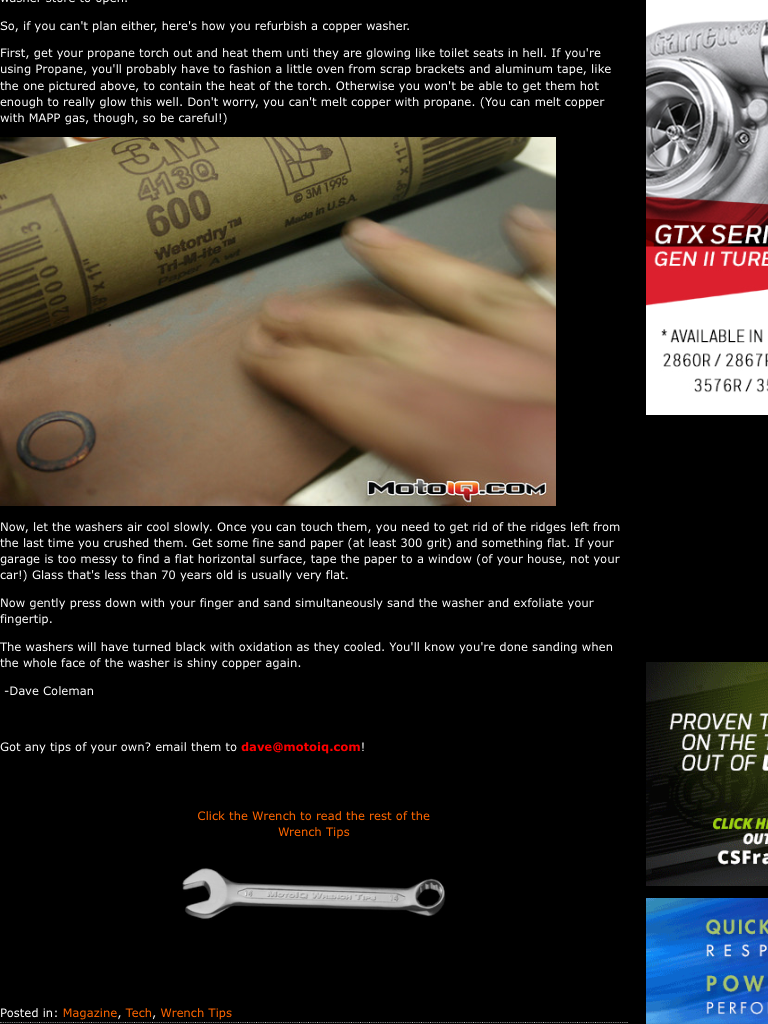

  1. That's some lighter your using if your going to heat copper until cherry red,I wouldn't quench with water either that will harden the metal,you want to let it cool naturally so that it softens,that way it will give a good seal,

  3. Yeah! How do you think I feel,I have just tried to heat a copper wire with a lighter! Ive now got a sore thumb,no gas,and a burnt finger(it didn't go cherry red,but hot enough to turn my skin white)whiskey ehh!

  6. Oh my head. Yeah sorry about that mate, next time hold the washer with pliers and use a rubber band on the lighter or a Zippo! :Muted:

  8. But given the cost of new washers why mess about with heating them and quenching or not quenching them - in my experience the important bit is to get the temperature / colour right.

    As far as why mess with old washers, usually you wouldn't but heating an old one up to soften it a bit can get you out of a situation when there are no new ones to hand.

    Seems there's other opinions out there,I heat and cool naturally,it has always worked! The reason I do this I find the original washers are a better fit and thinner than after market ones?
