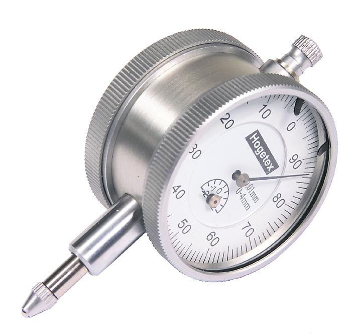

  17. just went to a pro and he measured the discs with a clockmeter
    there was a offset of 0.3mm.
    I dont know the allowed offset of the OEM discs, but he things that 0.2mm offset is the maximum and higher than that, discs should be replaced.
    BTW, he also experienced the vibrations.
    And he thought the speed they were felt was weird, since it only appears at high speed braking, not a low speed breaking wich is typical for warped discs...
    But does anybody here know what the offset numbers are for the discs?
    He will start to replace the suspected disc and replace that one.
    We'll see if that will cure the issue.
    The discs is being ordered.
    Normally I'll be able to share an update next week from now..
    #39 Riko, May 31, 2017
  18. to continue
    the mechanic used this clock to measure if my break disc was warped:
    while turning the wheel, we read a difference of 0.3 milimeters.
    this is with the tool at the surface of the disc, where the brake pads touch the disc.
    Alternatively, he also measured the disc from the top, at the border of the disc, like so:
    Normally, discs arent measured this way, but we did see the difference was huge!!
    Much more than 0.3mm! more like 0.6-0.9mm..
    Mabye that difference caused the vibrations at specific higher speeds...?
    Because imagine the pads touching the disc while its moving up and down?
    I can imagine that must give some feedback to the handlebars in some way...
    But fact is, I am not experiencing normal warping = vibration at LOW speed.
    I get it only at high speed braking!
    We are still guessing, and we are gonna change that disc to see what will happen.
