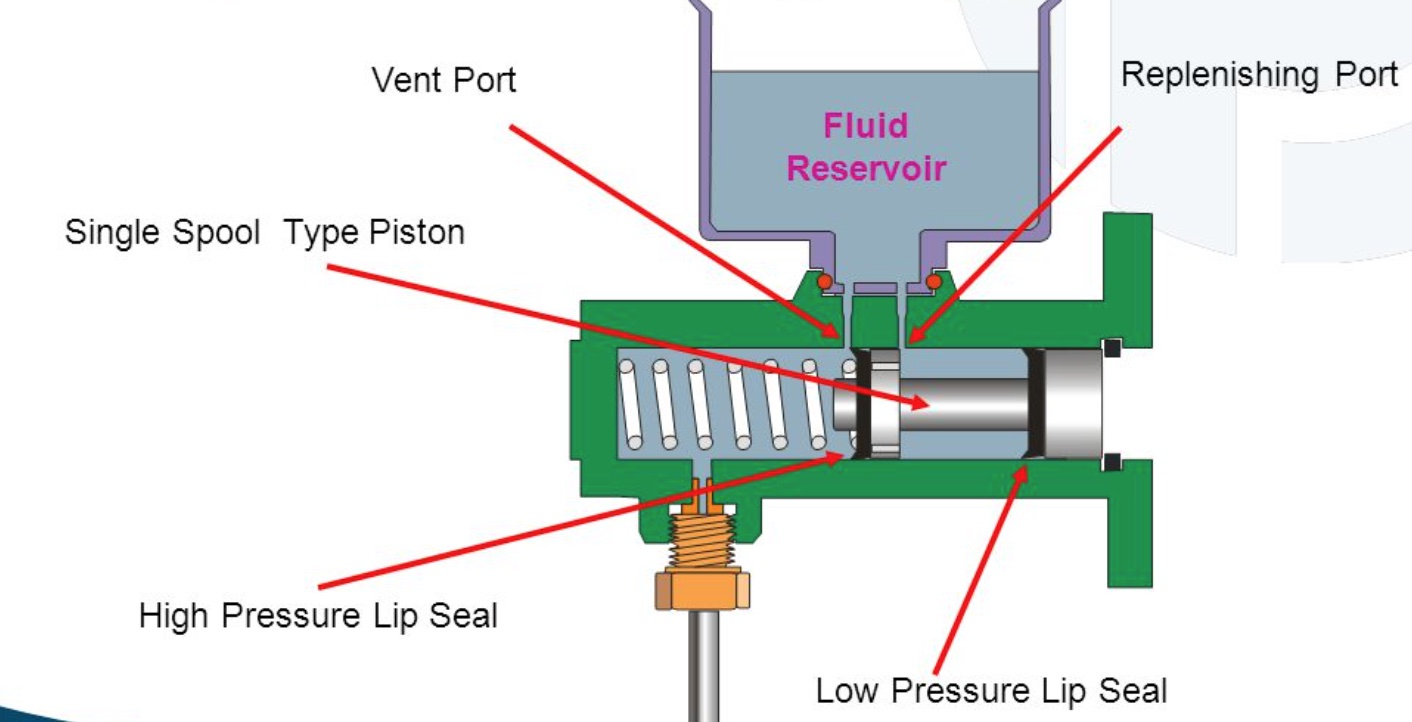

    The important thing is to check for some free play in the lever
    . The lever should move 5%–10% of its range of motion before feeling resistance at the lever. During this range of motion you should see a squirt of fluid into the reservoir. No squirt — either the vent port is plugged or there is no free play.
    As the brakes are applied the piston moves forward with the lip of the seal covering the vent port. Before this port is covered, piston motion forces excess fluid back into the reservoir. So, if you look into a reservoir just as the piston begins to move you will see slight fluid motion. Once the vent port is covered, fluid trapped in the hydraulic system cannot escape. Beyond this position the piston moves fluid to apply the brakes.
    If the piston is positioned incorrectly such that the vent port is covered and there is no free play at the lever, when the brake fluid heats up and expands during normal operation, the fluid cannot compensate for the increased volume by returning back to the reservoir, and instead, pushes the caliper pistons and actuates the brakes — locking them up, perhaps inconveniently and unsafely.
    Once the fluid cools and contracts, the caliper pistons can then retract and the brakes are released (until next time).
