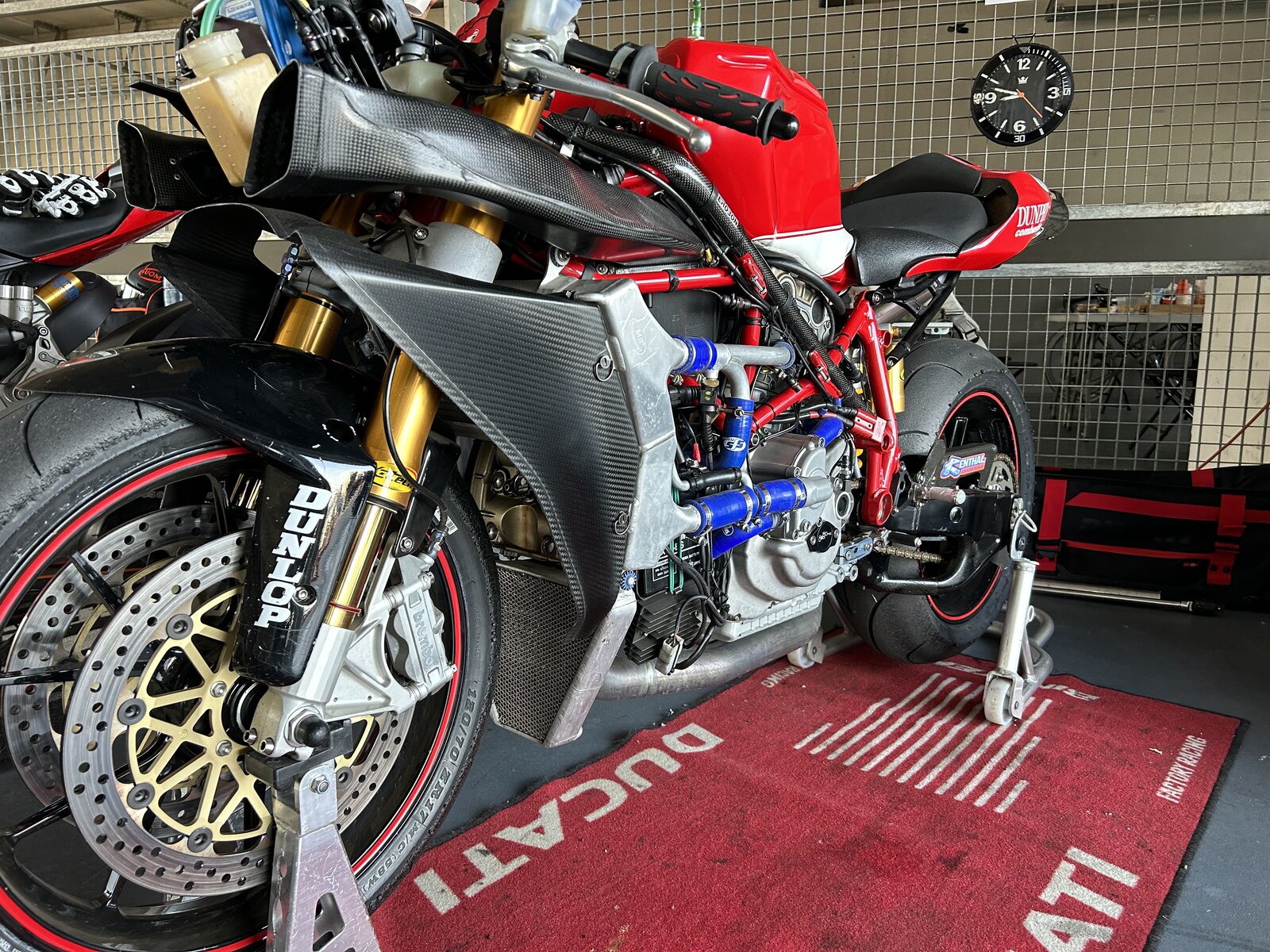

  16. Here is my 749 set-up with ZO4s, race line set up, but standard 749R MC.
    Shod with Dunlop 213s the brakes are epic as you might see from the compression at T14 Aragon.
    I just applied harder and harder brake after that, then had to add more pre-load and compression.
    Looking for an RCS19 for that extra feel when the rear gets a bit flighty.
  17. Looks like you still have a good few mm of travel to play with there @Paul55
    I haven’t got a photo like that but my fork travel indicator shows similar/greater. Those Ktech internals are really great for feel!
  18. By the end of day one the preload and comp needed four turns and two clicks to prevent the bottoming out.
    BTW, the telltale will never reach the bottom, 5-10mm from the bottom is normal.:D

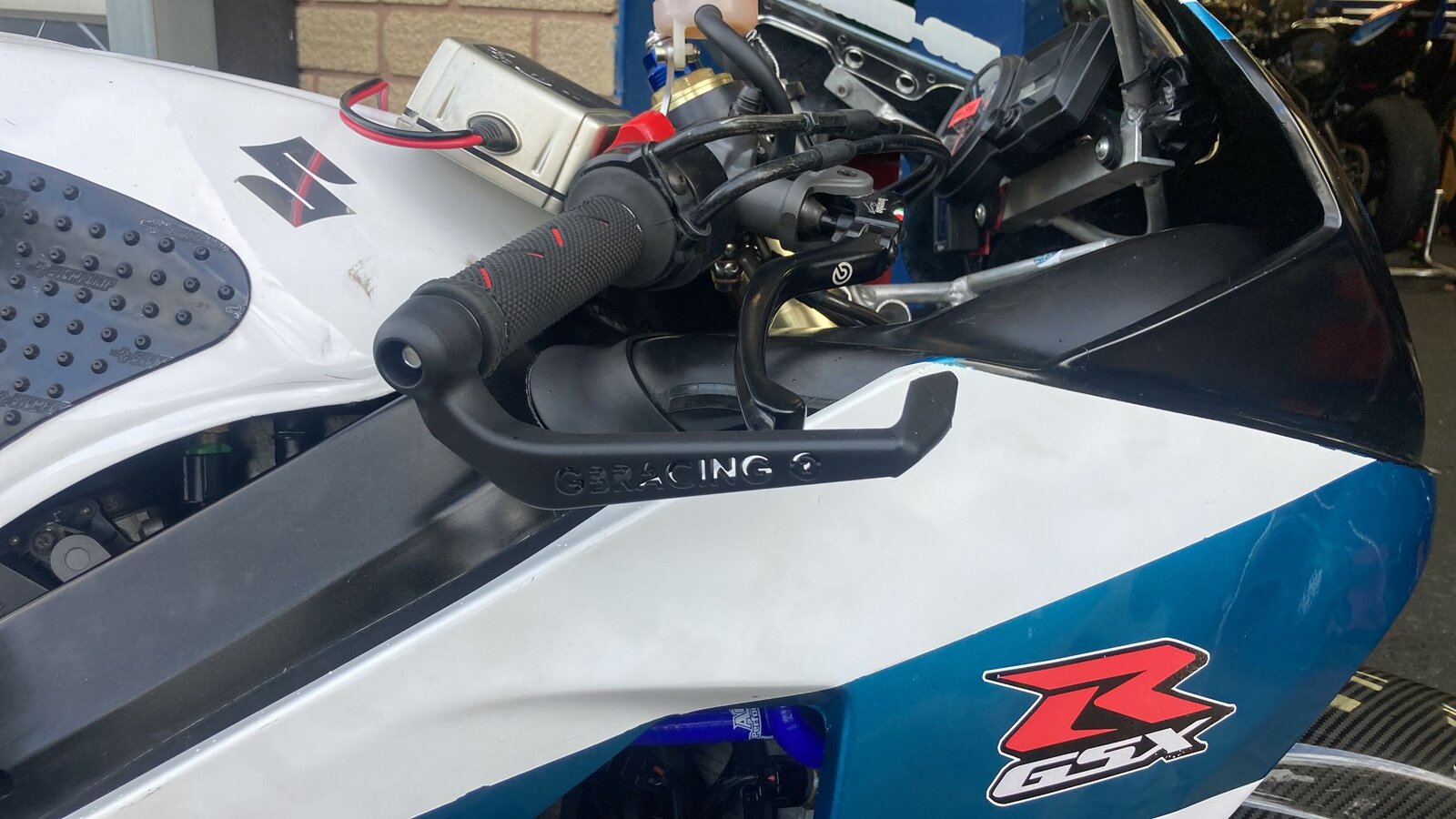

  19. I'm running a rcs master cylinder, twin lines, hel calipers, Sr brembo pads, hpk 320 discs on my gsxr track bike, fantastic set up.
