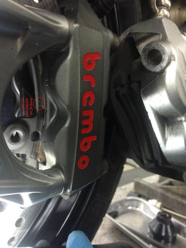

    This is what P&H just said to me:
    I have asked a second technician to look at the calliper and he is happy to fit- the area of concern would be the fact the brake pads do not cover the entire width of the disc so braking efficiency could differ to that you are used to, and the disc will wear unevenly. If you are happy then we can do this for you. I have added a photo so you can see the area of noncontact and highlighted so you can see.

  11. Right, so from that pic they have trial fitted it.

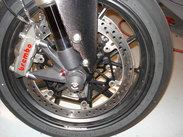

    From that pic ts not vastly different to the pic I posted above. I can tell you the braking improvement is outstanding. I've not compared actual pad area, but the M4 pads are longer and shallower.
    If you want to check further, what you need to see is the outside of the caliper, to see if the pads hang off the top of the disc. You can do this yourself with no tools, just slip it over the disk to the same depth as they have shown, then compare it to the other pic I posted.
