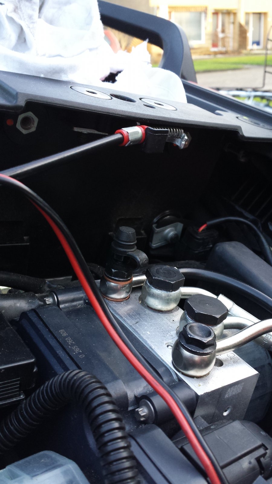

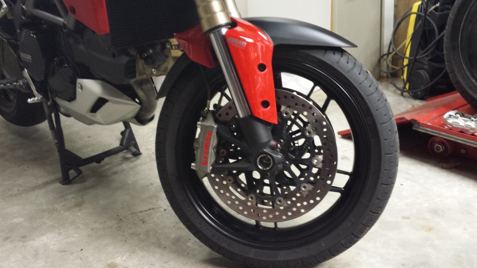

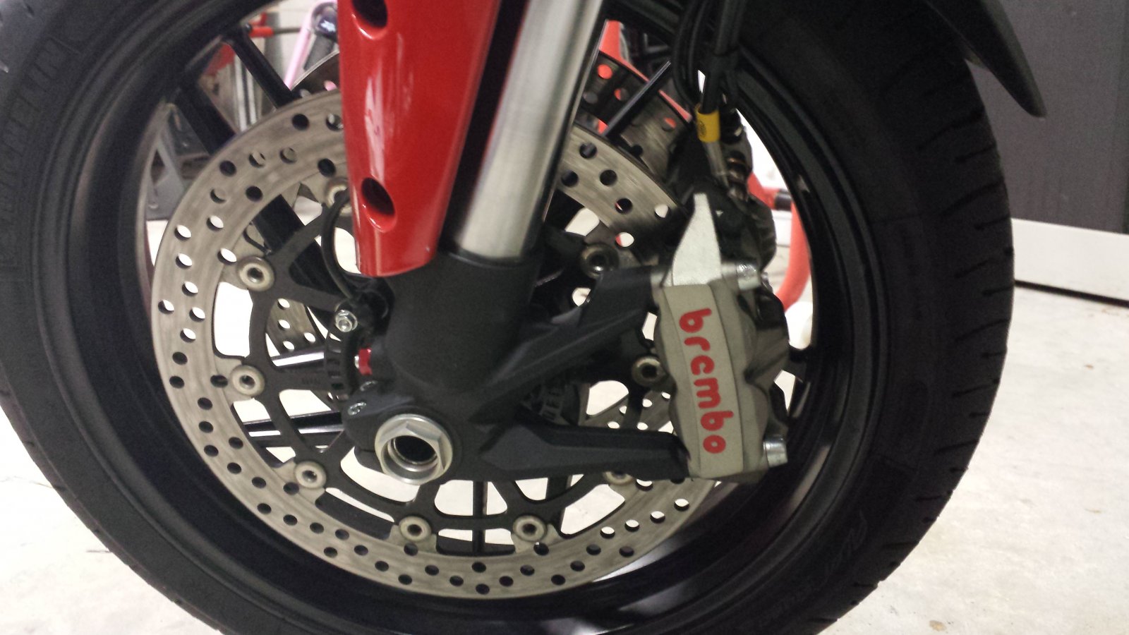

  4. I have fitted M4 monoblocks on my MTS. I have replaced both the brakelines. One 188 cm with 1 90 degree banjo and 1 with a 20 degree banjo. The sshort line has 2 20 degree banjo's. I have used one of the oem bleeders one the abs modulator.
    No spacers are needed. Braking and braking feel have improved significant.
    Fitting is a strait forward job. You have to remove the tank. Bleeding the system takes some time.

  14. Just wanted to update this thread on my new brakes, in a word.... Superb.
    I'm really pleased with how quickly they bite and the overall feel, really worth the effort.
