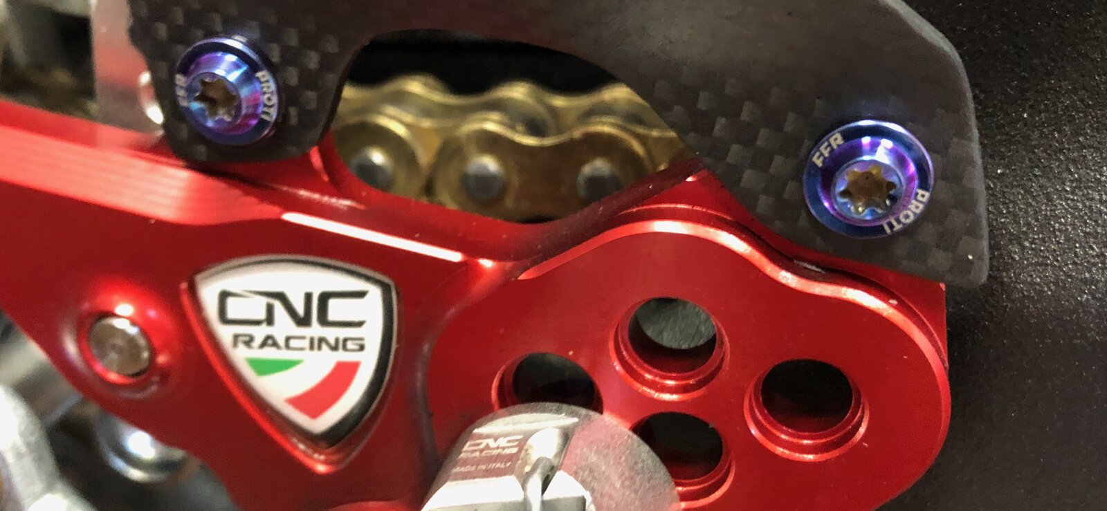

  10. Been using Probolt titanium for nearly 20 years with no problems, but recently using forged titanium bolts from ProTi in Taiwan. They have a tensile strength up to 1764MPa and available in 4 colours, they also look amazing!....but Very expensive!!

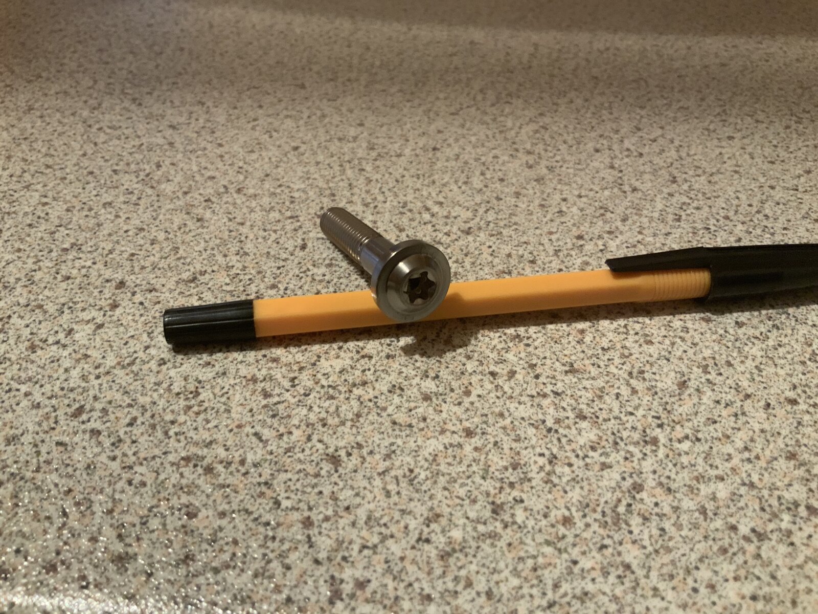

  11. Slightly old thread but thought I’d mention replacing my Brembo Calliper M8x1.25pitchx40mm bolts on my Monster 1000 with titanium TORX head bolts. Pretty much replace all my bolts for TORX head. Anyway as purchased have a head diameter of 15.9mm but the recessed holes can only accommodate 14mm and have a slight radii at the outer edges. Anyway bought 8 shouldered washer bolts and machined to size with a slight radii on the inside. As you can see T40 head with 25mm rolled thread as per original fasteners. Bolts as they arrived but with PRO and race Ti laser etched on the side. Would have love to have kept the words but not possible due to reduced diameter to fit my callipers. Logo removed with some wet and dry whilst turned in my lathe.
    948016DC-5C82-4273-A9CE-CBC19C315E06.jpeg No more rusting heads which always annoyed me.

  12. Not a fan of torx myself - ive always found the head too small in relation to the bolt diameter ( ive had lots fail )....but thats just me - stick to regular bolt or allen key head.
  13. Exact opposite for me.
