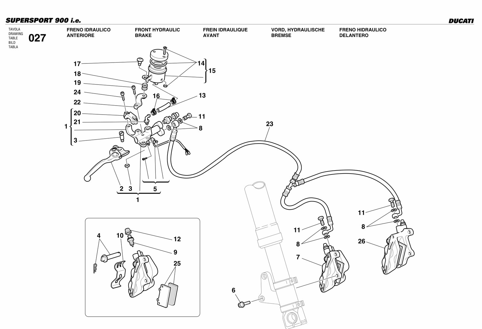

  6. I didn’t ask. If Brembo don’t do them how are Ducati going to source them? If you look at the official Ducati parts manual for my bike the front and rear callipers are listed as single items, no component parts listed at all.
