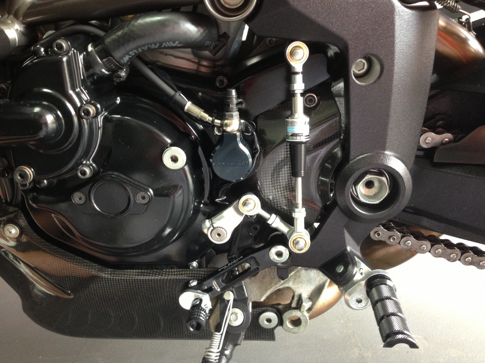

  17. Ive had a Translogic QS fitted for a couple of years now
    Fitted it myself, not to hard (but I can twirl a spanner) hardest bit was getting the adjustment rod dialled in for the best shift, had to cut the damper rod down slightly and run a die down the thread to give a little more adjustment required. Although mine is fitted in a slightly different position to DUC2 See pic
    The push or pull actuator wasn't available when I purchased mine, so I went for the pull actuator which suits the multi gearshift set up for me
    You can also alter the ignition kill time using the little electronics box of tricks to get it as quick or slow as you like
    But I must say its brilliant, not only for looning around with the sports bike crowd, but very nice when the mrs is on the back short shifting without shutting the throttle off stops all the front suspension diving and stops the occasional helmet crashing and the mrs thinks its a better ride too!!

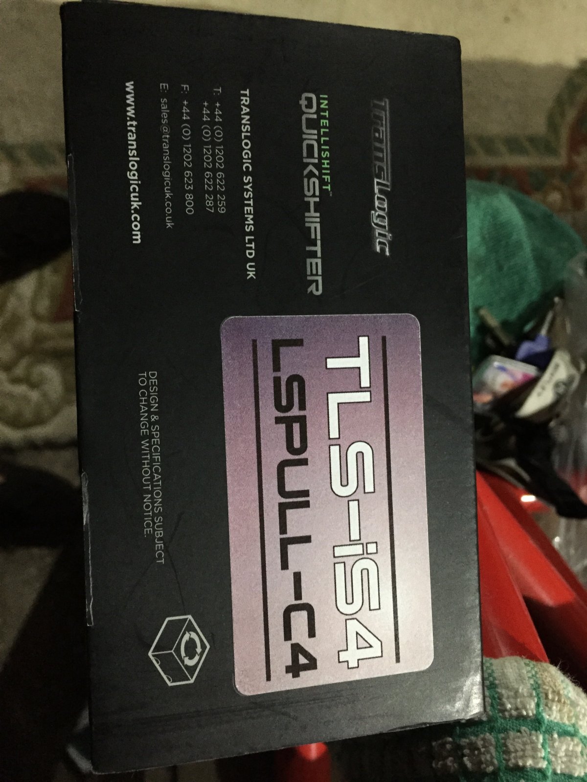

  18. Here's the Translogic Quickshifter part/model number from the side of the box.
  19. Nice install!
  20. Thank you. Oddly There is nothing of that P/N listed for the Ducati fitments that I can see on their site.
