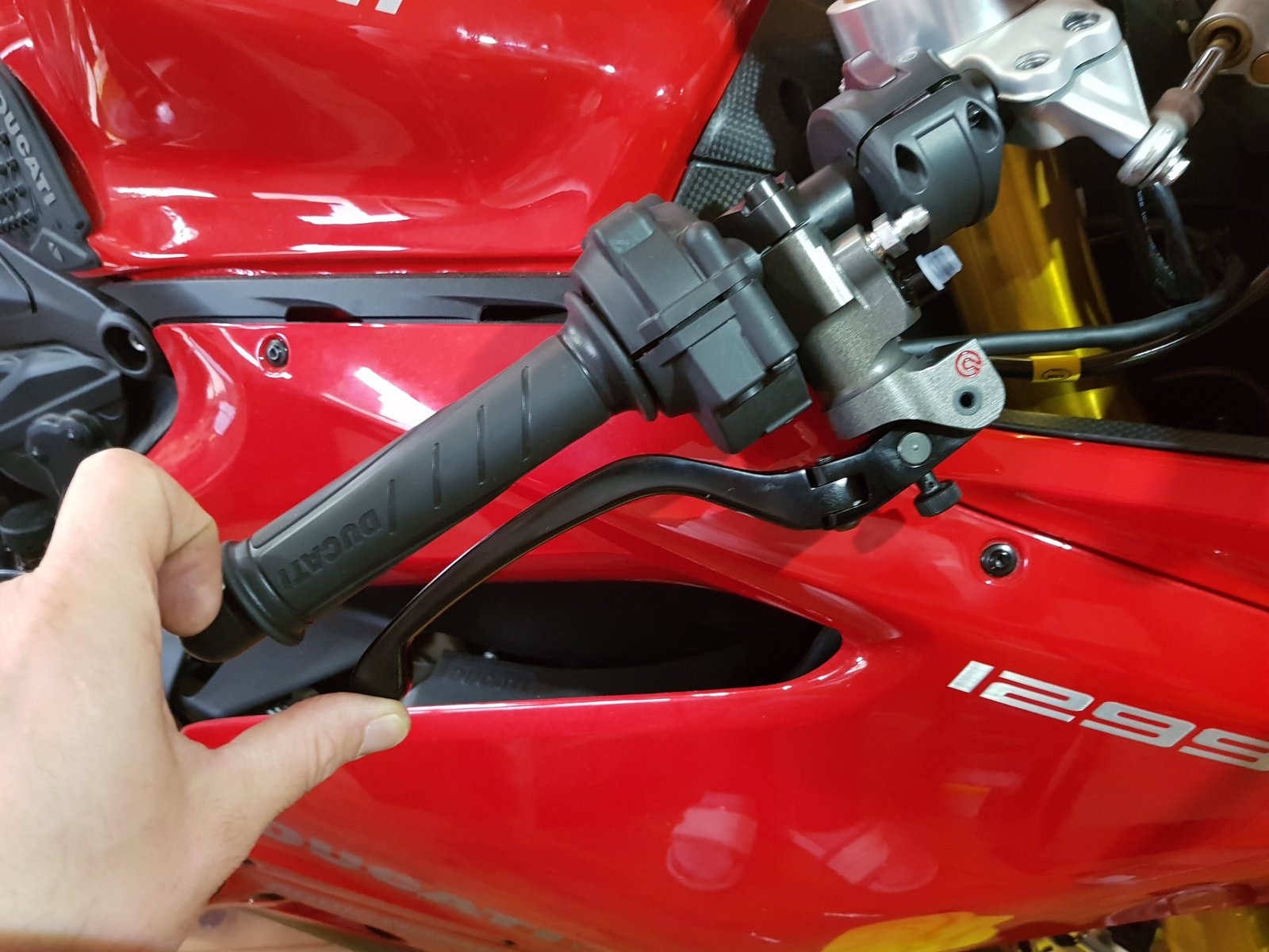

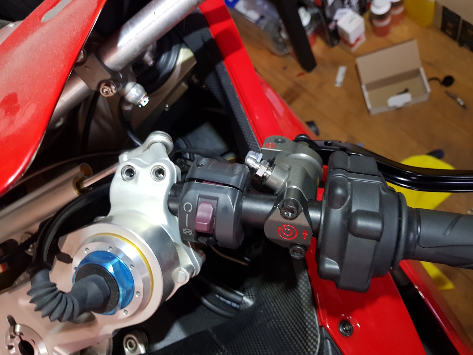

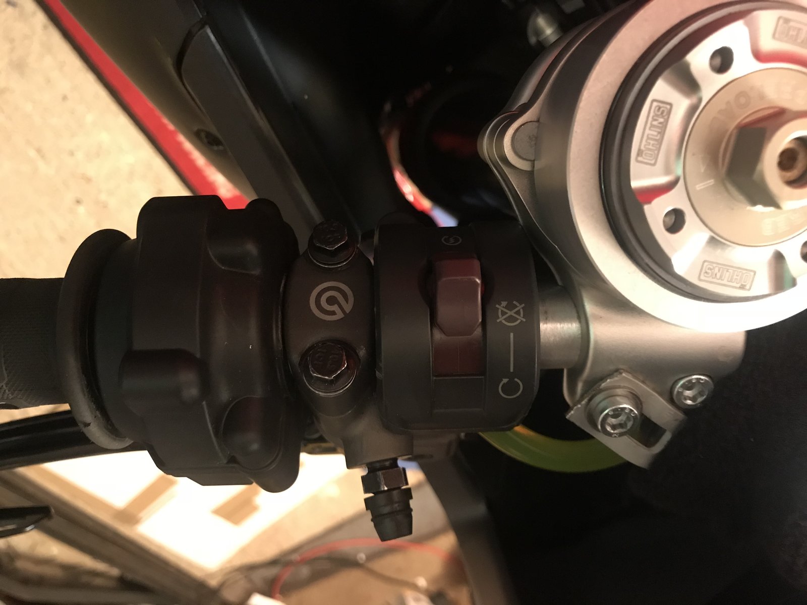

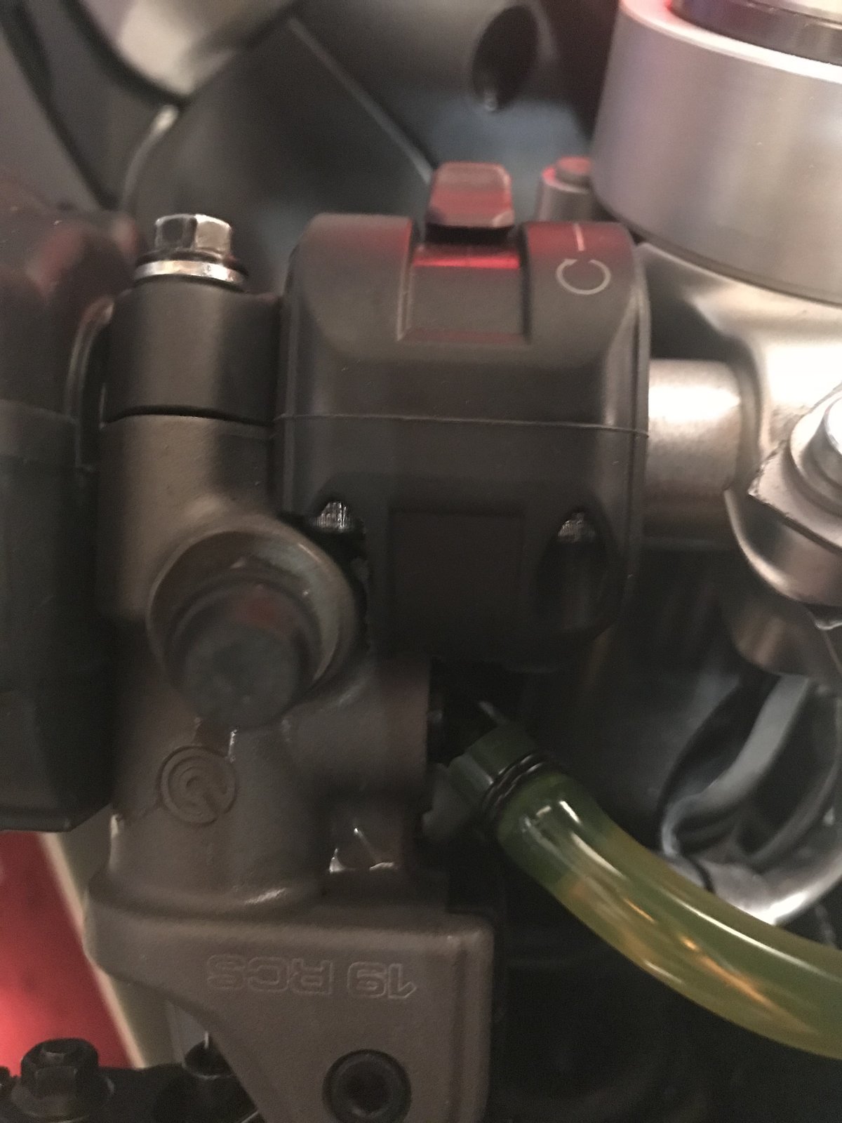

  2. I did have a think about the weather proof-ness of the mod and decided it wasn’t worth worrying about. All of the switch gubbins are on the top of the switch (the back part is basically a clamp). The existing switch doesn’t seal around the bar anyway (the pin stops it from spinning, and once you have removed that it spins freely on the bar, so water could have got into that gap anyway. It isn’t likely to get doused in water anyway because it is behind the fairing. The way I see it it just had a bit of a drain hole now. As an absolute last resort, I could put some of the electrical protection grease stuff I have left over from my jet ski, however I don’t see it being a problem if you cut out just enough.
  3. @Nelson hopefully these pictures show better what I have done (sorry, I couldn’t be bothered to take it apart!). So, leaving the piece that the 2 bolts go through, I cut a T shaped piece out. The top of the T is closest to the M/C main body, and the stubby little bottom leg of the T was an extra bit to go around the bit fed from the fluid reservoir...
    And this is why you can’t just slide the switch up the bar a bit....

  4. Cheers Ron - I was going to ask for some pics....:upyeah:
  5. You could do a neater job to get a better fit, but this was hours before the Portimao drop off and I was under pressure!!

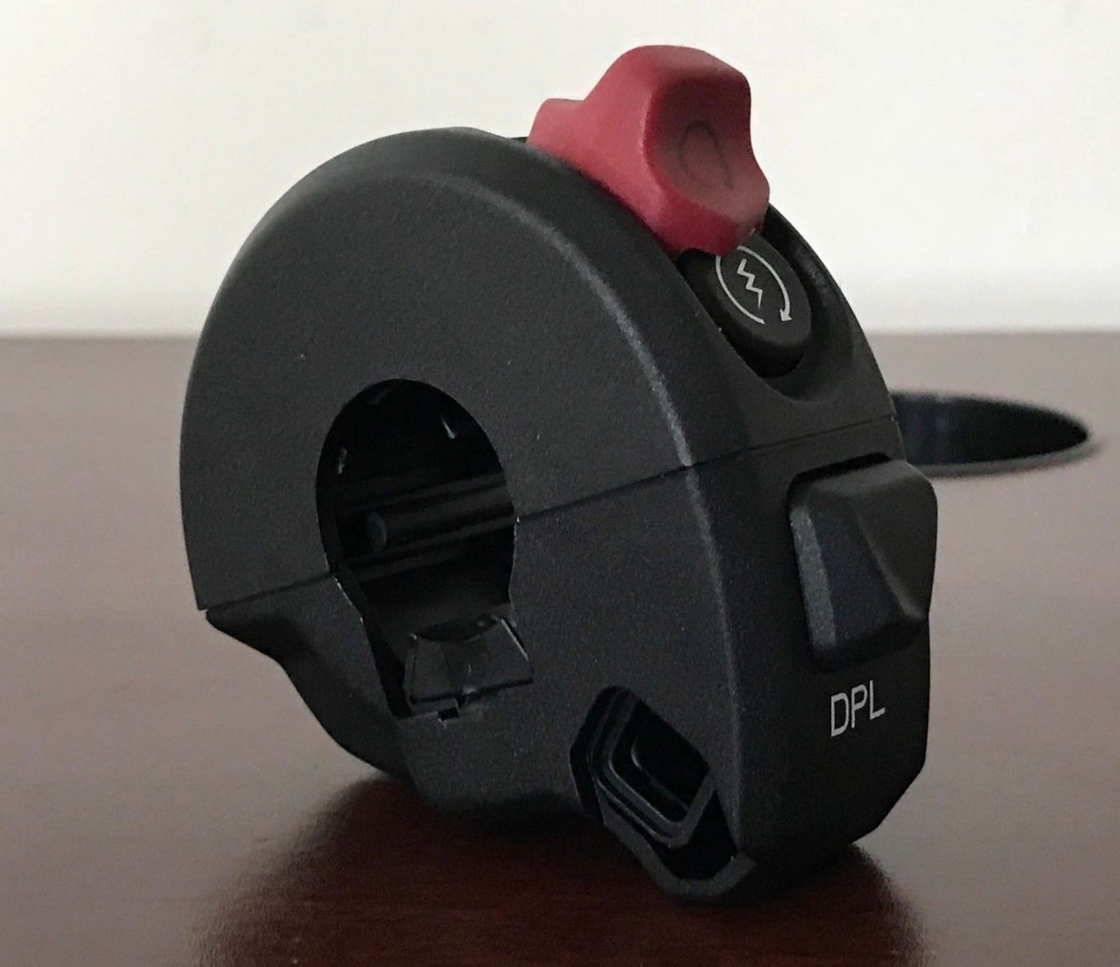

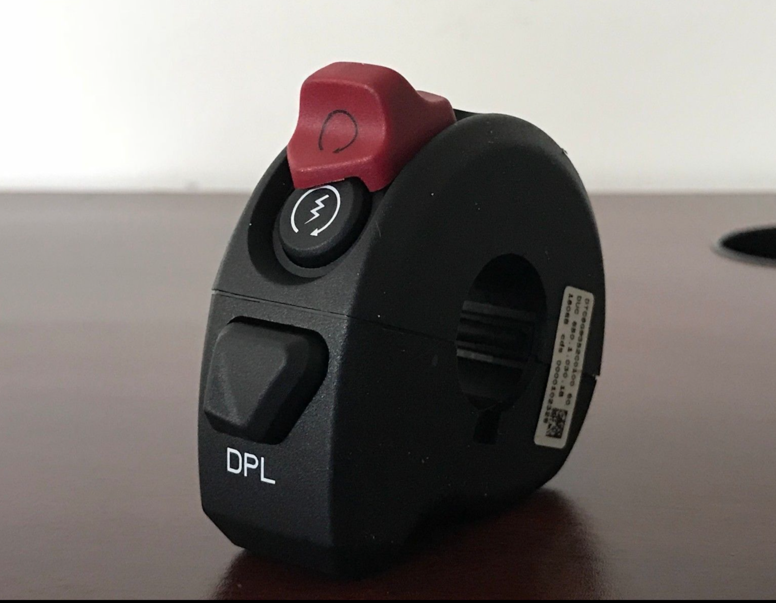

  6. Why no one try V4 switch?
    They are half the size of the 1299 and i guess the plug is the same.

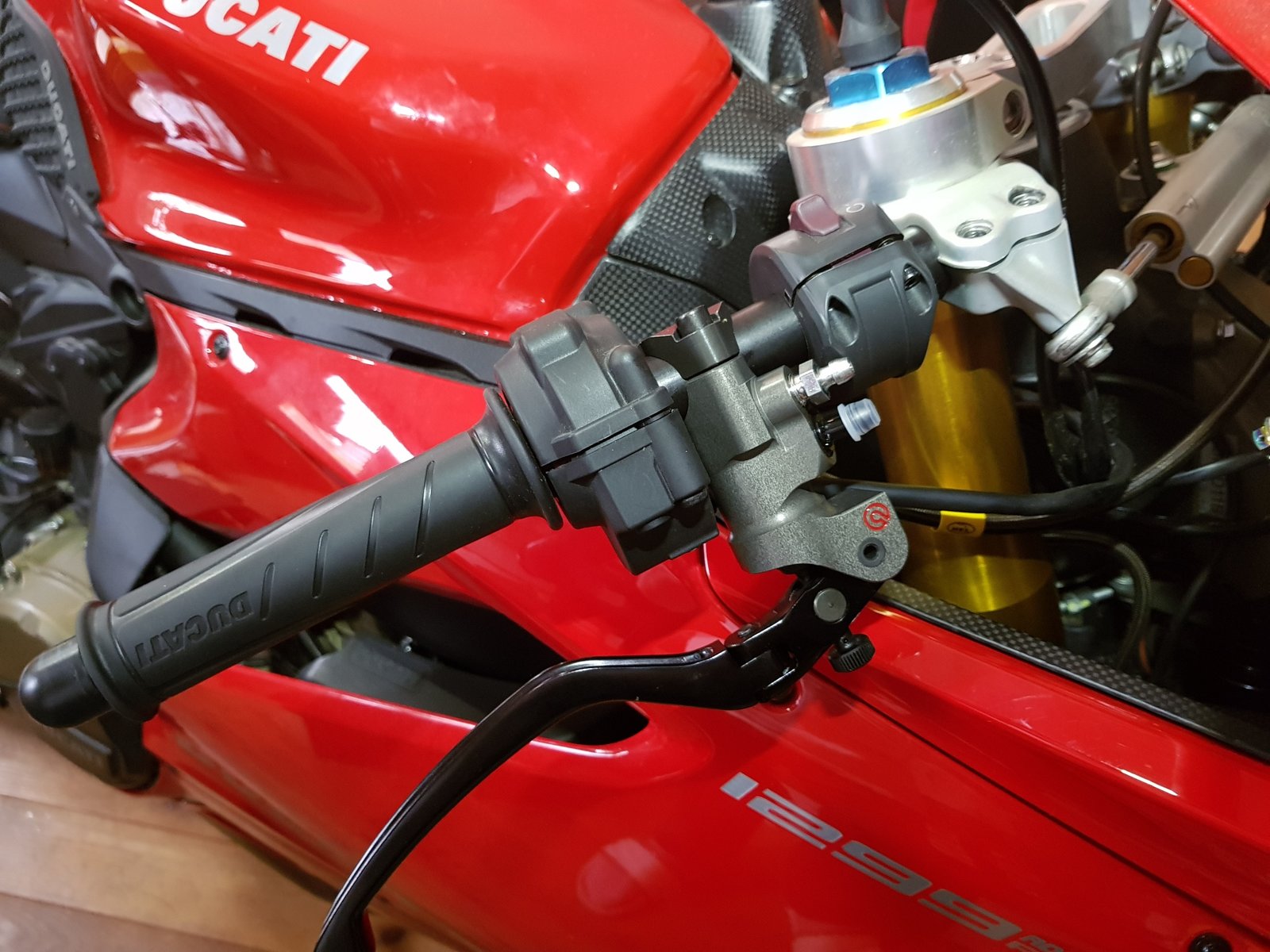

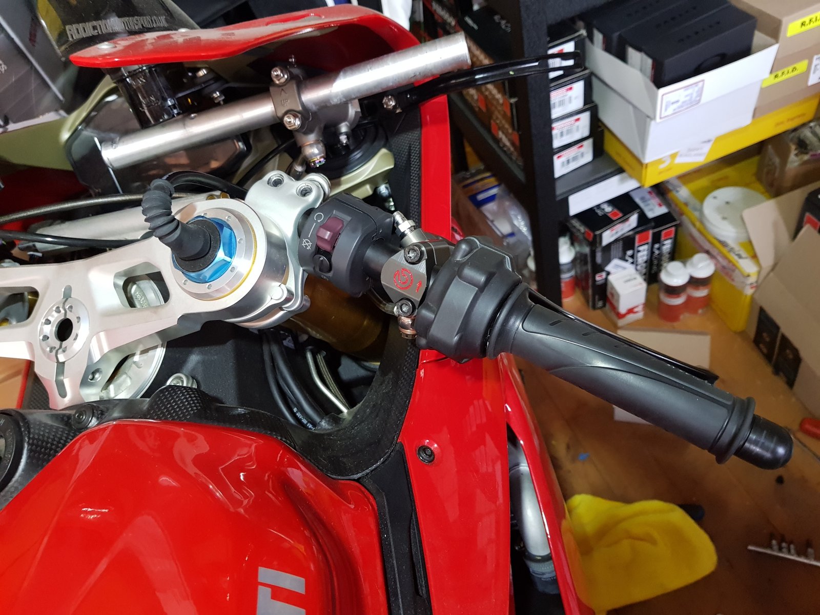

  7. Pic please?
  8. just found some on the net

  9. V4 switch has no cabling. The bikes loom plugs into the switch. May be doable, but you’ll need a connector for the switch and loom to make a patch lead up.

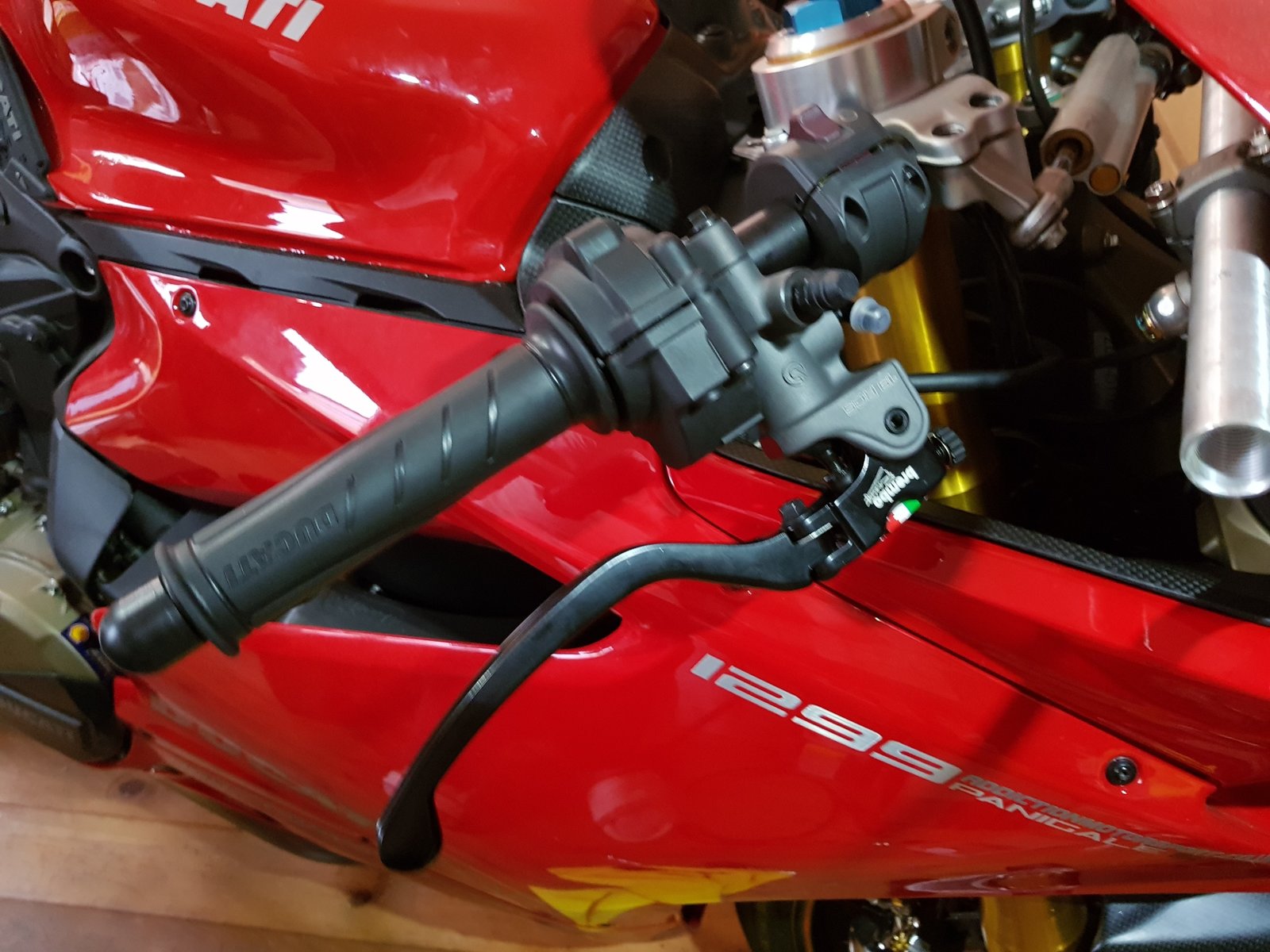

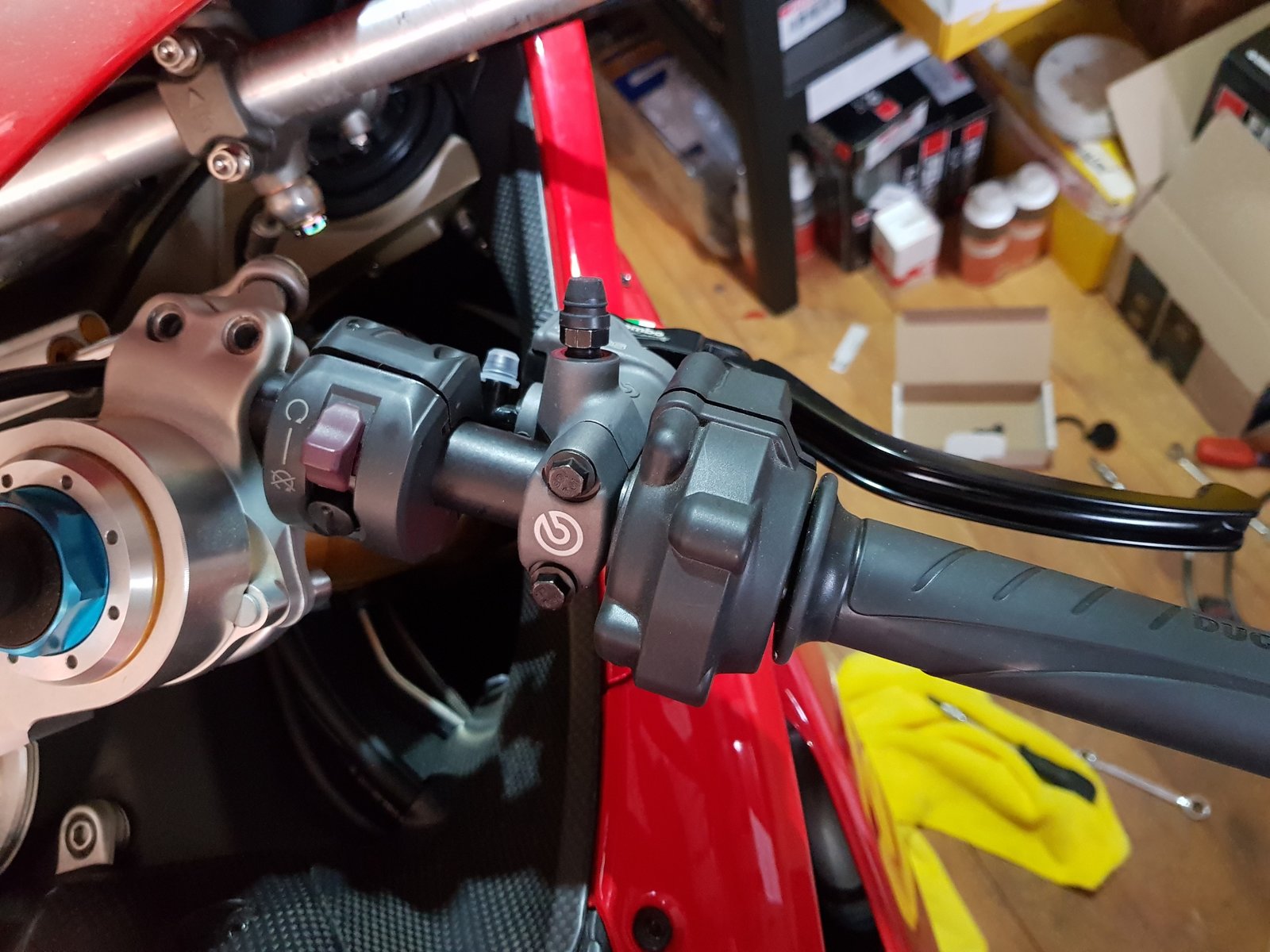

  13. I have just done a mockup fitment of the Brembo 19RCS and Brembo Billet Master Cylinder using longer handlebars.
    All looks tight but fit perfectly and movement is not restricted, i was a bit worry as the MC has a banjo connection on the bottom and i was thinking it will catch the fairing when on full turn, but there is still got 4-5mm clearance.
    Need to look fitment of the reservoir next as this might be a next challenge.
