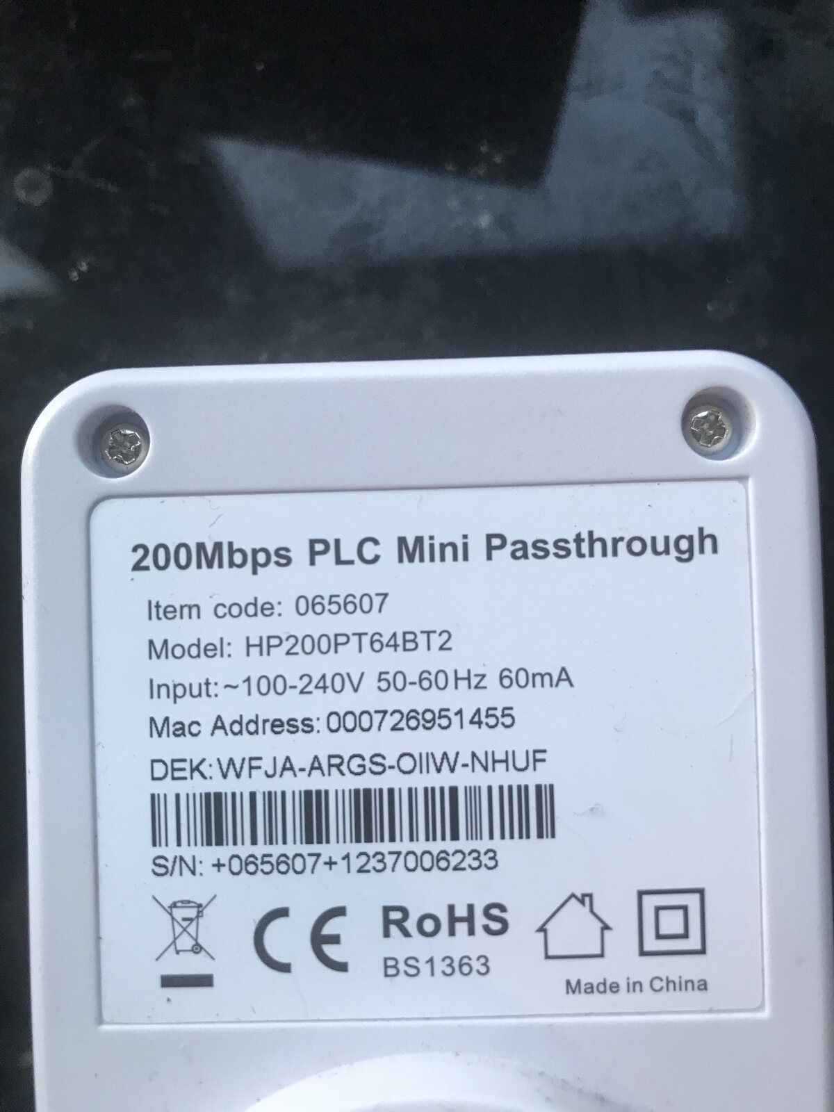

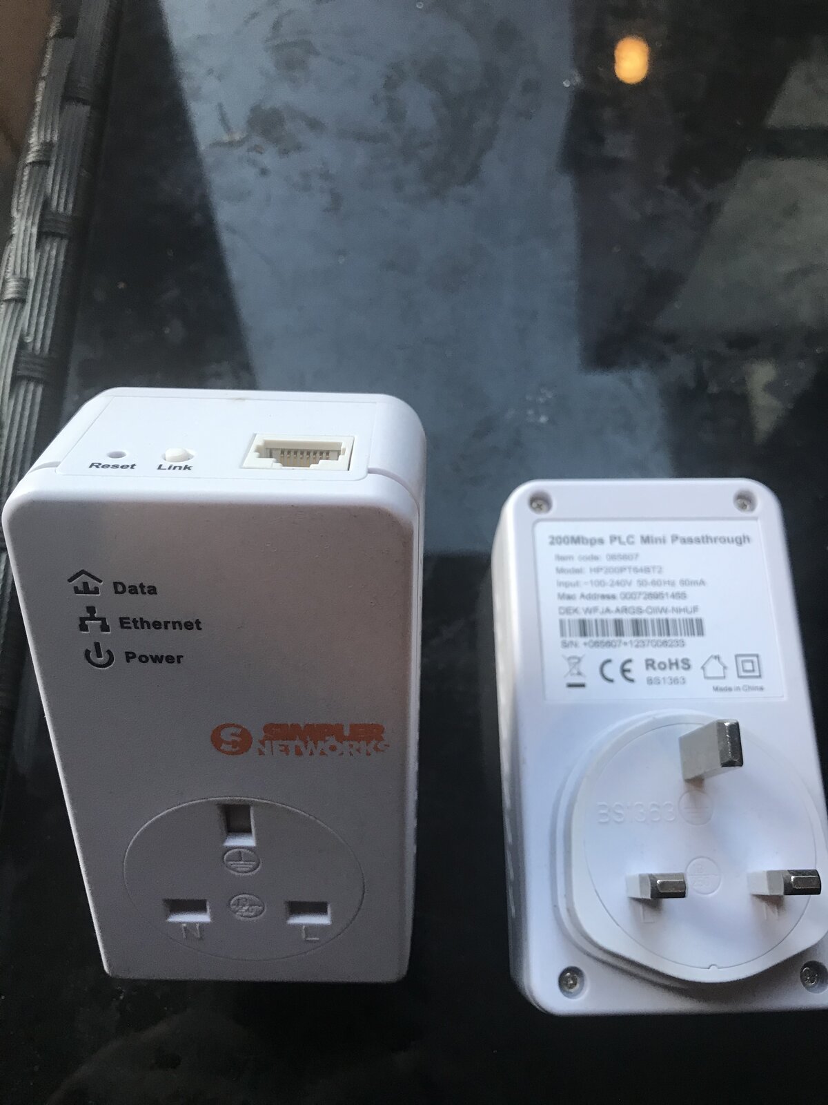

  15. AE970390-E5C9-4B52-9C0F-A48429E32EFB.jpeg AAE24FD5-434A-4596-B6B9-35408CE6A62C.jpeg
    These are the ones I have @Arquebus if you want to try them.

  17. Sorry, Alan,
    I have been a bit remiss in thanking you for the offer.
    So, OK.......How would I use these?
    How do they 'hook up' to the wifi signal my Smart Hub provides?
    I understand that I would locate them near to where my wifi is weak.
    AL

  19. No worries, it’s certainly not an ideal ‘plug and play’ solution.
    Basically plug one in near the BT hub and connect it with an Ethernet lead.
    Plug the other one in where you want WiFi signal, connect its Ethernet to your other hub and configure that as a ‘switch’ so it basically repeats your existing connection.
    Hopefully someone can give better details, I’m not good at explaining it.
