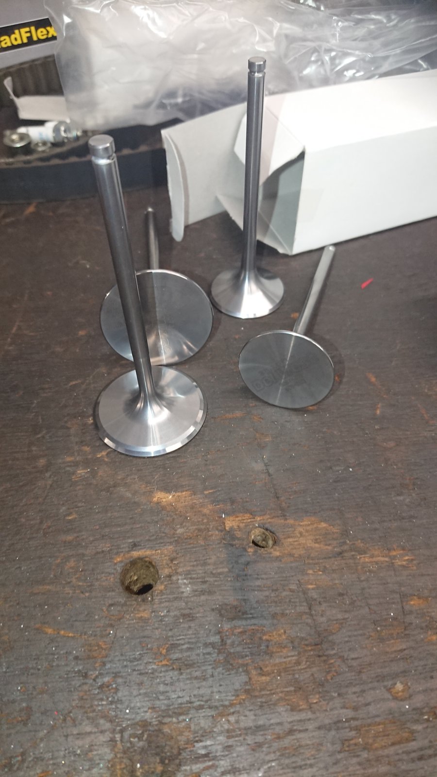

  6. Most of the parts are now in. After searching round I found new parts that dealers had in stock and selling off at a decent discount compared to the list price.... Might as well buy a full 70mm system for it!

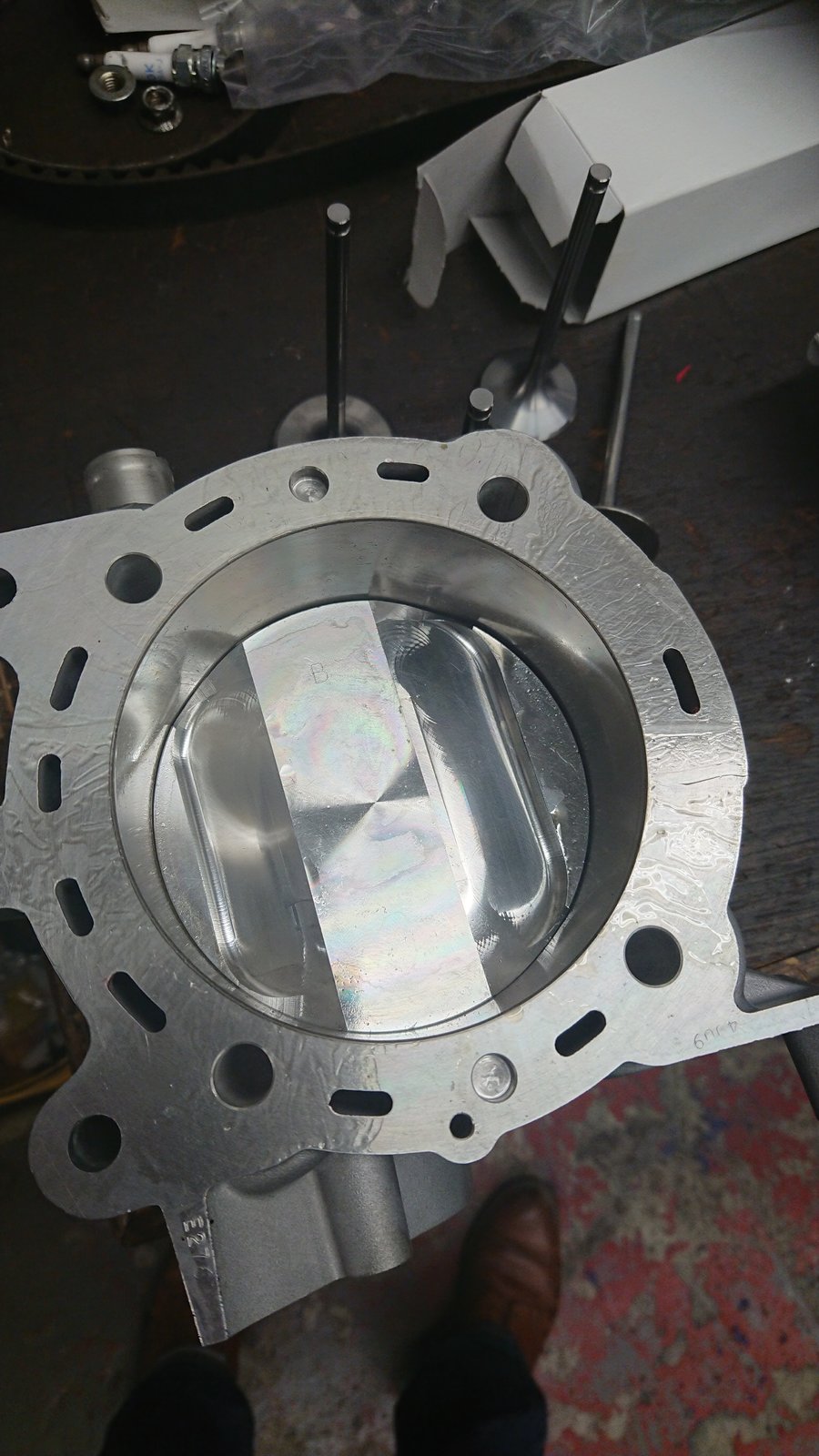

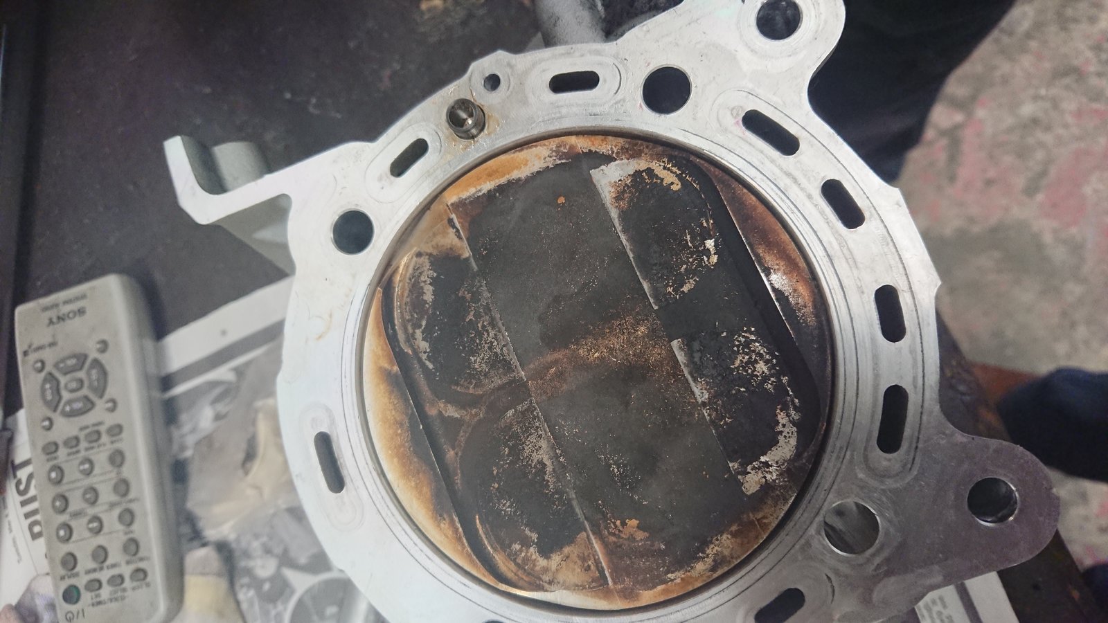

  7. Just wondered if you were going to check the bottom end out on that cylinder? Even though the damage to the original piston doesn't look to bad, that's what I thought when my engine did the same, which was then followed shortly after the work being done, by the crankpin bearing giving up (admittedly on track)
  8. Yes will be checking everything throughly... Just getting the parts I definately need as and when I find them.... Also means I don't have to pay for everything in one go!
  9. not took the opportunity for HC pistons then?
  10. No!... I've spent enough on engine repairs this year...it isn't going to be a track bike, and only an occasional use bike...
