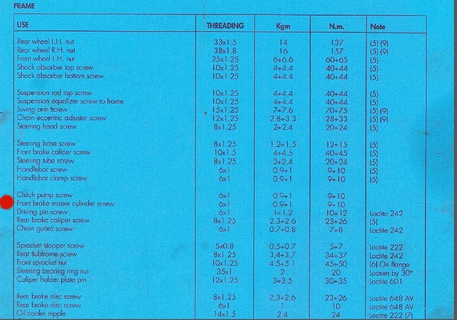

  5. Not being the only one makes me feel better.
  6. Relplace the hose Union bolt with one with bleed nipple.
  7. The number I have for the M6 bleed nipple is 4Nm... The 12Nm figure is for the bigger one used on the radial cylinders (M10 I think), rear calipers etc.
    If it's not leaking, the suggestion above regarding using a bleed banjo is a good one. Gives a better cylinder bleed as well.
  8. Dare you not utter his name....! :Nailbiting::Muted:
  9. From the Ducati 748-9*6 Service manual, which is what I use particularly when building a bike from scratch. They seem to be quoting 9 + or - 10 NM's for the torque figure.
    To do up nuts etc. with very low torque settings I use a Torque screwdriver which has a small square drive on the end and you set the torque by dialling it into the body of the driver. Doing it that way ensures that you are less likely to put too much pressure on a nut or bolt that has a very low setting. It comes supplied with a small tommy bar to ease up settings that the driver used only by the handle can't quite reach.
  10. Yep, the torque charts are sometimes a little wayward imo. For me, a stock M6 screw has a DIN standard of 9-10Nm. Other factors come into play when you change to hi tensile or fine pitch threads, but for my mind, a bleed nipple is also hollow so 10Nm for me is too high, never mind 12Nm. Overtighten and the taper seat gets damaged, and if that happens it'll leak.
    I've always tightened by hand, but that comes with time I guess.
    As an aside, I think the "front brake master cylinder screw" in the picture is relating to the clamp screws.
