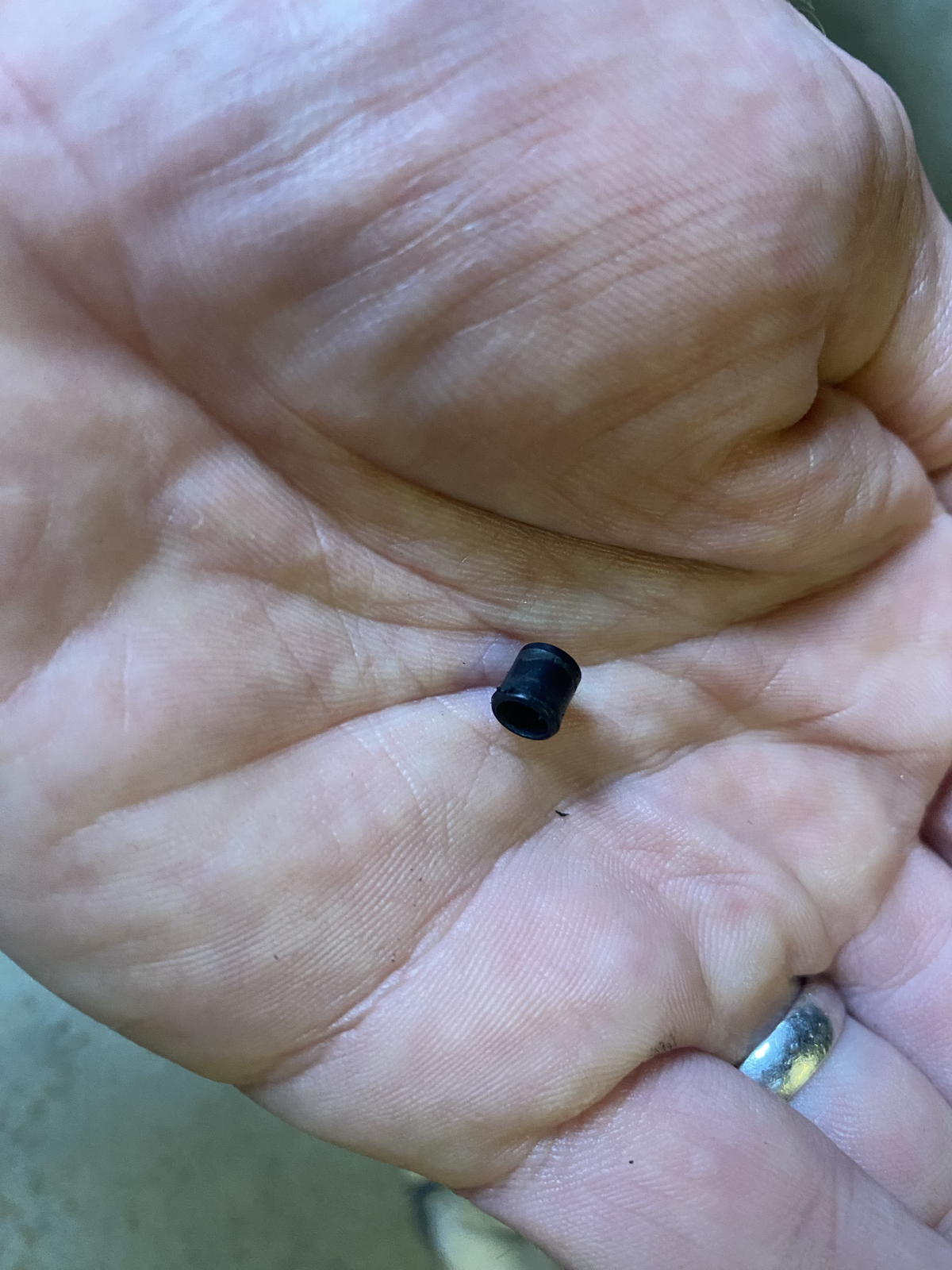

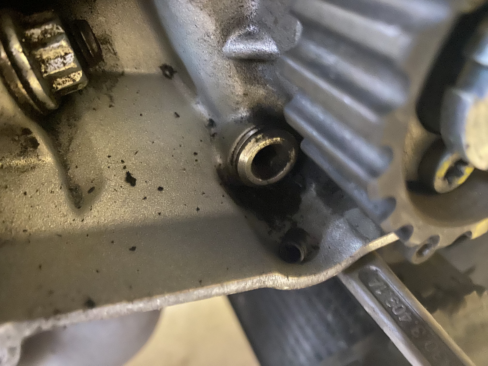

  7. Culprit identified. Little plastic thingy. No idea what it is or where it came from....
  8. Would that really cause a belt to snap?
  9. I spoke to Glenn at MotoV and he said even a small stone or bit of debris could cause it.
    I guess given the speeds involved and tension, a foreign object could do the damage.
  10. And Stu at Exact sent me this (after a lengthy response from the manufacturer which went into a lot of detail too)
    “Yeh, if it gets between the belt and the pulley / rollers at the tension they are it can only pierce / damage the belt as the steel won't give. It won't necessarily have caused an immediate failure and could have been running for a while with a rupture to the cords in the belt I guess.”
  11. Exactly this ^ (npi) the downside to enclosing a belt drive system so that no dust or debris can get in, is that nothing can get out either so (what looks like) this hard piece of plastic could have been bouncing around within the belt drive area for ages like a time bomb.
    It would be good to try and identify just what the plastic item is but low priority compared with fixing the engine.
  12. Could it be part of the belt drive cover? I remember on my 900SSie the belt covers were broken, If I remember correctly I saw something like this.... fitting stud? I am not native English so can't find the right word for it..

  16. A stone is hard, that looks like plastic or rubber, and I’d have thought the forces inside would have torn that to shreds before it damages a steel-laced belt
    • Disagree Disagree x 1
  17. send me a pm before Saturday , after that I am out for 2 weeks.
  18. yip, i've seen the evidence of a loose water pump bolt come through a timing belt when checking for a coolant leak. i cant tell you how many miles had been covered between the bolt coming out and inspection. the customer was v,lucky. that part does look like a locating dowel.
  19. Yes I thought it looked like some kind of locating pin. Where from though I have no idea!
  20. god knows. i guess it could even be an insert where the bolt goes through on some kind of sensor, throttle isolator, coil ect
