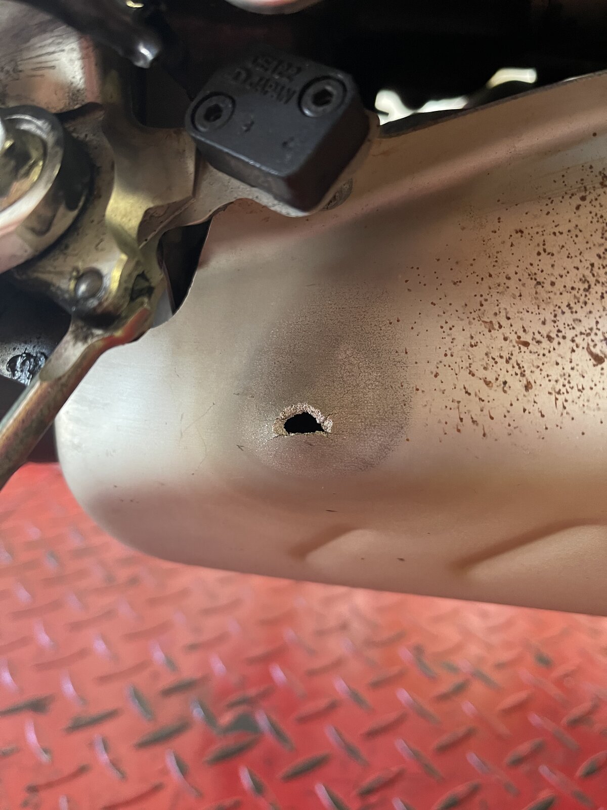

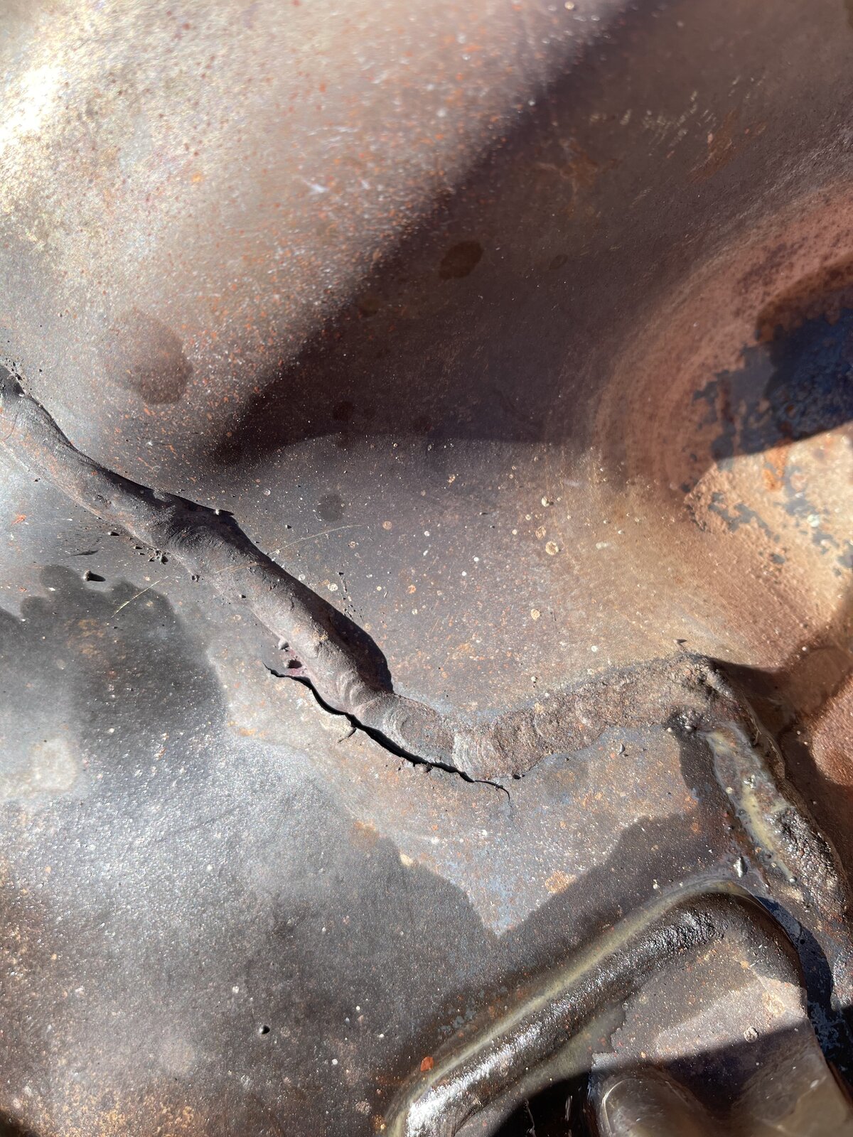

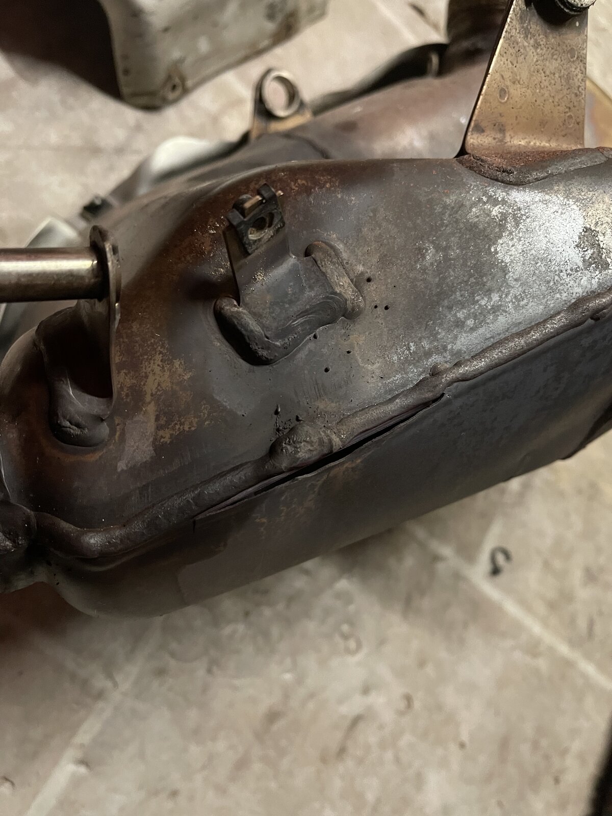

    my 2018 has 2 cracks on it and it’s blown a small chunk out of the outer shield. Not sure if I need to speak to Ducati or just get it welded and wait for it to explode again.

  5. Definitely speak to Ducati in the first instance. There is no way this should happen, its either a design or manufacturing defect.
    Your could be out of warranty now (depending when you bought it and if you extended or not) but they should still cover this on good will. Worst case you have to pay for the labour but I would push for it all.
    Good luck !
  6. Can’t just re weld that mate. It has cracked around the welds as it was welded quickly with too much heat. You could get it patched over. Give us a shout if you need it sorting.

  13. spoke to Ducati Leeds, not interested at all. Never are you be honest. Never seen or heard of a V4 exhaust failing apparently (despite the information all over the internet) sadly the bike is 2 months out of warranty. @nelly has offered to have a look into it for me but due to the Thursday deadline I’ve opted to try and repair it and find another stock cat somewhere that no one wants.
    I have a good mate whose very handy with his welding kit (he uses it to make some incredible GeeTech paddock stands when he’s not repairing things for me :joy:) so left it with him to work his magic on.
    fingers crossed should be sorted for Thursday at Donny.
    considered getting a slip on which wouldn’t be too much hassle to swap back to the stock can as it’s a straight forward swap in the garage. But nothing out there for a decent price at the minute.

    Stress crack right around the weld...

  20. I am still amazed at the sh*te welding standards on the OEM exhaust system of the V4. The 1199/1299 were not much better. Most of these look like stress fractures close if not next to the weld line. Seems as if mounting positions and/or bracket locations might contribute to failures, when subjected temperature cycling, movement and vibration.
