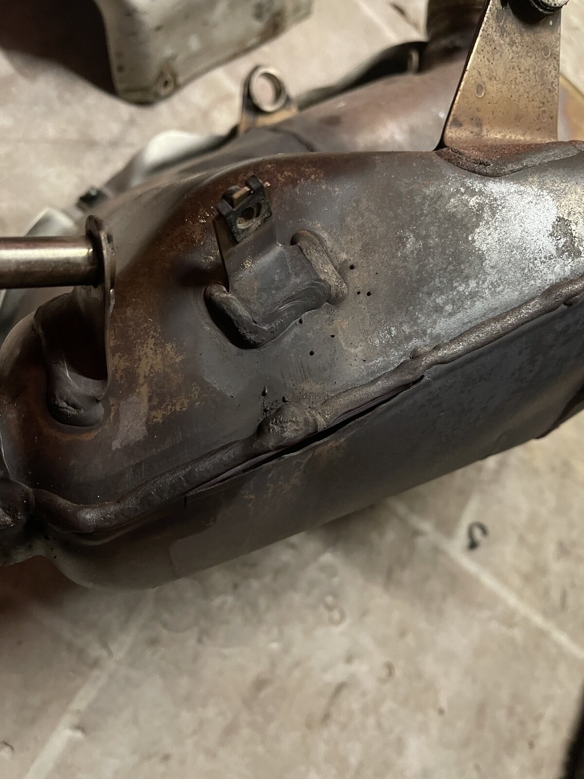

V4 Broken Exhaust
Discussion in 'Panigale' started by Dukepaul, Dec 12, 2018.
  1. I’d go the legal route using Consumer Rights Act. As the part isn’t fit for purpose.
    Take them to court. That part is utter crap to fail like that.

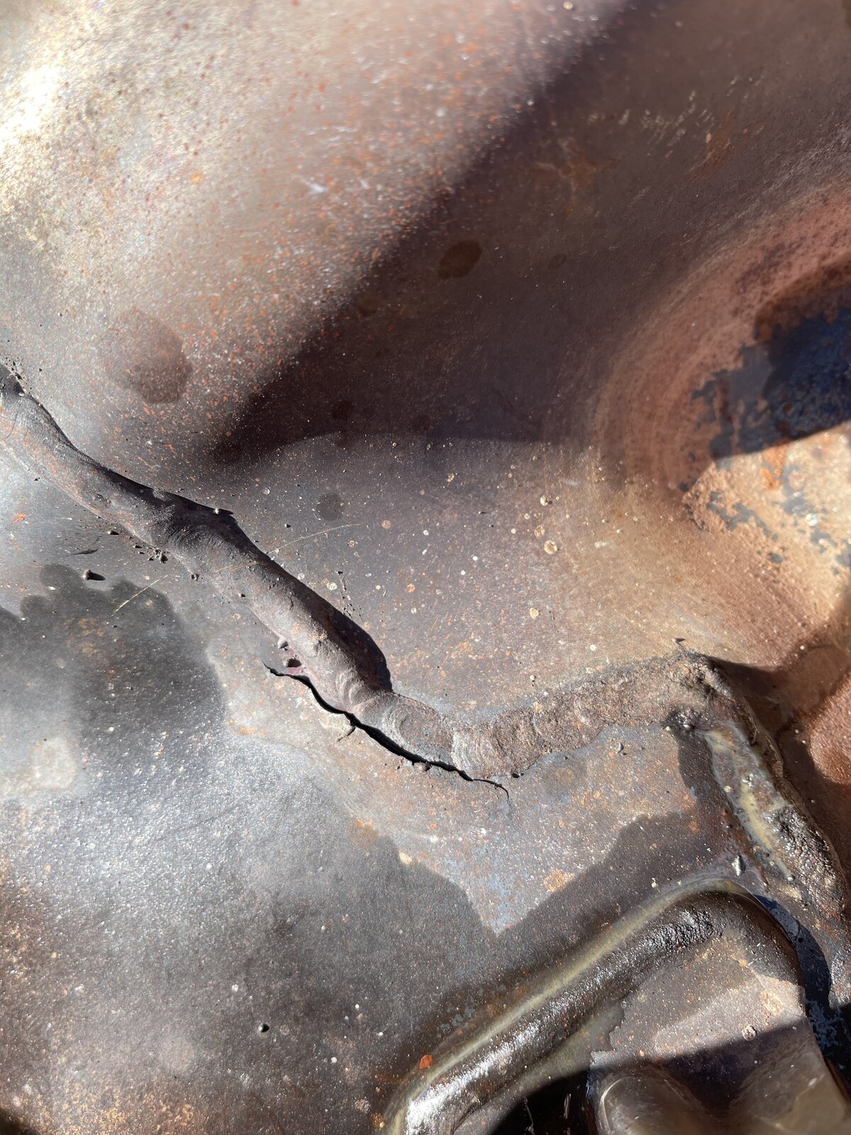

    It’s also difficult to weld and a step up in skill level to work with, not a run of the mill material. If you put too much heat in when welding you burn out the chrome and waste the point of the material.
  3. Yep. Typically the fractures are in the heat affected zone for the parent material. They will all be robot welded (I would assume) but probably too much heat affecting the hardness of the material making it more prone to cracking, especially with the heat cycles and movement as you say.
    It seems crazy the hoops we have to jump through as a small fab shop but then see fundamental errors with supposed ‘proper’ companies. I see it day in and out with shoddy welding on CE certified lifting equipment, it’s terrifying that there could be huge accidents even though things have been passed as safe.

  12. Hi,
    sorry for the late reply but I haven't been on here for ages. Anyway to answer your question yes I did get it sorted Ducati replace it under warranty and for your info' it was Nelly who did the work :upyeah:
