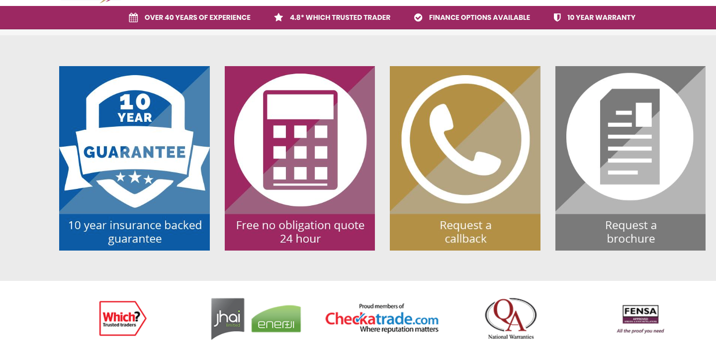

  8. Yes they appear to be Fensa registered and there insurance backed warranty is with QA, if you have no joy with the company then a call to Fensa should help things along, there are guidelines that the fitting company have to adhere to, lintels , fire escapes, toughened glass to name a few.
