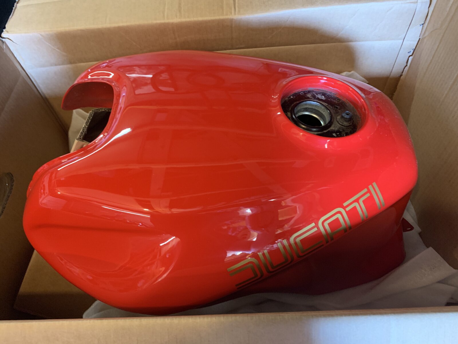

  2. Found and bought another tank, it’s an annoying expense but also part of owning old bikes I suppose!
    The rest of the parts are with the painter, I’ll drop off the tank when it gets here along with the stickers.
    The new left side exhaust and baffles are also on the way.
    At this rate I should have it ready to mot in a couple of weeks!

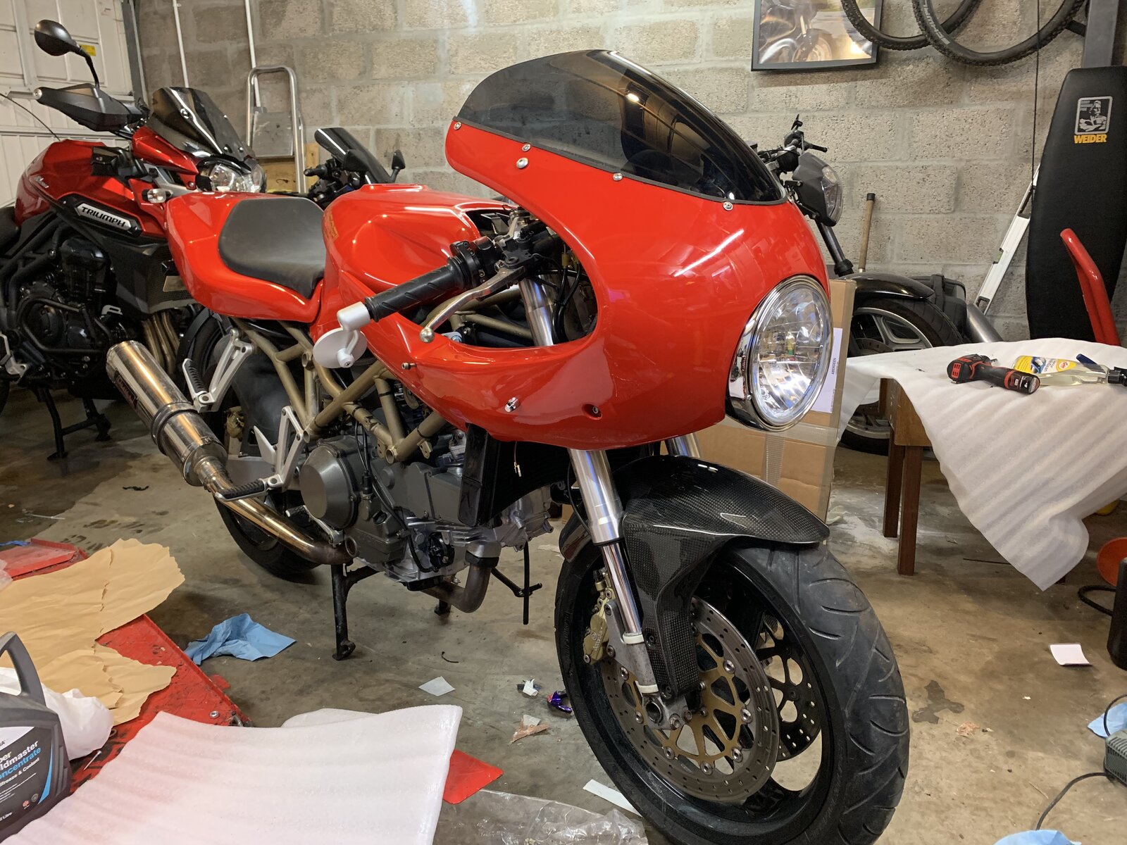

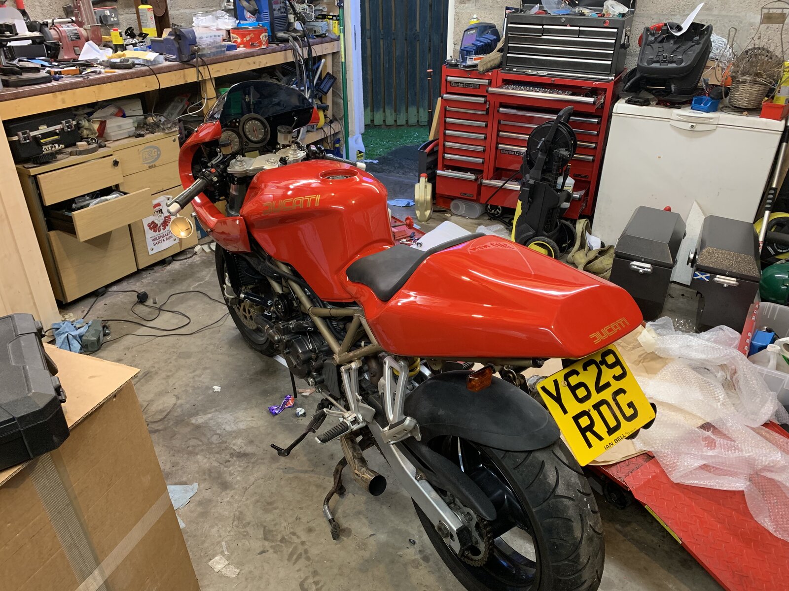

    I took a couple of pictures once the bodywork was on the bike though, excuse the carnage in the garage I was way too excited to tidy up!
    5E2BEF24-9DD1-4CA9-AD55-BA583B499571.jpeg 155D16B1-4144-4B90-B933-71A9C9E87753.jpeg B6E47187-CF80-4C90-9DA8-FD89A8DB41B7.jpeg

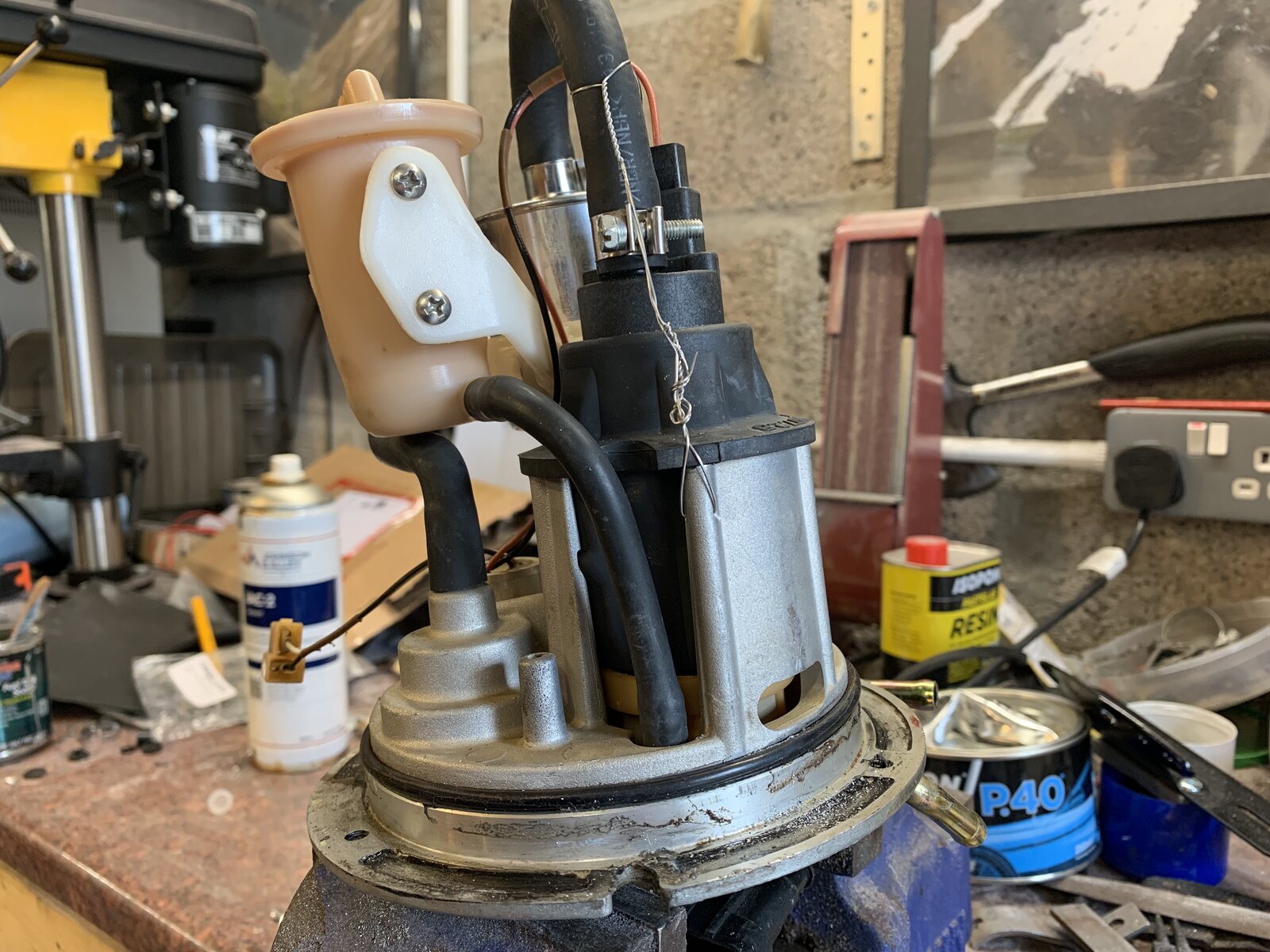

    I changed the classic fuel filter (2006!) and hoses, I’ve seen a few people having issues with the hose popping off the pump and a couple of recommendations to lock wire it. I did it again later on because I didn’t like the crap first attempt. Even though no-one else will ever see it!
    The stuff that came out of the filter was beige.
    I’ll cut it in half if I have time.
  14. With such shocking lock wiring I can only assume you are ex-RAF :eek:
    Were the hoses perished?
  15. The hoses were perfect to be honest, but I changed them while I was in the there any way.
    My lockwiring skills (learned on the day) are bad, but I’m a picky kind of fella.
